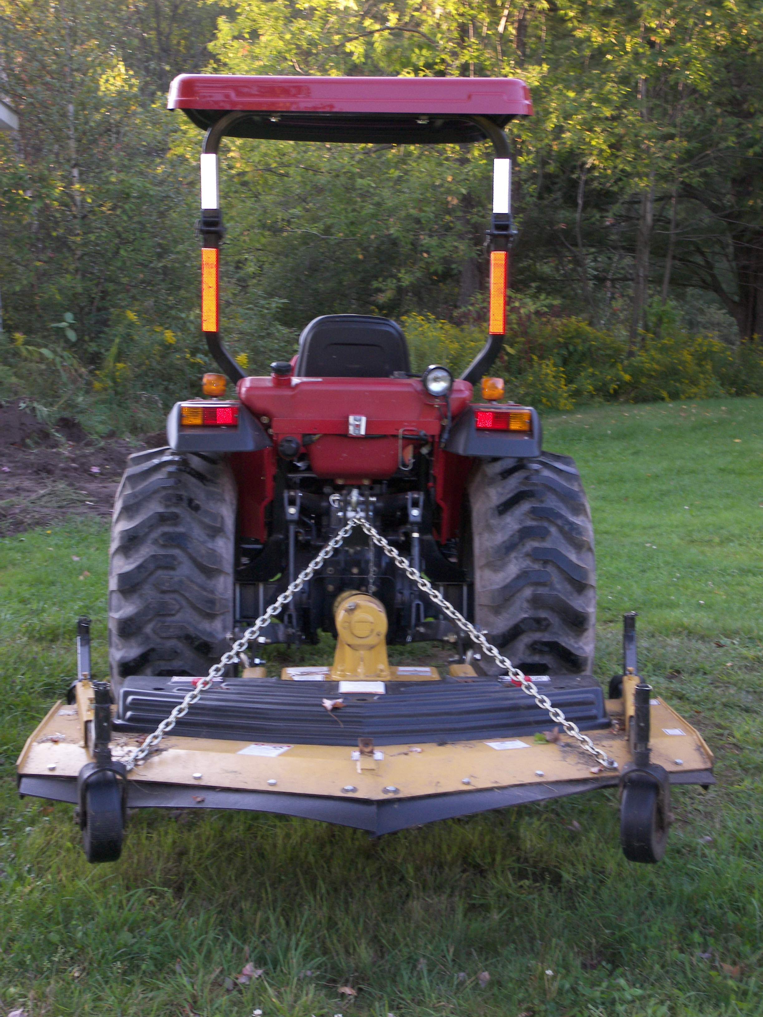

Well i have a KK 72" RD finish mower. its mowed about 5000 acres now and i an ready to put it into service for another year. This mower has been a rock solid machine for me with no problems to speak of. I have it blocked up in my shop and going to change the bushings on the wheels. The wheels have grease fittings and were greased reqularly, but i mow rain or shine and water and mud did their job. it will be a cheap fix. I still have the original belt and same blades too! I am sold on my KK. the only thing i did change is i added 2 rear pickup chains because the single chain rubbed on the gearbox. Also the spindles are greased from the top without removing the guard!
I guess the 3 best points about KK is #1, the price and #2 is the wobble hitch. #3, is the way it mows. when your done mowing the field actually looks striped! It does a nice job. I would definately buy another :thumbsup: . . .John
