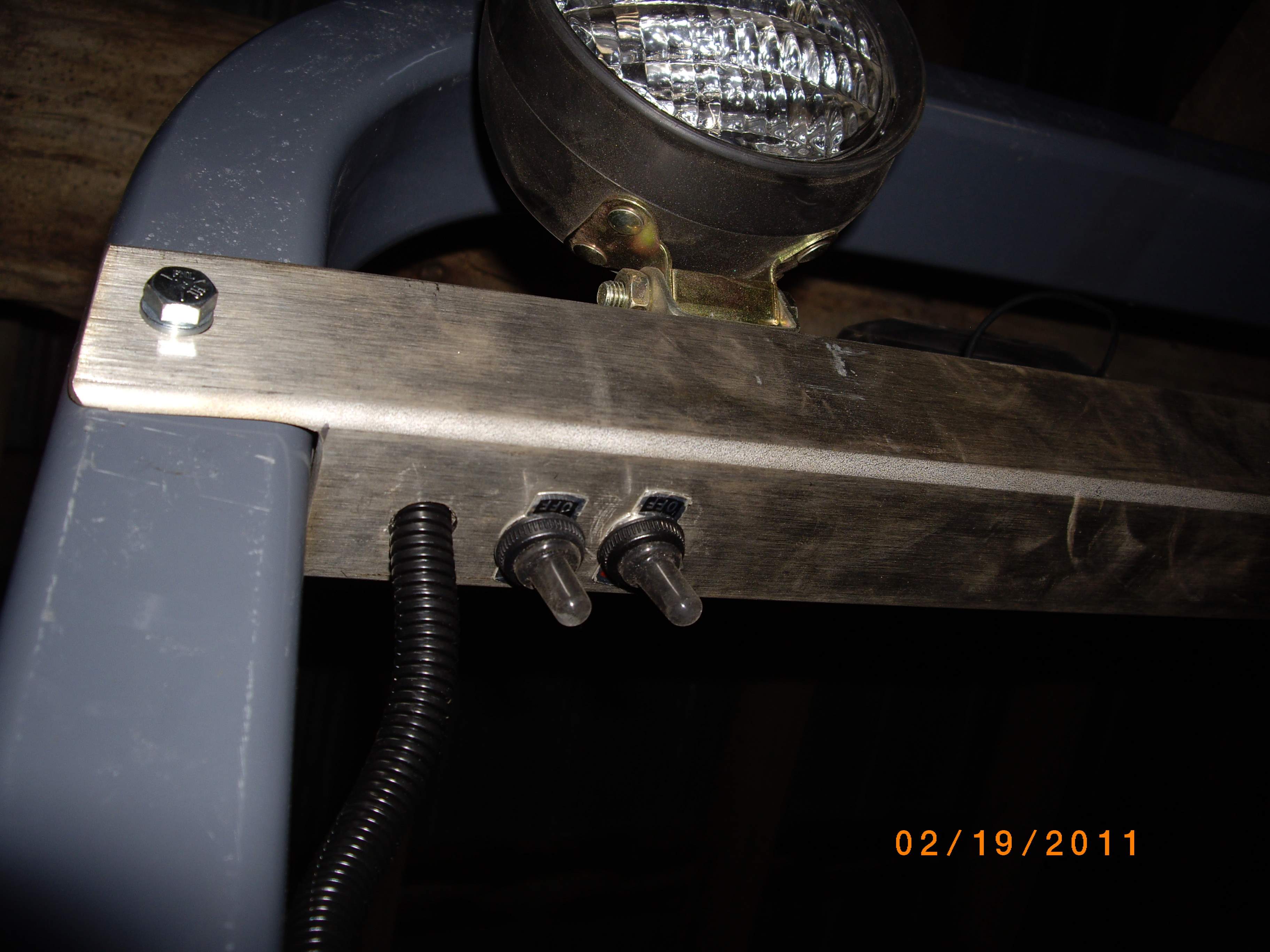

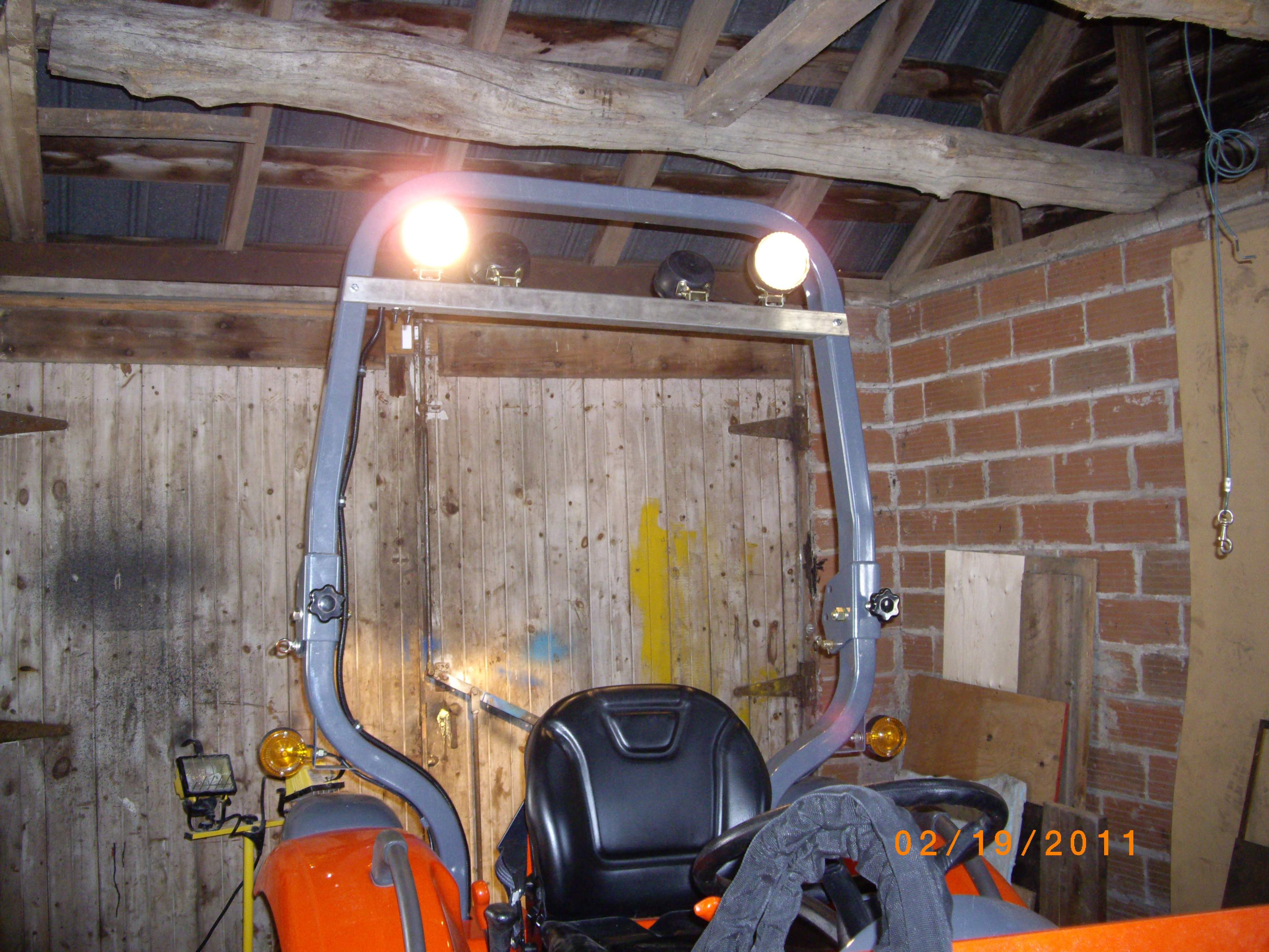

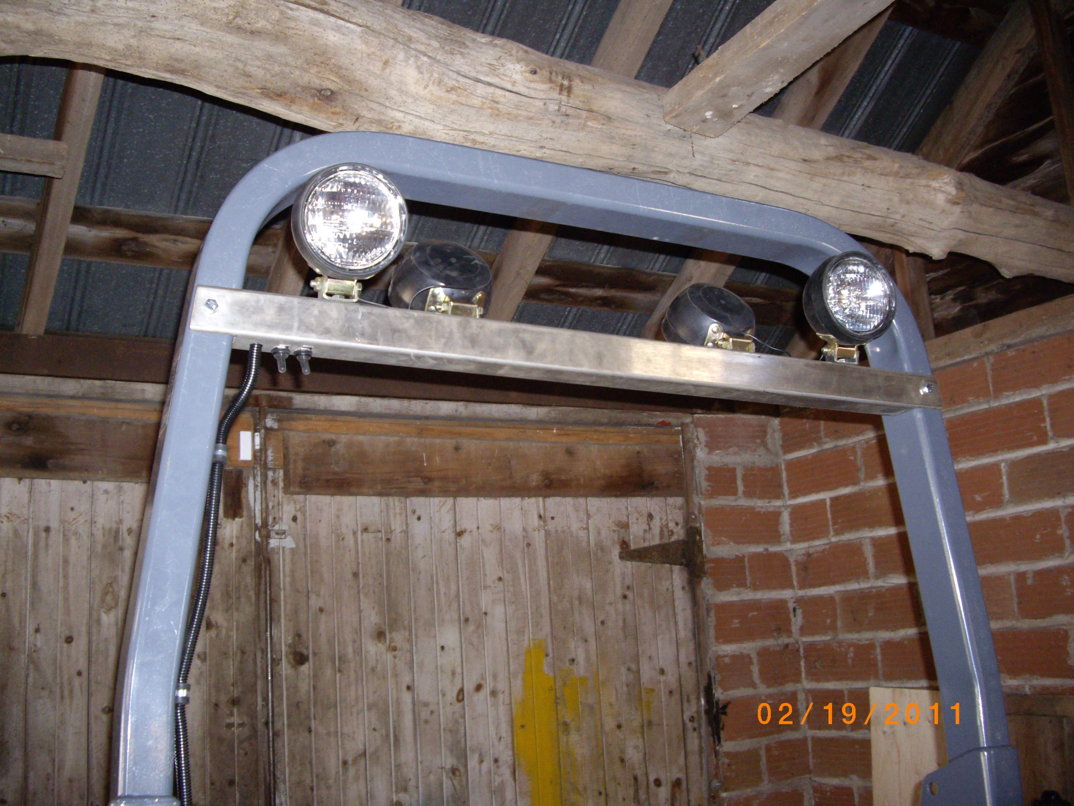

I added four halogen lights to my ROPS. I posted pictures in another thread.
Two of the lights face front and the other two to the rear. I used two seperate switches for the lights.
I just used some U bolts and flat aluminum strips to mount the lights. Simple installation.

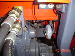

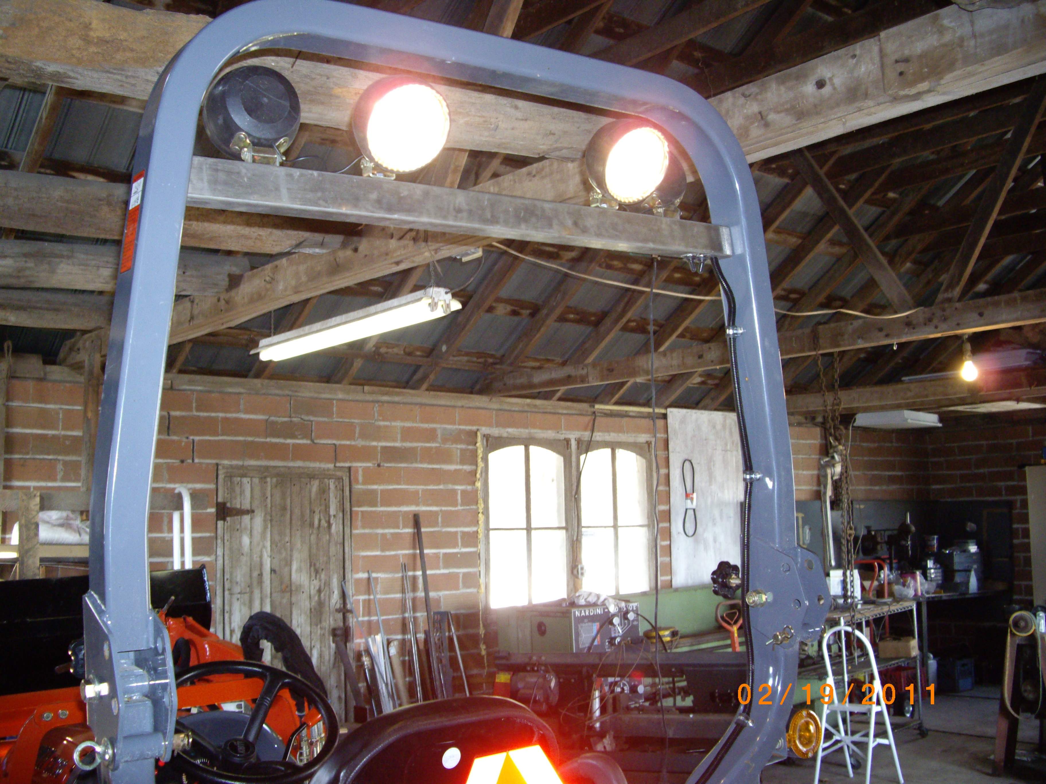

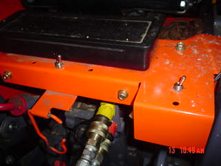

Added 3 lights in addition to the one the dealer installed. There is an outlet plug under the right rear seat area (looking forward) that is suitable for extra lights, see pic # 2 & 4. Put my lights on chrome toggle switches, one is behind the black tool box and the other to the right of that, see pic #3.

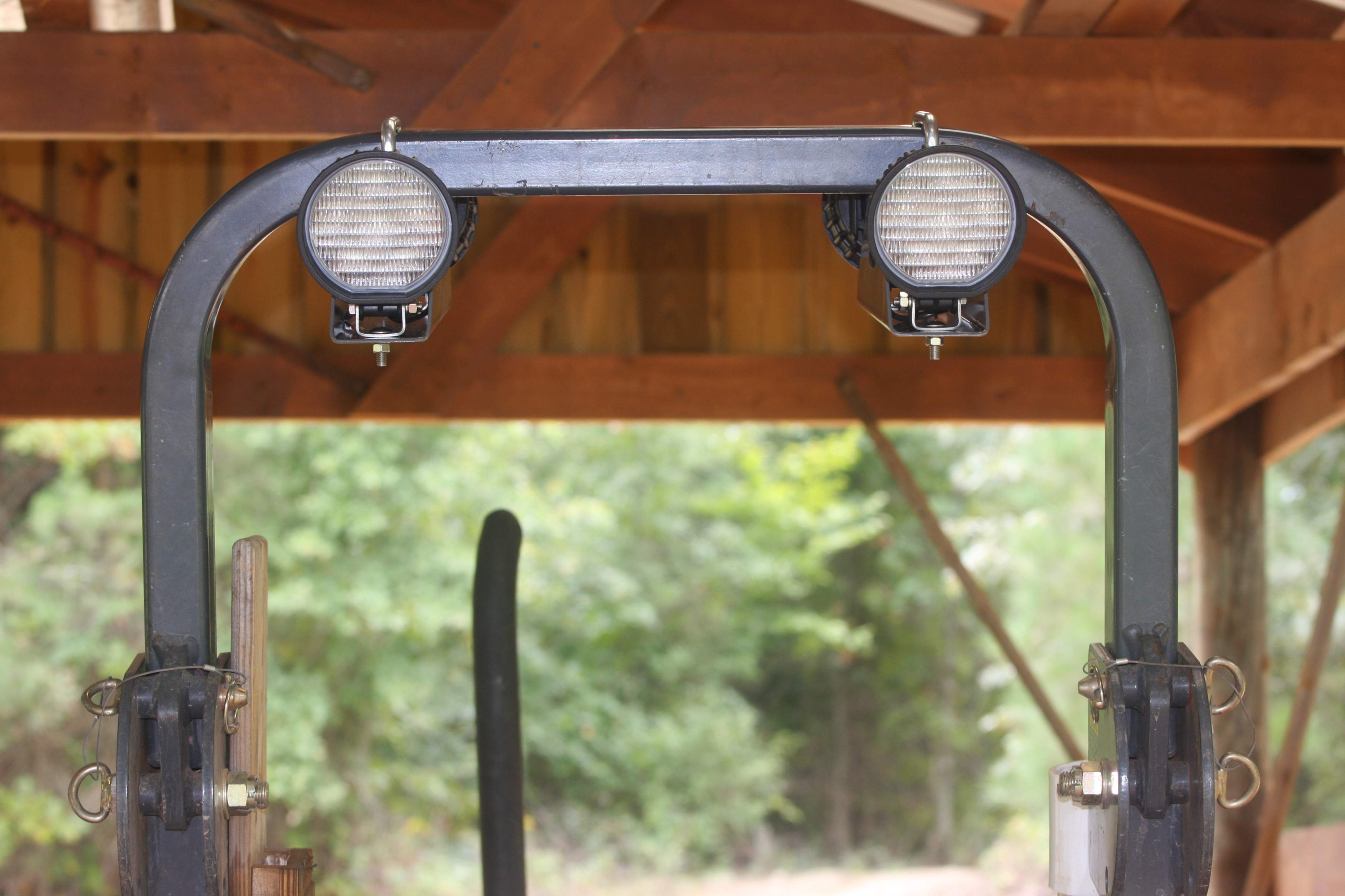

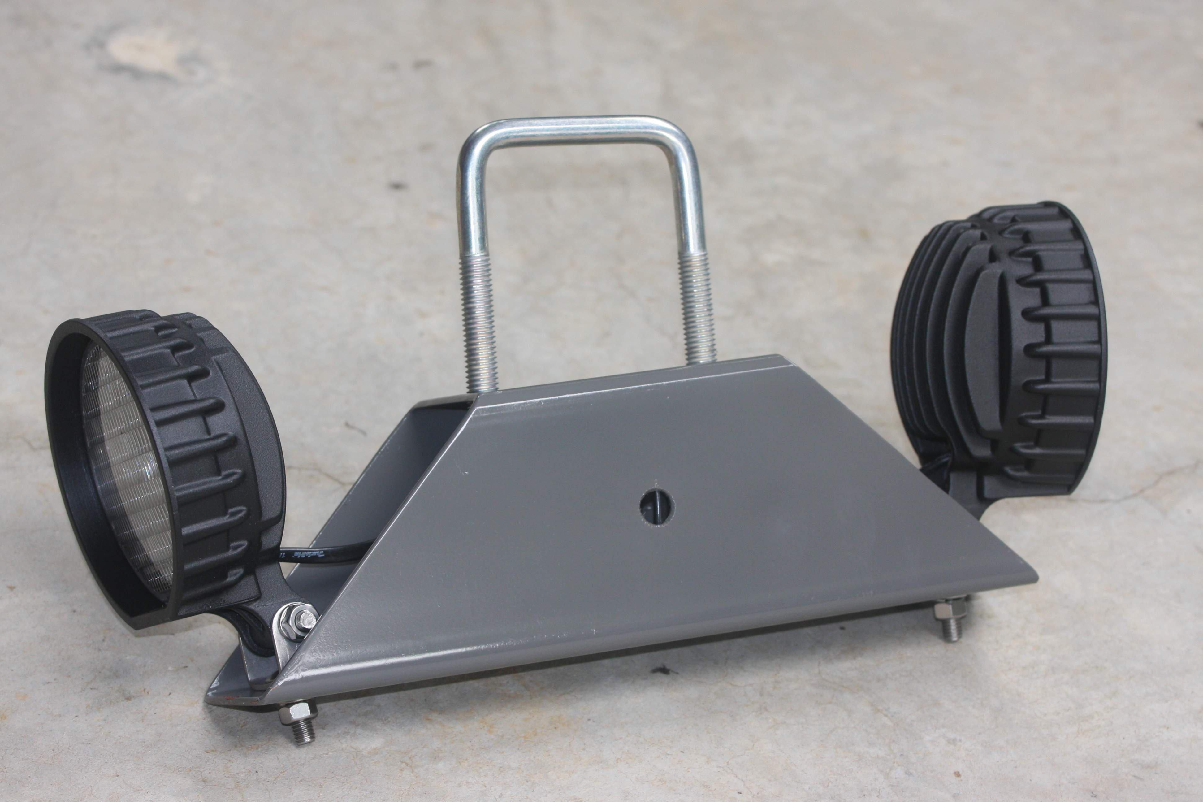

Here is how I mounted mine. Brackets were simple to make and also offer some protection for the lights from low hanging limbs. Has worked really well. Lights are LED from TruckPro. Pricey but good quality.

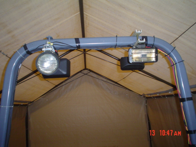

Here my version
Yes i did drill and tap 2- 5/16 holes which did not weaken the ropes (trust me i know) this way it keeps it neat and tidy and protectes the lights from branches and other things.
