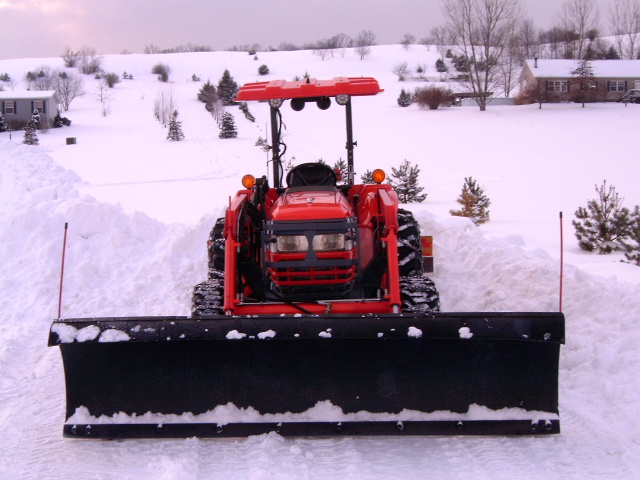

I run a 9' Western power angle front snow blade on my DK 35 with chains on all 4 tires.
