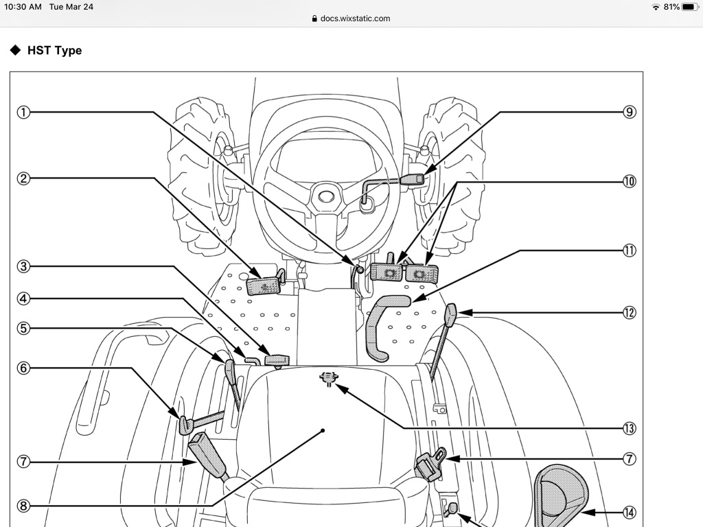

Thanks, having the split brake on the left makes sense. Funny, I had never seen a hydrostatic without the clutch, but I guess it's because I only shopped on the low end of equipment. I infer there is an electronic disengagement on models such as yours, removing the need for a clutch.
I noticed the Kubota kept the split brake on the right for the L2501, guess every manufacturer does it differently; JD makes more sense in that regard. Thanks for replying, Toukow

Kubota has moved the brakes to the left on the newer B series, the base model L's are typically behind the curve compared to the premium models.
Part of it is if there is a food clutch, if so it stays on the left which forces the brakes to be on the right.
