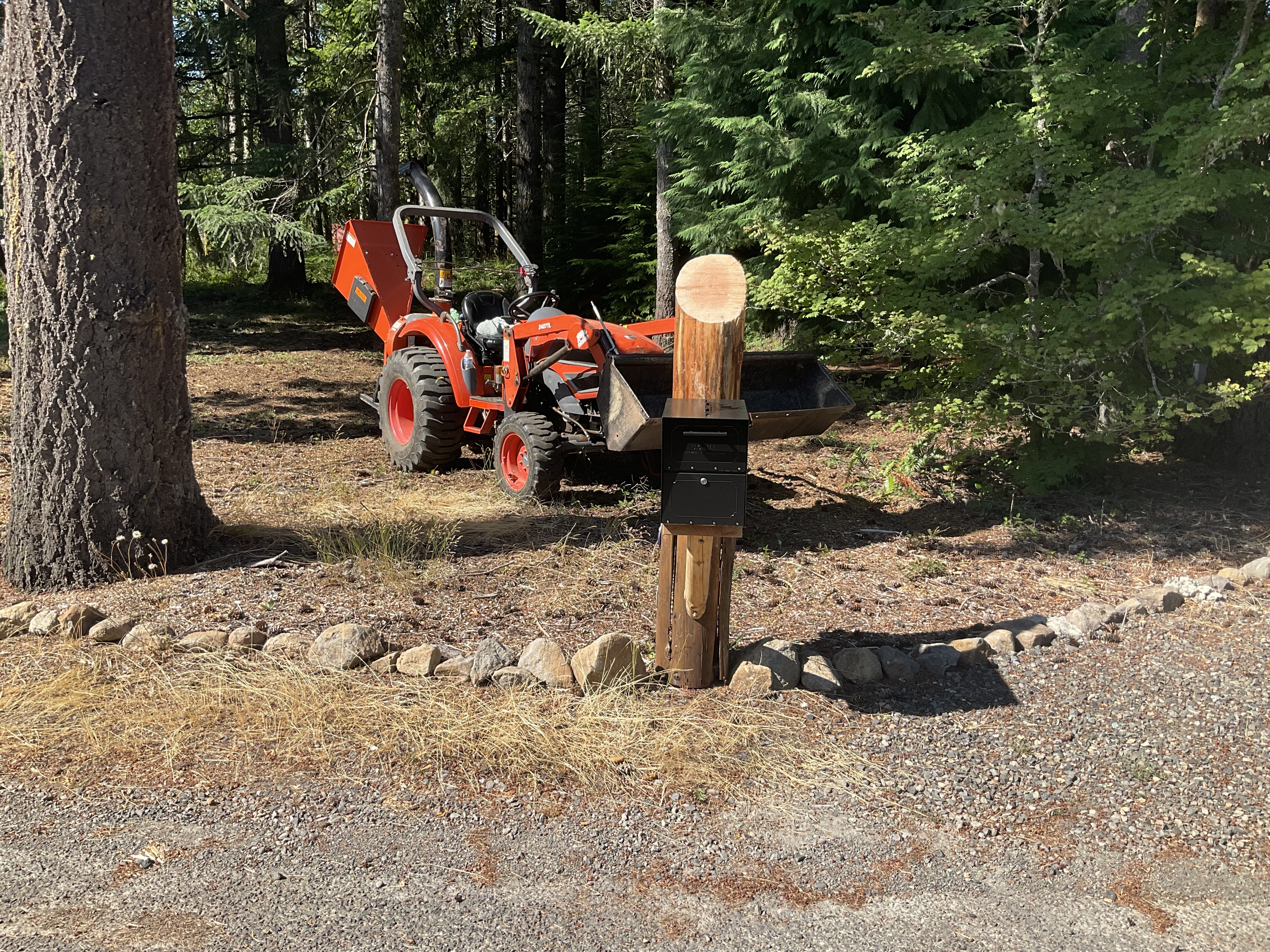

Hi all, I have a blown head gasket. Just wondering if anyone has replaced one and how much of a job it is? It’s a 2005 CK25 HST with 1300 hrs. IMG_5935.jpeg

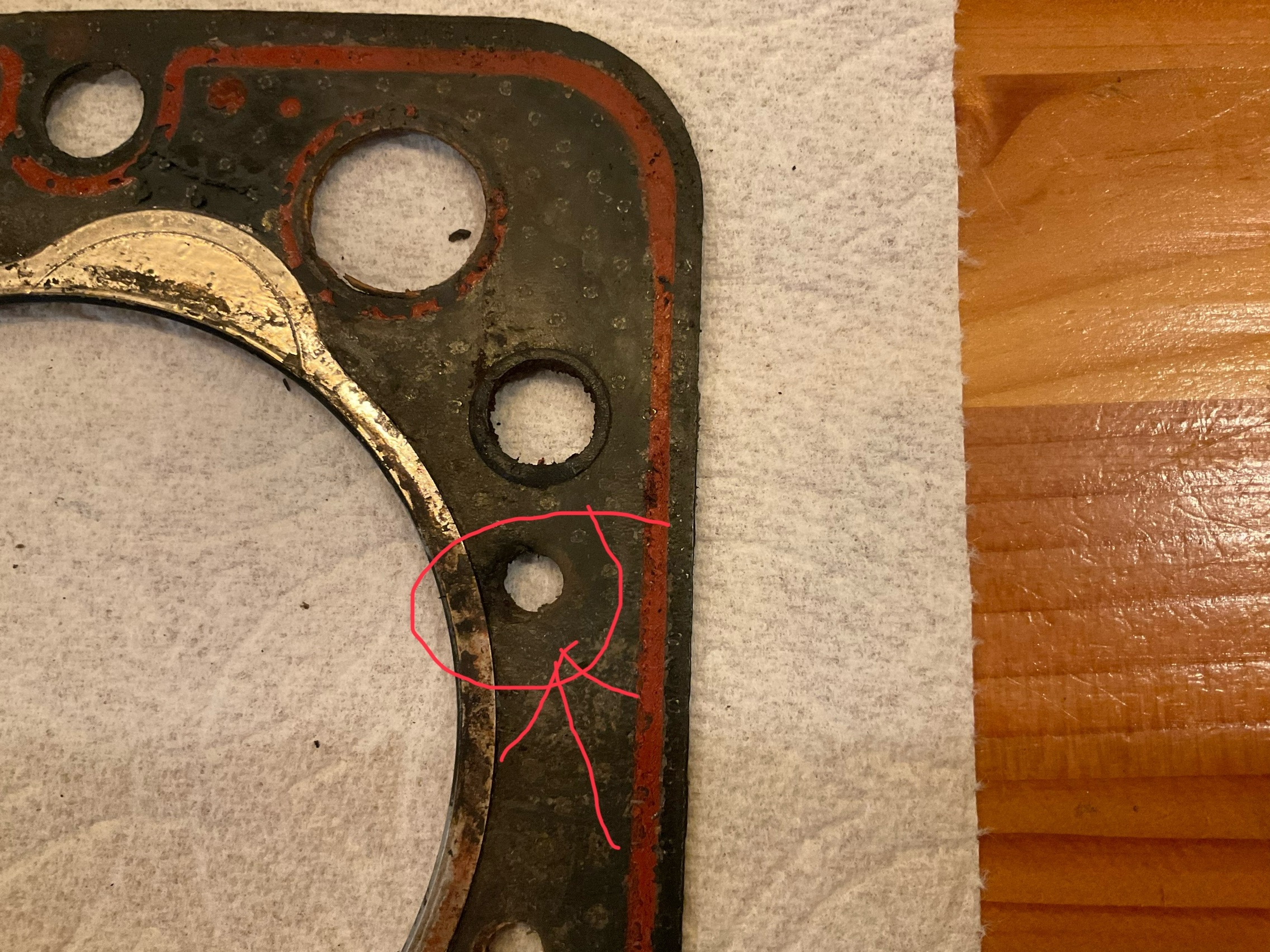

Good news! It only took my friend 2 hours to get the head off, if was a leaking head gasket! I called a Kioti dealer and they wanted 5 large to do the job, including resurfacing and valve seals,WTF is up with that price?IMG_5965.jpeg
