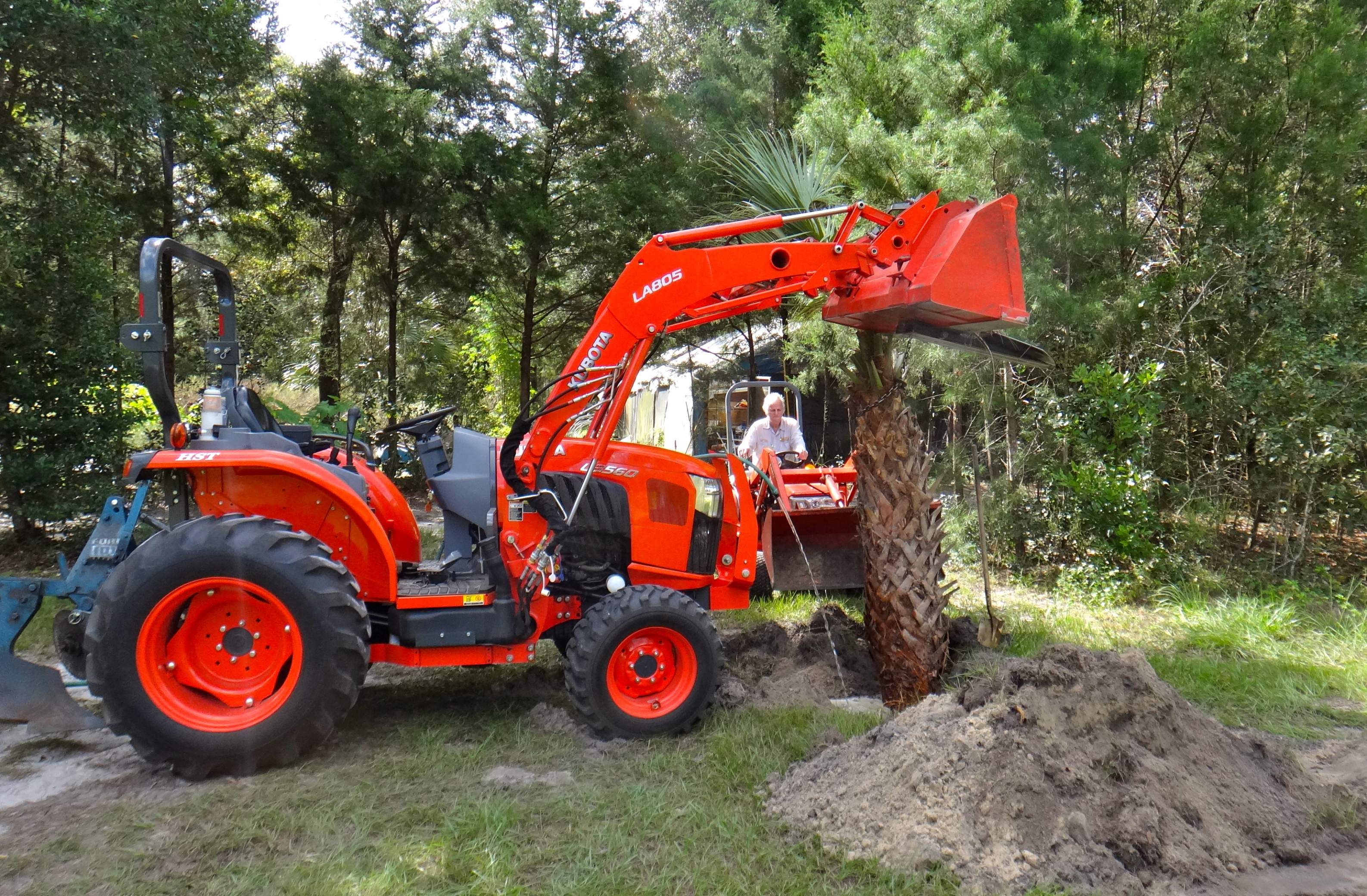

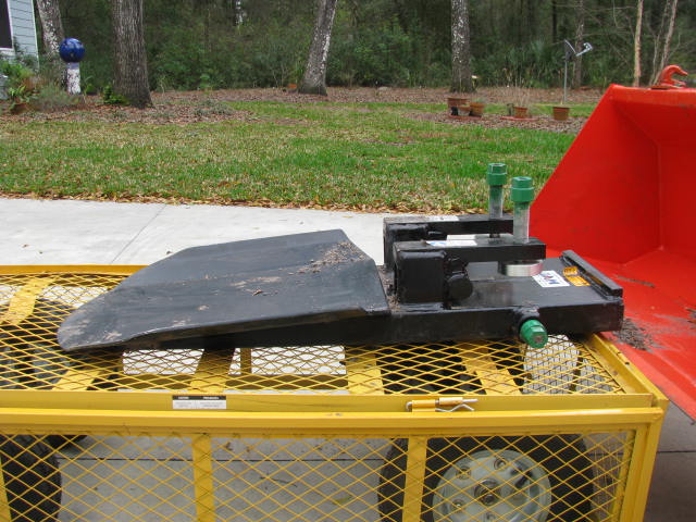

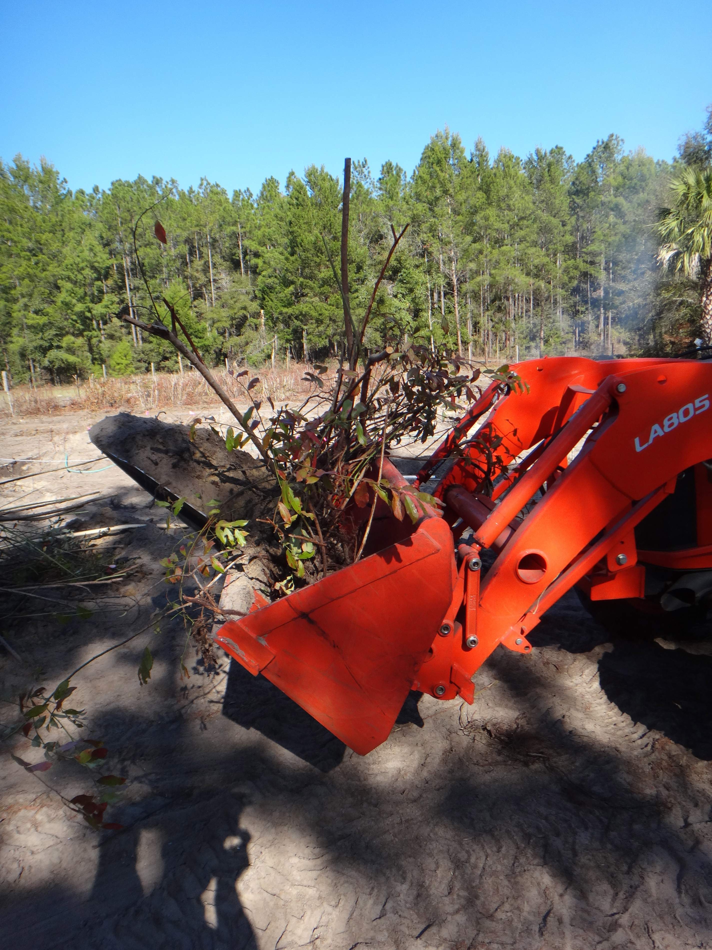

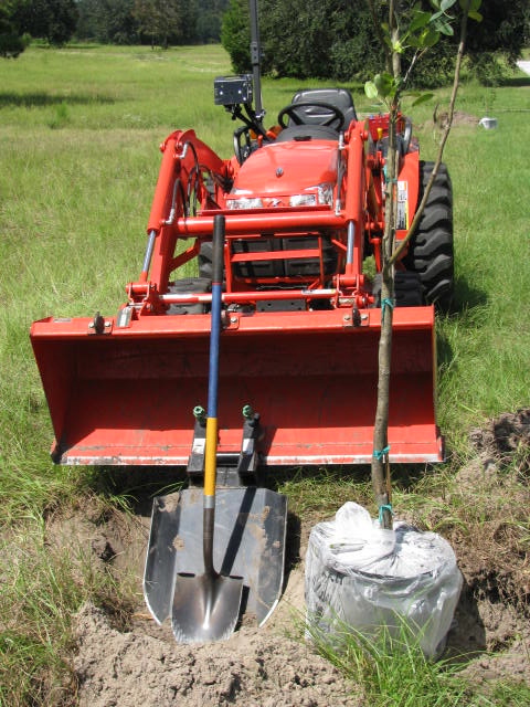

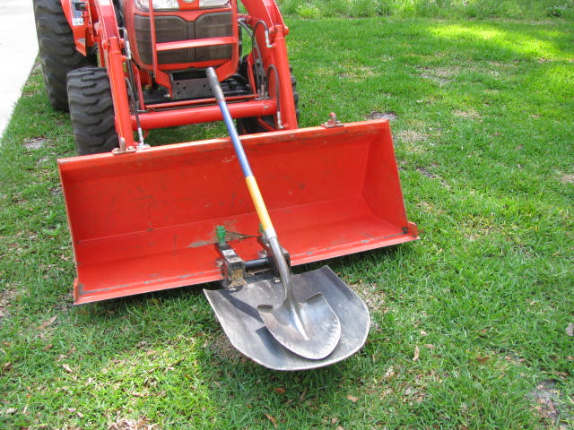

I have Kubota's Heavy Duty L2296 bucket, which weighs 100 pounds more than the standard bucket, on my Kubota L3560. I had a "standard" bucket on my previous Kubota, I prefer the HD L2296.
A beefy, HD bucket makes an excellent mount for a 110 pound Bucket Spade. 50% of what a Backhoe will do for $400.
Speak to your dealer about practicality of Bucket Spade in your hard and rocky soil.
(Bucket Spade has stayed sharp through five years of regular use. I do not know what PSI pressures the soil is but....... 110 pound spade + 400 pound HD bucket + 500 pounds [of 1,279 pounds FEL weight] = 1,010 pounds on knife edge.)
((Kubota L3560))
The pressure which can be exerted on the 18" wide Bucket Spade will be multiples of the pressure which can be applied to a 60" wide bucket tooth bar.
This is one underrated tractor attachment. Best mounted on a Heavy Duty Bucket.
LINK: Tractor and Skidsteer bucket spade shovel
Sorry, but that bucket spade will do less than 10% of what a backhoe will do, and be useless in rocky soil.
   / Kioti ck2610 66" bucket or 60" "heavy duty" bucket? #6
I have a "bucket spade" for my forks. You are correct about how fast it can dig but it does work in rocky soil and can be very useful in tight quarters. I use my BH for most digging but for a simple job it's much easier to use a bucket spade than remove another 3PT implement and mount a BH. The

PLEASE: A few words iterating your personal experience with a Bucket Solutions (brand) Bucket Spade......
I don't think the brand matters. These bucket spades are all of necessity virtually identical in design and have identical pros and cons.
The biggest two cons are 1) very limited digging depth when mounted to a bucket lip (not so limited when on the tip of four foot forks though). And 2) you need to move the tractor to dump each shovel full of spoils.
Pros as mentioned earlier are the ability to dig a shallow trench without expensive equipment and for general gardening digging.
I'm glad I have mine but it isn't anything close to even a quarter of a backhoe for digging efficiency. 10% of a BH and 400% of a guy with a shovel is more like it.
