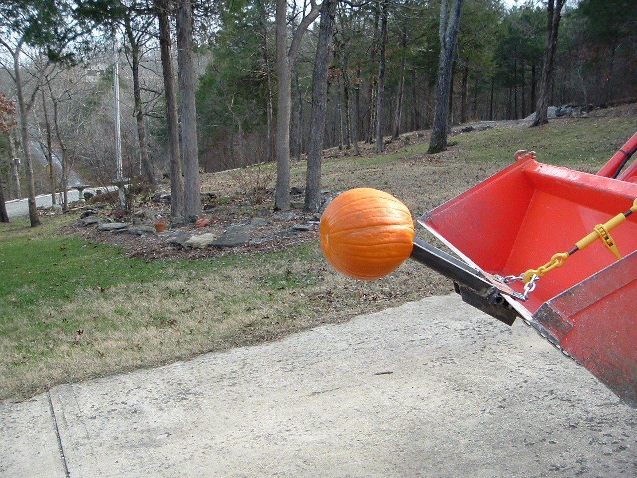

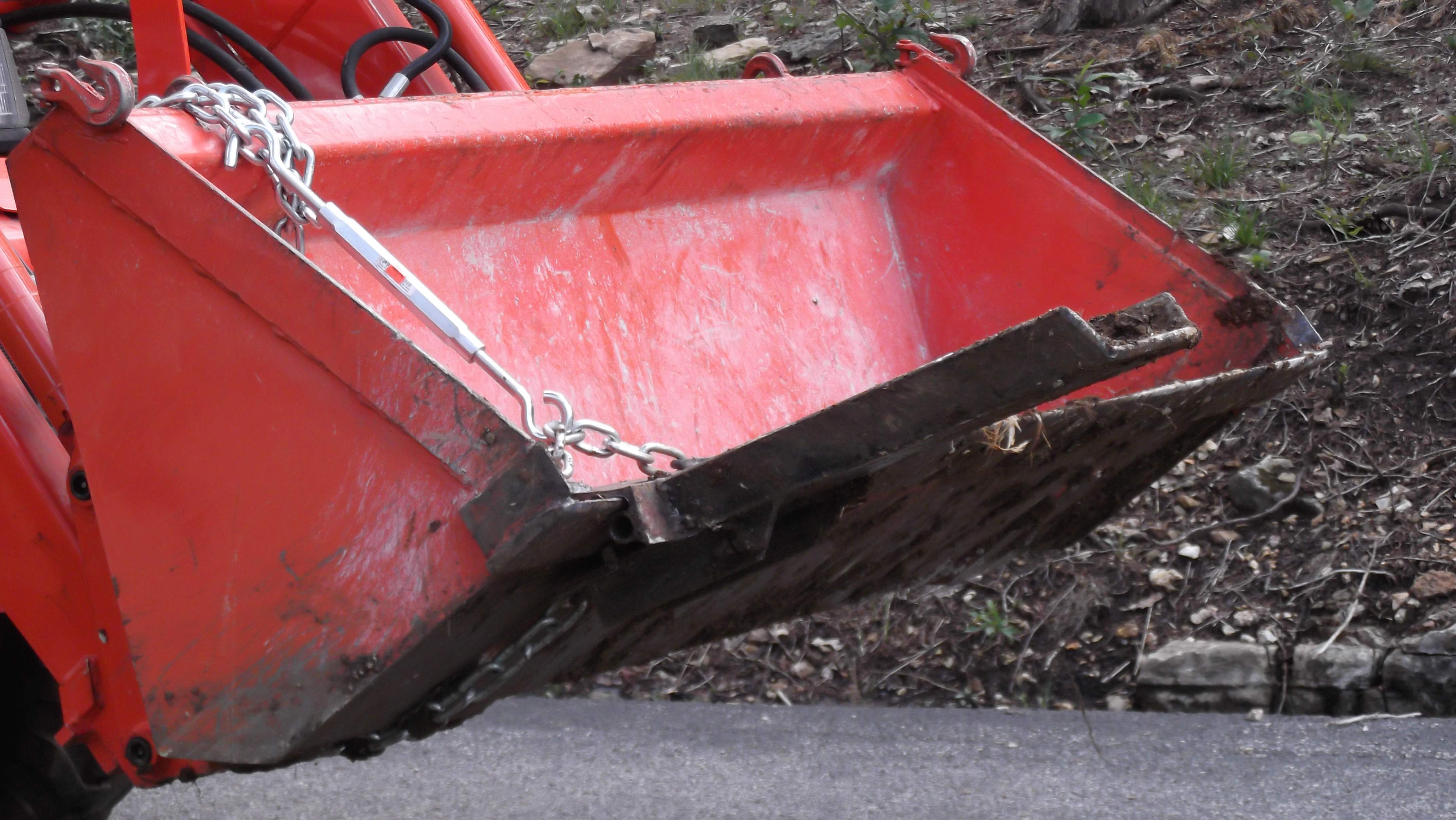

I have both the 66 inch bucket that came from Kioti and a 60 inch that came from a previous Kubota. With SSQA I can switch back and forth. I can testify that the 60 inch will dig better. I don not have a toothbar on either, though I am sure that would help a lot. I don't have soil I just have rocks.:) Well there is SOME soil. I have a homemade bucket spade. and it digs ditches in our mostly rock, some soil like you would not believe. I have dug several. Sure it is not a backhoe, and is limited to a max of about 18 inches in depth, but it sure as heck will dig. If you dont believe it, let me have a go at your lawn, and I guarantee I can have a nice 18 inch trench down the middle of it in no time.:)
I have less than $20 total in my "bucket spade", I have a welder. :), and something of a scrap pile. Th bucket spade can be useful for picking pumpkins too.

Looks like a nice trenching tool you fabricated. I wonder if the spoils will just self load into the bucket if you keep pushing with the bucket at a 30 degree or so angle. The one thing I don't like about the bucket spade is that you have to move the tractor sideways (or in a Y maneuver) every time the spade is full to empty the spoils.
Another option might be to weld up a bucket spade that curved like a plow so the spoils would deposit on the side of the trench. Now that would be a really useful tool for placing water and electric lines.

I have always had to do the Y maneuver. Easy with a HST tranny. I hVe been able to dig out pretty good sized rocks with it. I dug a 200 foot ditch about a foot deep in a couple of hours as I recall.
   / Kioti ck2610 66" bucket or 60" "heavy duty" bucket? #17
200ft in a couple of hours is not bad at all.
Problem with the full size bucket spade (rather than narrow like yours) is that you end up with a significantly wider trench than needed for almost any water or electric line but have all the spoils and soil disruption to deal with. I've always liked the idea of using a subsoiler to lay cable but I've never had to do it.
