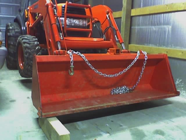

I was hesitant to post this, because we all know that it does not prove anything, but here is my 5030 with 378 hours on it doing the same thing. Don't read into this more than what there topically is.
Oh yeah, Highbeam, what grade is my log pulling chain? /forums/images/graemlins/grin.gif

   / Kioti CK30 loader repair and reinforcement #85
I can't tell a whole lot with 2d pictures, but Dargo's looks nice and level.
Tomorrow I will try this experiment, but I suspect I won't have the same results as Dargo.

   / Kioti CK30 loader repair and reinforcement #86
I believe the proof is in the picture. That loader is not twisting at all. Got me wondering now. I will try mine tomorrow. Very interesting. Thanks for the picture.
I wonder if a smaller loader like the CK25 of another manufacture would twist like the CK25? It is hard to make a comparision between a larger tractor and loader and the CK25.

Get that tractor off those jack stands /forums/images/graemlins/grin.gif

Dargo:
Tomorow, I'm going to try that with the M9 and a 6" block. That is if we have a barn left after tonight. Those are sure little wheels on that 5030 /forums/images/graemlins/grin.gif I'll do the picture straight on like the Kioti. I'm really curious as my tractor weighs almost 7500 pounds complete.
Last weekend I was prying stumps with a corner of the bucket but you can't really tell anything from inside the cab.
The crossmember on the 1251 loader is round like the 853 you have only bigger in diameter.

</font><font color="blue" class="small">( I can't tell a whole lot with 2d pictures, but Dargo's looks nice and level. )</font>
No, it was actually sagging a couple of inches. Sorry for the crappy picture, but it is from my phone.
I did have a Case 580E backhoe that was really great to grade my driveway with. It would flex a couple of feet from side to side. It may sound odd, but when back-dragging a driveway, a little flex seems to do a better job.
Insp507, naw, I didn't use jackstands, I used that new high test fishing line. If you look close, you can see it on the "unsupported" side. /forums/images/graemlins/grin.gif

</font><font color="blue" class="small">( I'm really curious as my tractor weighs almost 7500 pounds complete. )</font>
That in particular (weight on the front end) as well as designed flex, and lots of other issues is why I don't honestly think this "test" proves anything.
