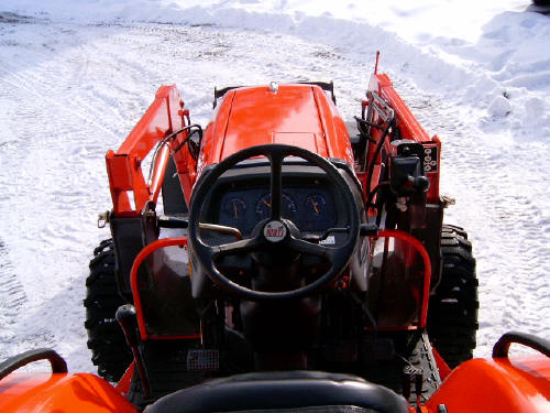

</font><font color="blue" class="small">( How is the loader on your DK braced in comparison to the top brace? )</font>
My 1450 loader has no top brace.
see attachment

The reason for the brace on the top is the same reason the brace on the bottom of all the other loader (like the DK35 Loader). It keeps the loader mounting brackets from pushing apart. If you look underneth the loader there is a brace. The brace is on top the CK20 due to ground clearence and probably because of the MMM.
