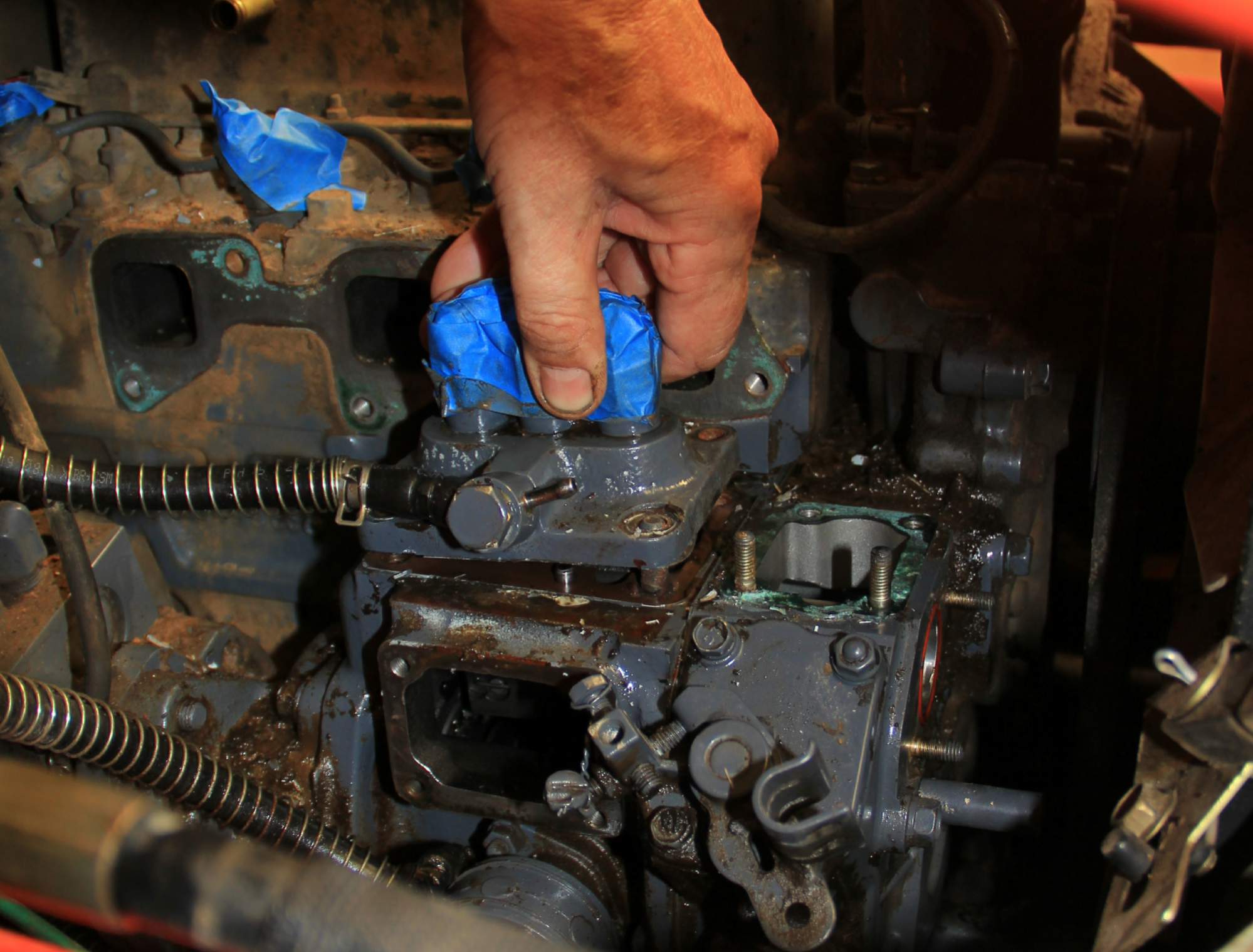

So I spent the day taking everything apart in order to get to the IP. I have good pictures with step by step to get there that I will post later but now I'm finally at the pump but it will not come out. Take a look at the picture. I can lift it about 1/2 inch in the front and a 1/4 inch in the back but that's it. Getting really frustrated. Does anyone have an idea? IP removal.jpg

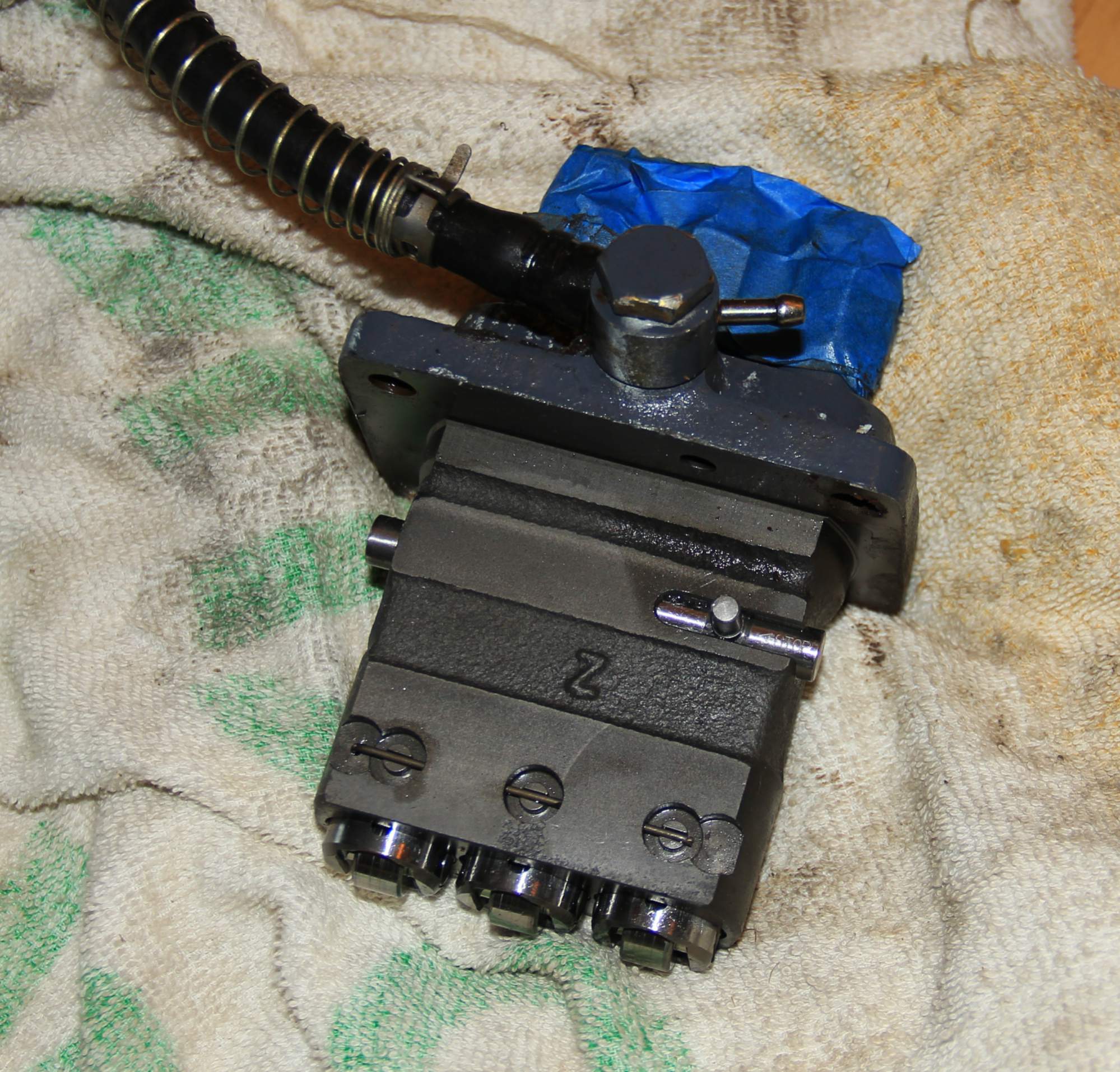

Using a mirror I could see the rack, being so far back, prevented the removal. I had no other choice than using a rod in the idle hole banging it forwards until I was able to get it out. So here it is on the kitchen table ready to be taken apart. Can't move the rack without using force. Kind of wonder, how is this lubricated?

Using a mirror I could see the rack, being so far back, prevented the removal. I had no other choice than using a rod in the idle hole banging it forwards until I was able to get it out. So here it is on the kitchen table ready to be taken apart. Can't move the rack without using force. Kind of wonder, how is this lubricated? <img src="http://www.tractorbynet.com/forums/files/kioti-owning-operating/390374-kioti-ck30-will-not-start-img_0312-jpg"/>
... beating the rack back to get the unit out is not a good idea if your aim is to repair it.
These units are lubricated externally by oil splash and internally of course by diesel.
Kioti will suggest that after you have it out like you do, to get some Seafoam cleaner type stuff and sunk the whole unit completely submerged in that stuff in a pail for a week or so. If you can get anyone at Kioti to advise you at all they would tell you that, also to put conditioner in your diesel..... but don't waste your time.
None of that soaking stuff or that 180 degree rotation trick worked for me and I finally had enough of messing with it. I too couldn't resist finally beating "lightly" on the rack to get it to move.
Anyway, go get a new one from Michigan Iron. Easy to install. Your tractor will probably then work like it was new.
It is about a grand for a new unit but well worth it in my opinion to just get a new guaranteed part.
Kioti corporate has apparently decided to accept a bad reputation with regard to these early pumps.
Hope all works out for you good for you with this. You will get lots of sympathy on this form regarding the pump but not much I'm the way of a satisfactory patch for this known Kioti problem.
