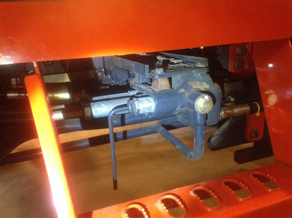

How do you turn up the relief pressure on the loader?
/ Kioti CK30 #9
First off, I do not recommend turning up the system pressure above the manufactures specs. It may result in damage, injury or death.
If you feel your loader is not operating as specified, it is possible the relief valve is set at a lower pressure than the manufactures settings.
You will need a gauge with a quick disconnect on it to measure the pressure. The relief valve is under the right step on the joystick valve. I am showing an allen key where the adjustment is made. Loosen jam nut, adjust, tighten jam nut.

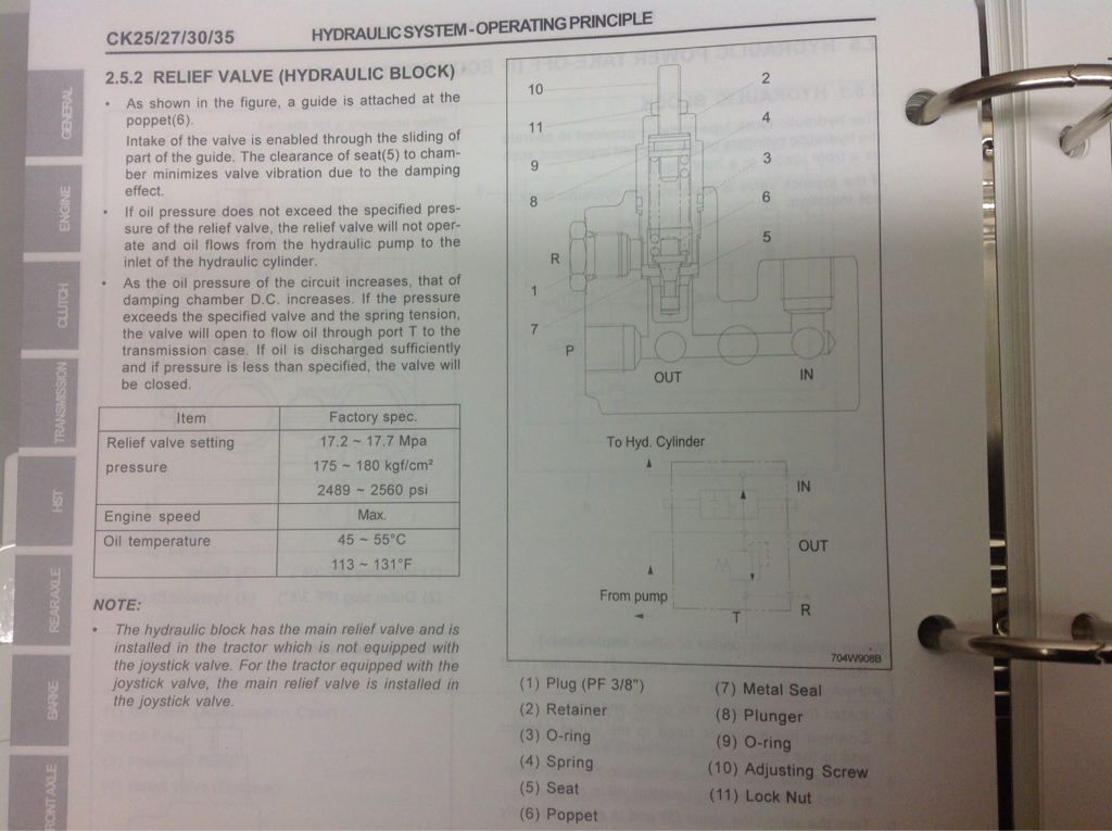

The factory setting for the CK25-35 is between 2489 psi and 2560 psi as shown on page 10-10 in the service manual.
