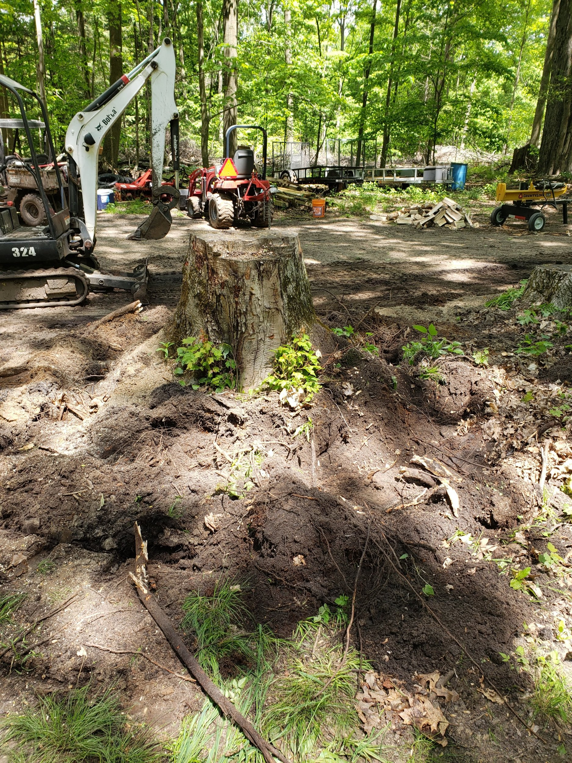

I dug this one with my KX-040 excavator. I could drag it around pretty good but couldn’t lift it. Your neighbors 6 ton excavator is way stronger than a tractor backhoe though. View attachment 742340
Yeah it is. It also cost him , i think 70k it is a Bobcats
