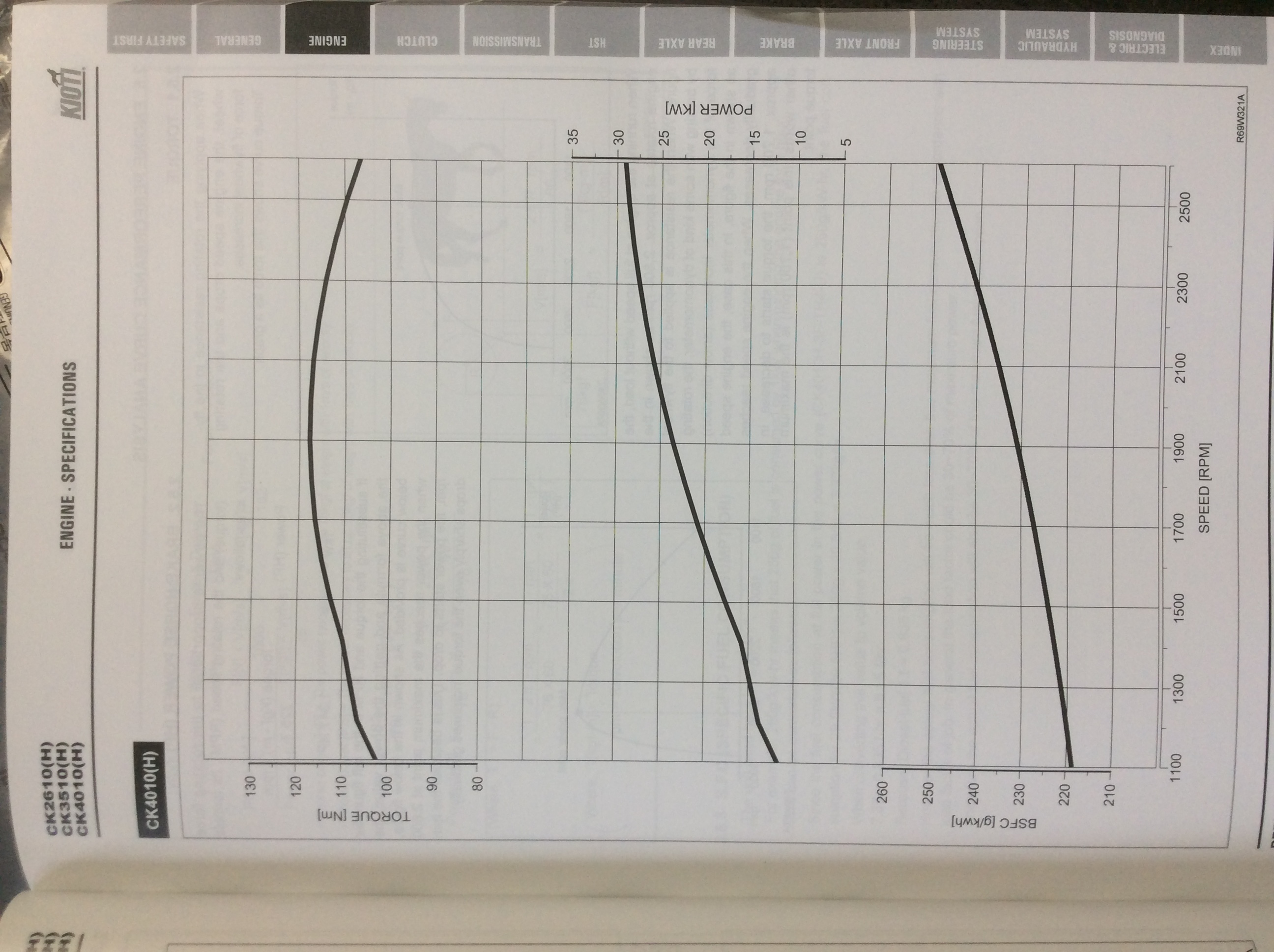

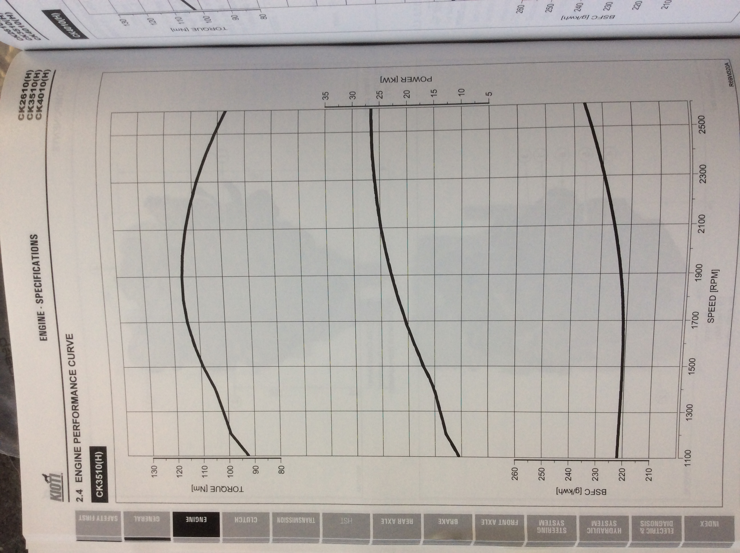

Hello,
I've only got a few hours on it but love the tractor. I'm not sure if I really needed the 40 but glad I have it. I'm out of town but can post the torque curves from the service manual when I get home and you can make the call.
So far I have found no physical differences in parts between 35 and 40.
The dealer is awesome, glad I got the rear ports, and the RimGuard for weight in the tires. Will look at the backhoe and grapple once I pay down a bit. Only complaint I have so far is the bonnet latch is tough to rehook. 😃
