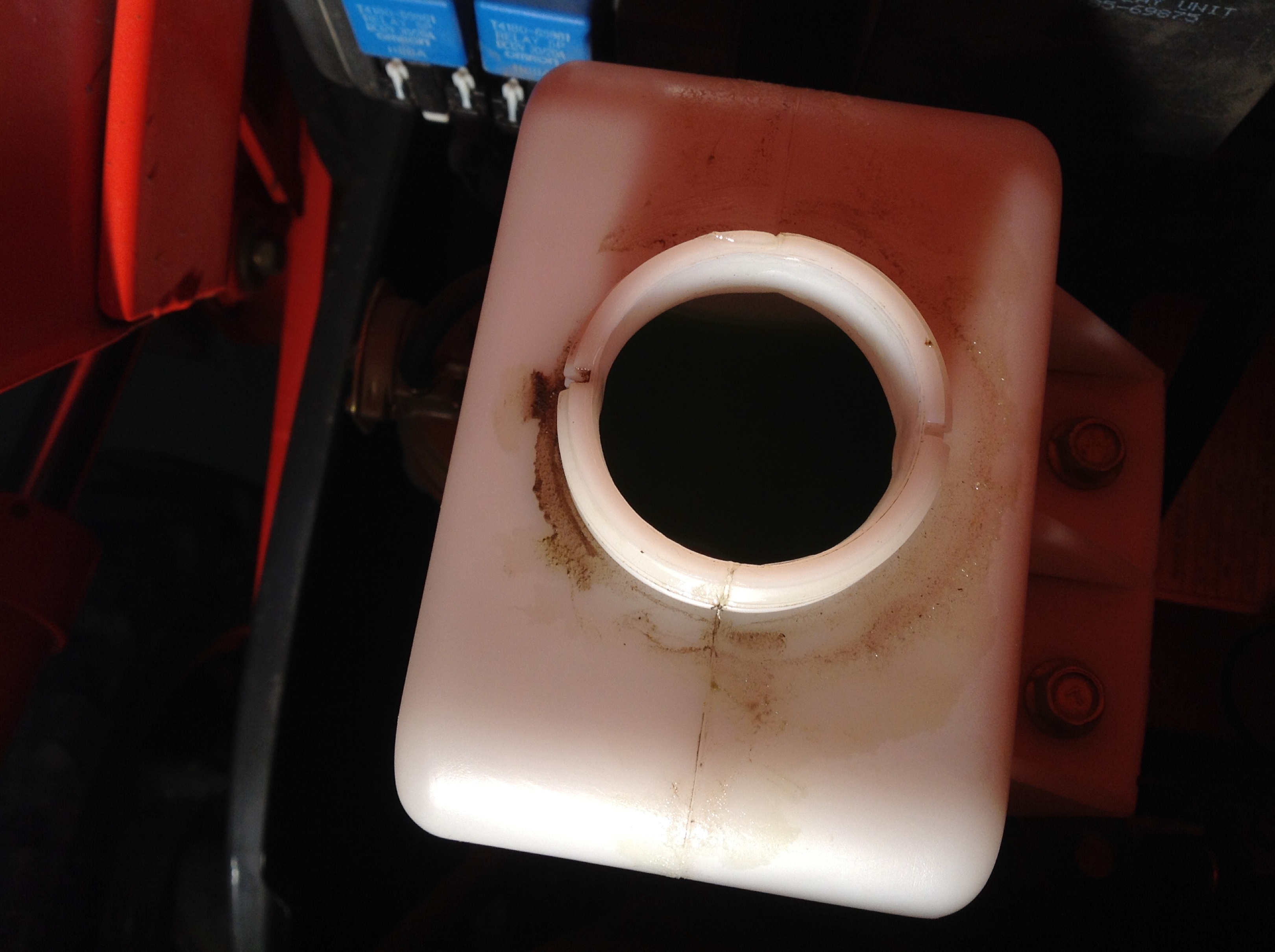

YLee, does your expansion tank have a hose coming from the radiator to the bottom of the tank, and an overflow hose going from the top of the tank directed to the ground? Or does the tank just have a cap on it and the antifreeze overflows through the cap threads? A slot in the male threads of the tank, so the system breaths.
This is a pic of my CK 35 expansion tank. Just a cap. After getting tired of cleaning and filling the tank I went to my dealer and found that some tractors on the lot had a tank like mine and some had a overflow hose coming out of the tank neck.
I ended up letting the tank burp as much as it wanted till it no longer overflowed. It settled just a little bit above the minimum line and has been there for 5 years now.

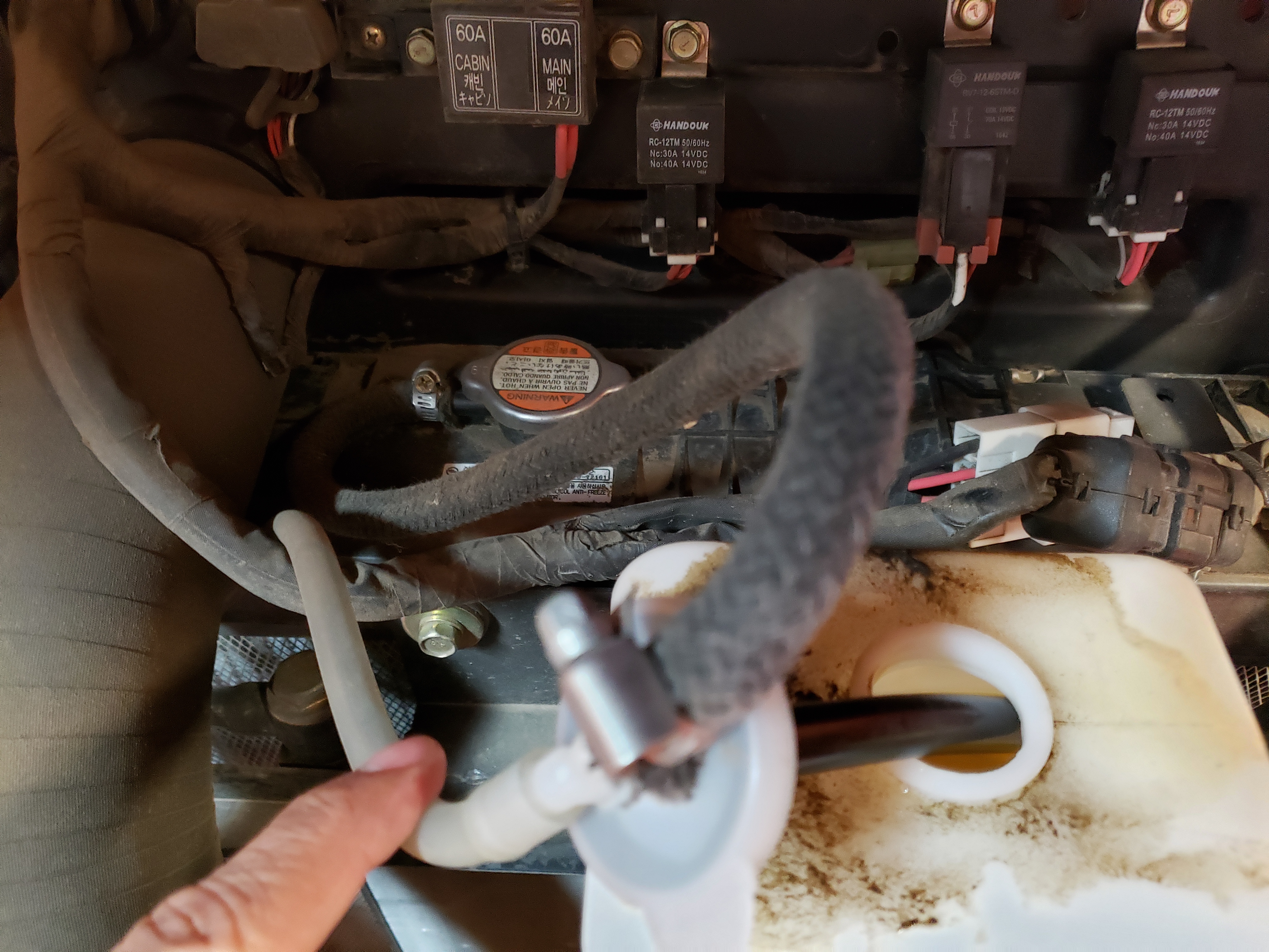

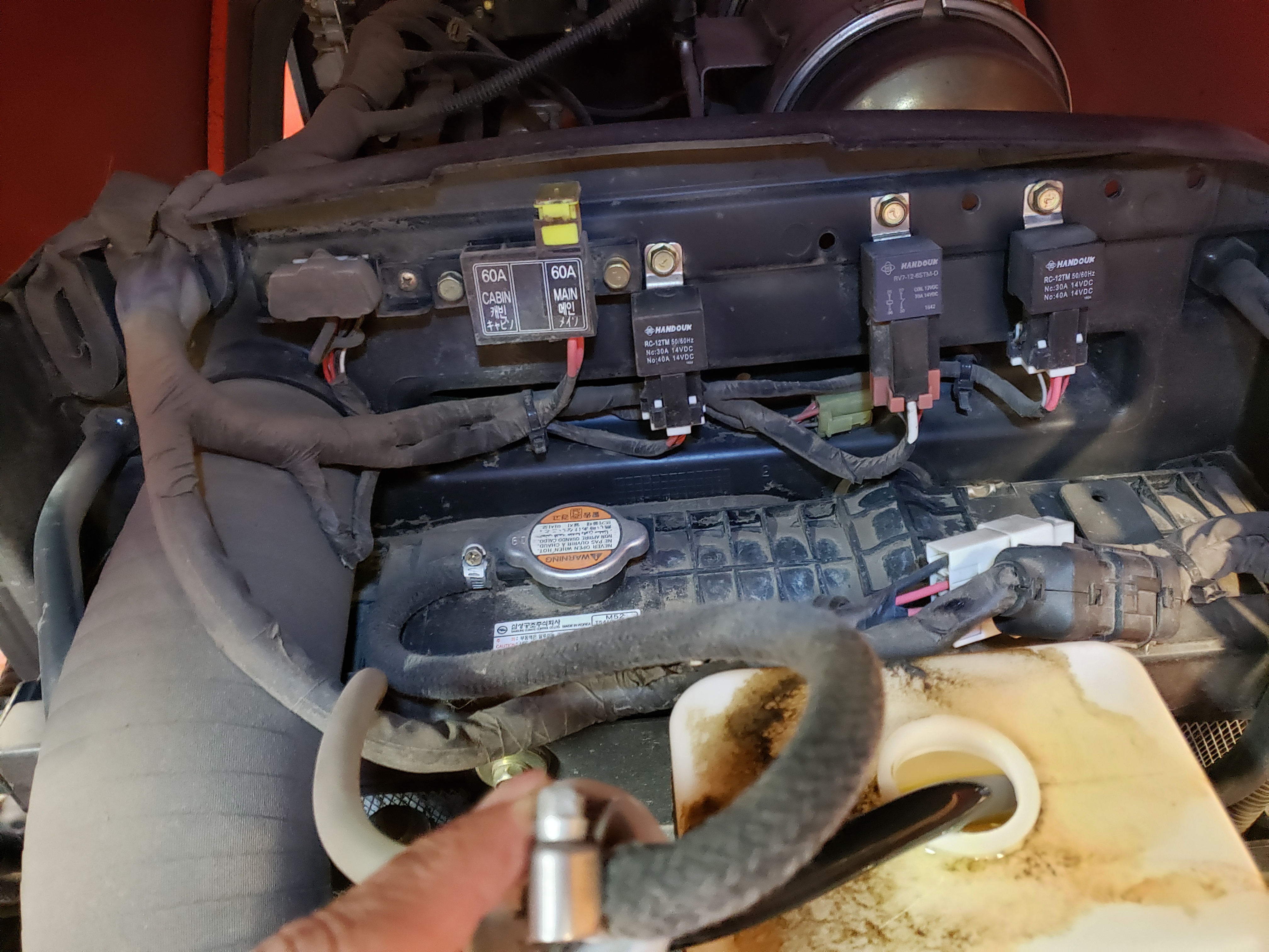

Last August cut about 8 acres of an elderly rancher's place. The old cattle pen veggie was to the top of rear tires and the open graze area was about halfway up the rear tire. On the second day the temp gauge went past the normal op. indication. Let it cool off and then went back to work. by day's end indication moved towards the red zone again.
When offloaded at home the tank level was below the minimum line and the tank was covered with debris caked to the tank.
So that's what I based my comment on. (note, yeah forgot to take blower to keep radiator clean)
So mine has the radiator overflow hose to the cap and a second overflow to the ground.
The tanks look clean (well sorta) since I hosed it down hard after a cutting session.
You can see how it collects dirt/dust as coolant seeps around the cap. I thought it was normal since it's been that way since day one.
level is about an inch from the full line indicator.
Have not been able to work it hard enough to see it lose any level, yet.
Should close the loop with this.
