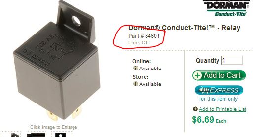

I have seen that under the dashboard there are 4 relays. And I can not figure it out what each of them does. I figured that second relay from left starts the tractor. Try to replace it, but no change.

I will try changing relays and measuring voltage. It seems very minor thing but cant figure it out.

Yep, changing the relays is a good idea. Take pictures before and after each switch out, just to keep track of what you did each time. Do one at a time is my suggestion….😉

Thanks everyone for all the answers.
It was a relay. And the one marked as engine start relay (preety obious now 🤦‍♂️)
The problem was that it was a 5 pole relay (with NC and NO contacts) and I was testing it with 4 pole (NO).
Now it runs like a charm :D
Thanks again everyone.
