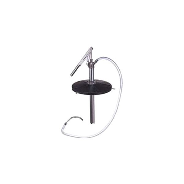

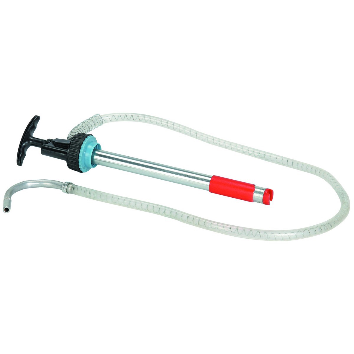

Hey all, I know this is an older thread, but if you're having issues getting fluid from buckets into your tractor, you can use a rotary hand pump that's meant for 55 gallon drums to transfer fluid pretty easily. Set the bucket on the ground behind the tractor, stick the rotary hand pump tube down into the bucket, put a hose on the end of the hand pump outlet and stick the other end in the trans fill port and start pumping away. The hand pump works great, and only takes a few minutes to transfer five gallons of fluid. You can get the hand pumps from HF or NT for less than $50.
