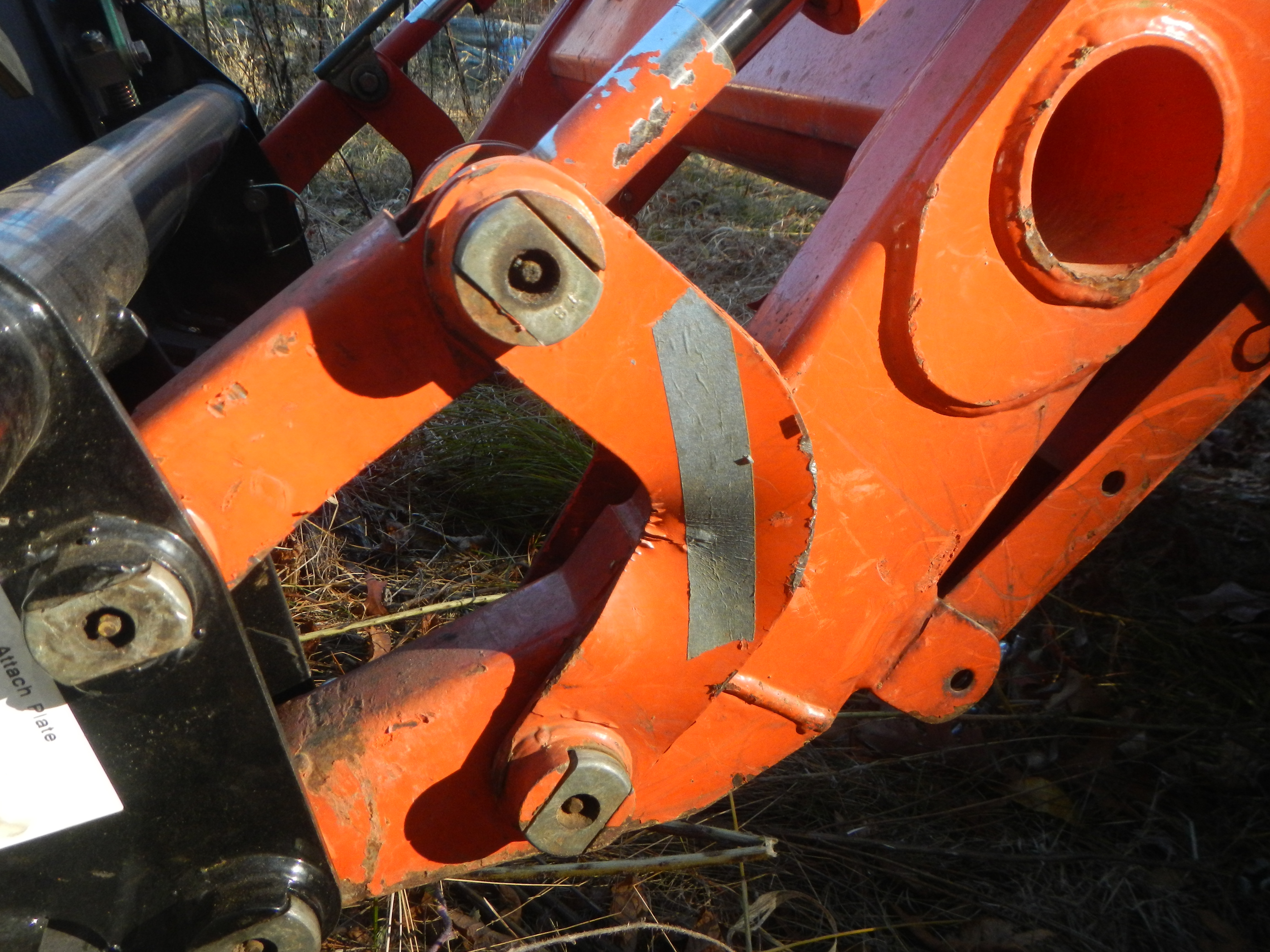

I've bend the two 'C' brackets on the left side my KL-130 front end loader.
What is the actual name for the parts? Would anyone know the part number(s)?
Or alternatively - the location of the service manual for the loader?

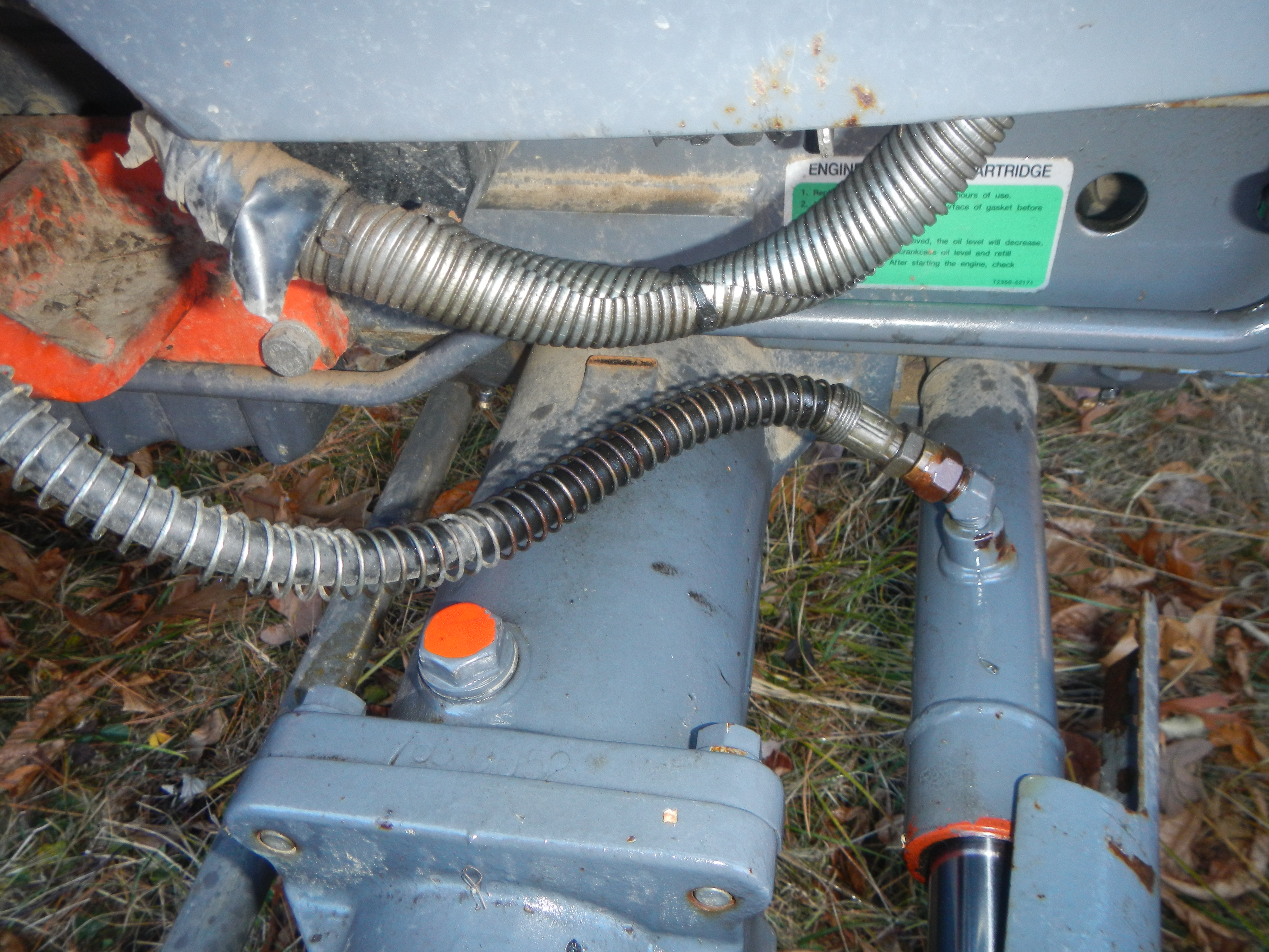

On the right side of my CK35 HST tractor, a hose that operates the power steering sprays fluid when I turn the wheel.
In the service manual, I've found part number T2185-45032, is this correct?

Do a search on MIE. Parts Finder Michigan Iron and Equipment Morrice, MI (855) 265-459

Thank you. Found it.
CK06-0200L (or R) Boom Linkage Assembly Outer LH
CK06-0100L (or L) Boom Linkage Assembly Inner LH
Some call those "kidney links" due to their shape. On some tractors they are straight, not in a
C-shape, and cast steel, rather than mild plate with DOM welded in at the pivots.
Anyway, I have bent mine, too, so you are not alone. To repair, I cut nearly thru them at the bend, bent them
back in a press, then welded them.
I do not use the links at all when mounting my forks, just for the bucket.
If you buy a set of 4 new, I would be curious what they cost.
   / Kioti-KL130 loader 'C' bracket bent / power streering hose broken #6
I would also opt to press them back to original shape, then weld some plate the outsides so it doesn't happen again.
