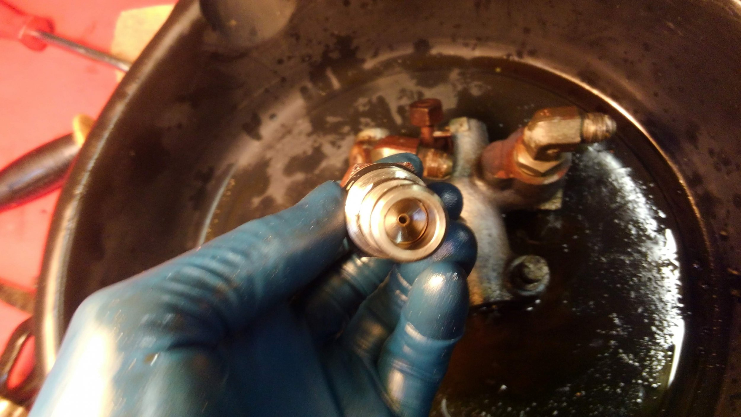

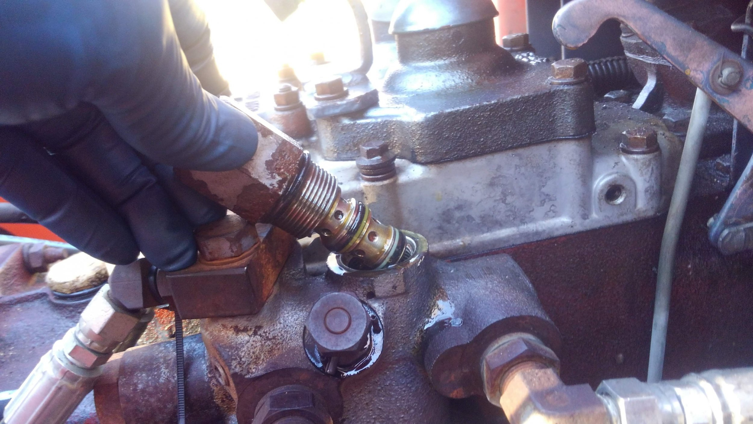

Another update. The priority valve in this application works nothing like the one in the above video as far as I can tell.
This valve sits on the top of the priority valve block and partitions oil between the steering and loader. I believe the hole in the center allows oil to pass through at all times no matter the position of the valve. The loader only gets oil when the plunger moves up in its bore. I was able to verify this by hitting it with compressed air. There's always flow coming out the top. At 110 PSI, the compressed air was not enough to make the spring move up, so nothing ever came out of the loader ports.
This is the only other spring loaded valve in the block, and it looks like it's just a simple spring loaded over pressure valve. At some pressure level, it would allow oil to pass from the inlet to the outlet of the block if the pressure gets too high.
Both valves seemed to be functioning properly and there was no obvious problem with either as far as I could see. Also, the valve on the block that you dial with your hand, I looked down the bore and could see that this is basically the same as a ball valve. Turn it 90 degrees it's full open, turn it back, it's full closed. This allows oil to completely bypass the loader and power steering circuits and direct more flow straight to the 3-point hitch hydraulics.

This leads me to believe that the above spring-loaded valve is the problem. This is the same one I showed in the first pic in Post #4 above. I even think there may be parts missing inside the valve block, because I cannot see how this thing should allow pressure to build in that chamber the way it sits. Everything is just going to blow through that hole. That hole in the bottom of the valve looks like it should seat on a needle or ball something in order for it to actually function in any meaningful way. That said, I'd like to put the feelers out. Does anyone know where I can find a parts breakdown or schematic of the inside of this valve block? Even if someone could pull their still-functioning one apart and tell me what's inside would be fine. Neither the KL122 manual nor the LB2204 shop manual show this. They just show the outside of the block with the labels for where the loader hoses should hook. I know this has to be the problem because it's the only logical point of failure that would cause this symptom. The other valve in the lower left hand side of the block is obviously functioning fine because it is just an overpressure valve, and I'm still able to get pressure in that chamber if both circuits are under load.

Okay, so I finally made some headway on this. In the parts manual this whole valve block is called the Hydraulic Block Group/Oil Pressure Relief Assembly. I didn't recognize it before because they have it displayed from the back side of the unit for some reason, and I hadn't seen it from that angle until I had it off the machine and dismantled it. The part in question here that I think might be the problem is the Flow Divider Assembly (the piece I have in my hand in the above photo). I haven't been able to make heads or tails of whether it's malfunctioning. As I said earlier, I didn't figure out a way to disassemble it, although they do show the two ported sections there as separate pieces in the parts breakdown. At any rate, this thing moves up and down if you push the spool back and forth manually, so I'm not sure there's an issue.
Now that I have a part number to search, I found that they used this same Flow Divider in several of the B and M-series Kubota tractors. Many of those tractors apparently had this same problem as well. On one of the threads I read, one of the commenters claiming to be a former Kubota mechanic said "There was a bulletin on this problem and a kit to repair it a few years ago. I don't work at a dealership anymore so I don't have access to the bulletin. what they did though was separate the steering return and return it directly to the transmission instead of the hydraulic pump suction line. It shouldn't be very hard to come up with the fittings to do it yourself." I'm probably going to try this next. Can anyone here speak to whether this is sound advice?
