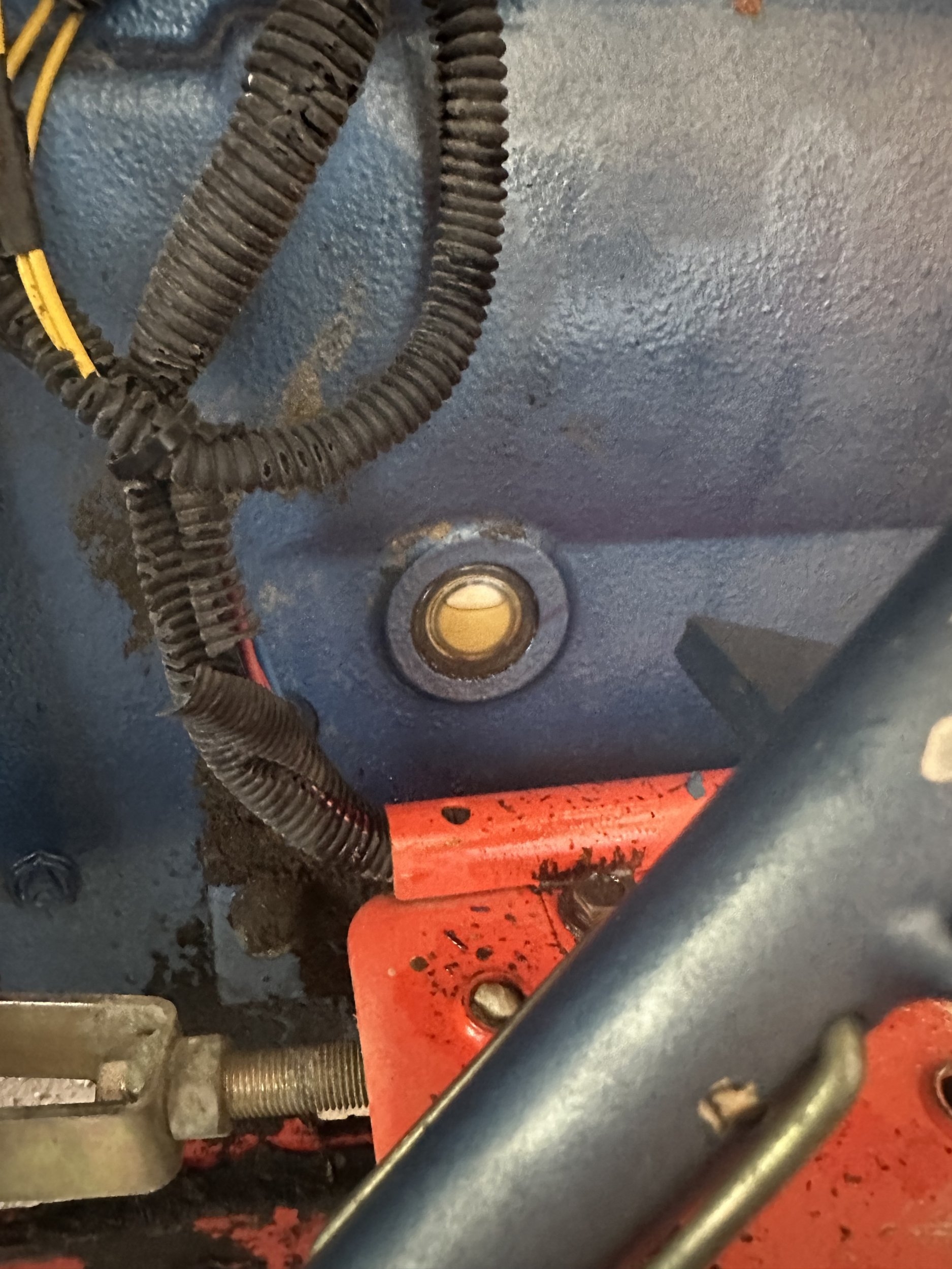

just purchased a tractor and the hydro/tranny fluid was milky I also notice the glass eye was milky. I changed fluid and the glass eye is still milking is there anyway to clean it or replace? I tried to slide something down next to the gears and clean it but failed
   / Kioti LK2554 fluid glass eye question?? #2
Sometimes it takes a few changes to remove all the water. What oil did you use?
Nice tractor by the way!
Just travelers from tractor supply. I had a thought that i might not have got all the water out so I went with cheaper
   / Kioti LK2554 fluid glass eye question?? #4
Travelers has an Amber color to begin with. I would run it a while then change it again.
