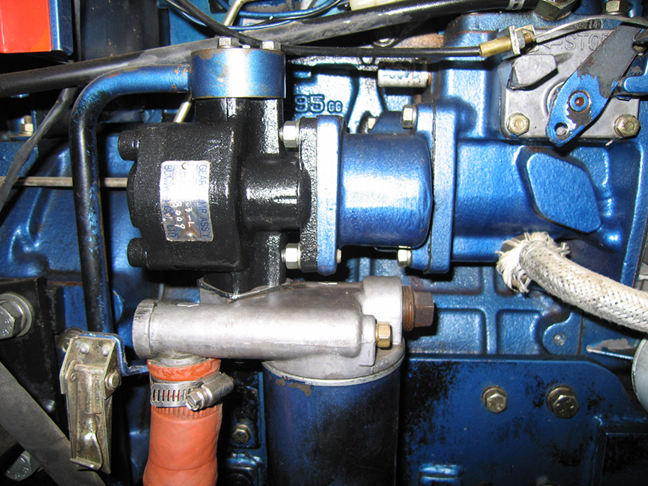

dfkrug, "hydraulic lock" is what I suppose the seller is talking about. I am attaching a picture of the pump. Could you identify which two "lines" I should disconnect? The mechanic did not remove any hoses when he replaced the pump, so how could he have installed it incorrectly?
By the way, this seller is not in San Diego. I finally received a response from him on ebay today in the dispute console, and he contends he listed the ad properly with 32 hours because that is what the hour meter in fact read. No mention that he knew it had more than 32 hours. He also contends the mechanic damaged the tractor and I am just going after him instead of the mechanic. I replied and will await his reply.
The last is a good question, and I am not familiar with your tractor.
Anything that blocks the pressure port of the pump can result in the pump
trying to compress the hydraulic oil. The result is something breaks, or
the engine will not turn over at all.
   / Kioti LK3054 4WD diesel not running #16
The blue colored metal tube that is in front of the pump that curves up and bolts on top of the pump is the high pressure line. The orange flexible tube that attaches by hose clamp to the front bottom of the filter unit is the suction (or return) line. Those are the two lines in question and you can try loosening them. You never want to "run" a tractor with no oil running through the pump but I do not feel it would damage the pump if you loosen the lines to relieve any pressure then "bump" the key to see if the engine will turn freely with the lines loose. It may spit a little oil when you loosen the lines and/or turn the engine over so you may want to put a bucket or other catch device under the pump when you try this.
Good luck and keep us advised as to what happens.

Makes me wonder if the dealer and sellers are brothers or in collusion? Are they both near you and each other? Some people who treat ladies like that just need an attitude adjustment. That happens to my wife all the time and I am sick of it. OK, so you accepted that tractor but it was obviously not anything like the advertisement represented. I hope your claim is granted and at least get your money back. Where are you located in San Bernardino county? (It is big)
BTW, loosening the filter should be like cracking the suction line, right guys? If it hasn't been changed it needs that anyway. If it was me, I would have checked the oil level first, then the hyd filter, then the 3pt linkage to see if it's operating correctly (not bent or something), then check the pump for flow. Heck, could be the mechanic left the "O" rings out of the high pressure line or something?
And what was the reason for it running on 2 cylinders instead of all 3? Did they tell you?

Just wanted to post an update on my tractor saga. Got a bit sidetracked as I've been in the process of setting up a house on my land.
I had a guy installing a septic system over here and he was very tractor savvy, so he took a look at the tractor and actually got it running again. One of the battery cables was loose! He also had the hydraulics working for just a bit. But they stopped again. He drove the tractor around, then said there was definitely something wrong with the engine and it probably needed to be rebuilt. He said the pump was installed correctly and there was enough hydraulic oil. But obviously the pump was a waste of money since it didn't make a difference.
