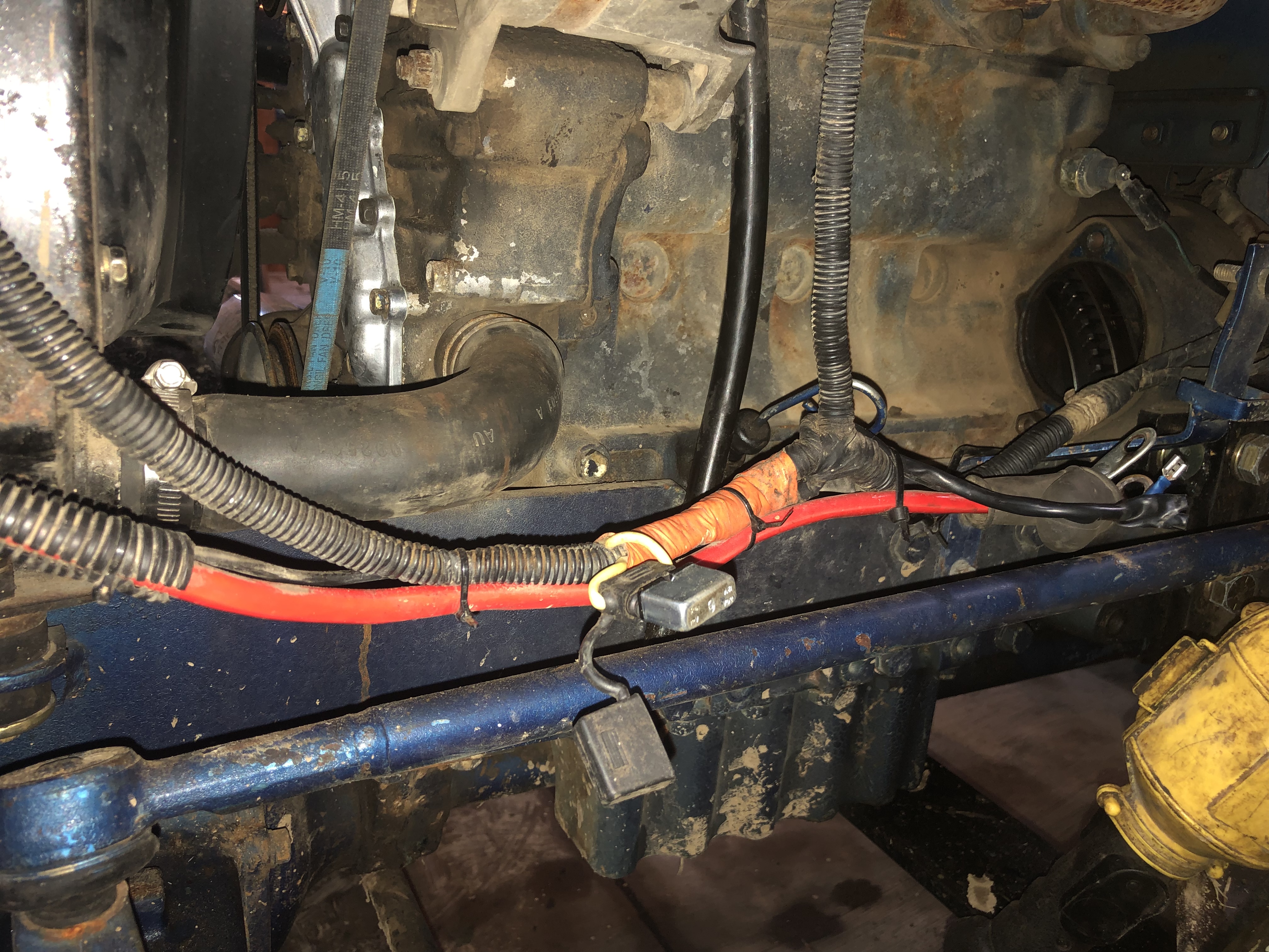

Is this correct?
   / Kioti LK3054 replacement starter #12
That is a Bi metal self resetting circuit breaker. I would recommend checking with your dealer on the proper fuse.
