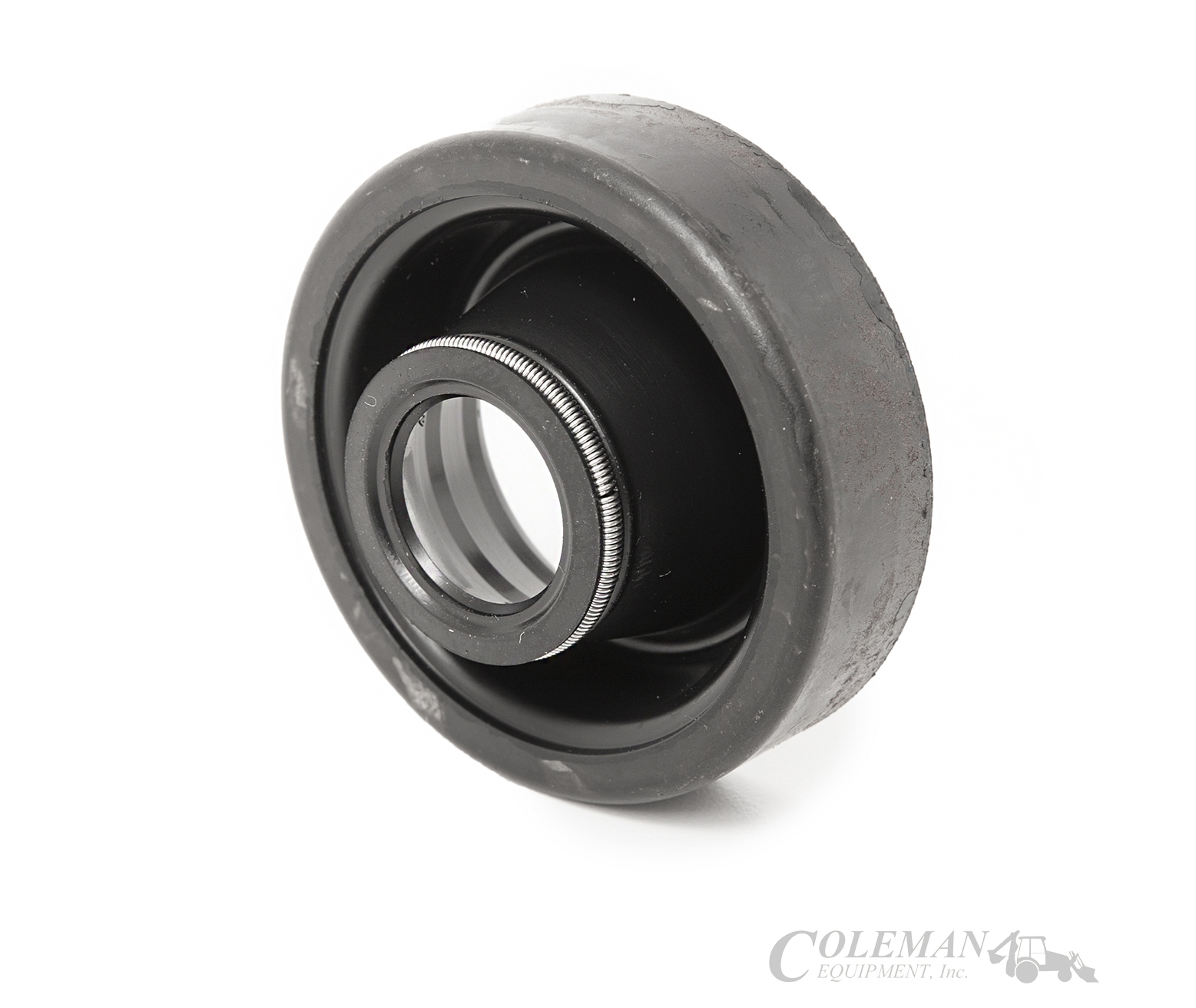

HELP PLEASE!!!! I have a kioti LK3054 tractor. I believe The year model is 1995. I am leaking fluid out of the top of my steering column. My seal is bad at the bottom of my steering column. I would like to order the seal the bushings and the dust cover. Only part number I can find is for the dust seal. I have called several Kioti dealers and they tell me they don't offer that seal anymore. Anybody know the size of the seal or a part number that I can purchase one from?? Any information would be greatly appreciated.

I noted your question is now 6 months ago; however, if you still need information about this problem eMail me at jmont54@earthlink.net. I had the same problem and the Kioti Parts Manual for the LK3054 only shows a general picture of the steering system. I, however, have a tremendous dealer and has gotten me both a breakdown of the steering system as well as part numbers. He discovered the LK2554 had identical steering as the LK 3054 and all gaskets and O rings are available. The LK2554 parts manual gives a complete breakdown of the steering. The seal number is a NOK seal and can be ordered from Finditparts.com priced at $10.00+ each; however, they require purchase of 4.

I had the same issue but I just replaced the bushing and upper seal and have not had a leak since. That was about 4 years ago.

From the post i copied and pasted above, I purchased the Oil Seal and Dust Seal from Messicks. I've torn down column and it's pretty straight forward but I did NOT see the old dust seal when I took it apart. Where does it go?

The seal goes on top of the bushing and just under the steering wheel.
I did not remove the shaft at all from the tractor. I pulled the steering wheel, removed the old dust seal, then the bushing. Then put new bushing, seal and the steering wheel back on. It has been a while ago but that is best I remember.

Thanks for your reply. I believe the previous owner removed it and shoved a really thick rubber washer in the shaft to act as an anti-wobble bushing. He boogered this thing all up but I'm determined to get it back to 100%.... ISH. haha
