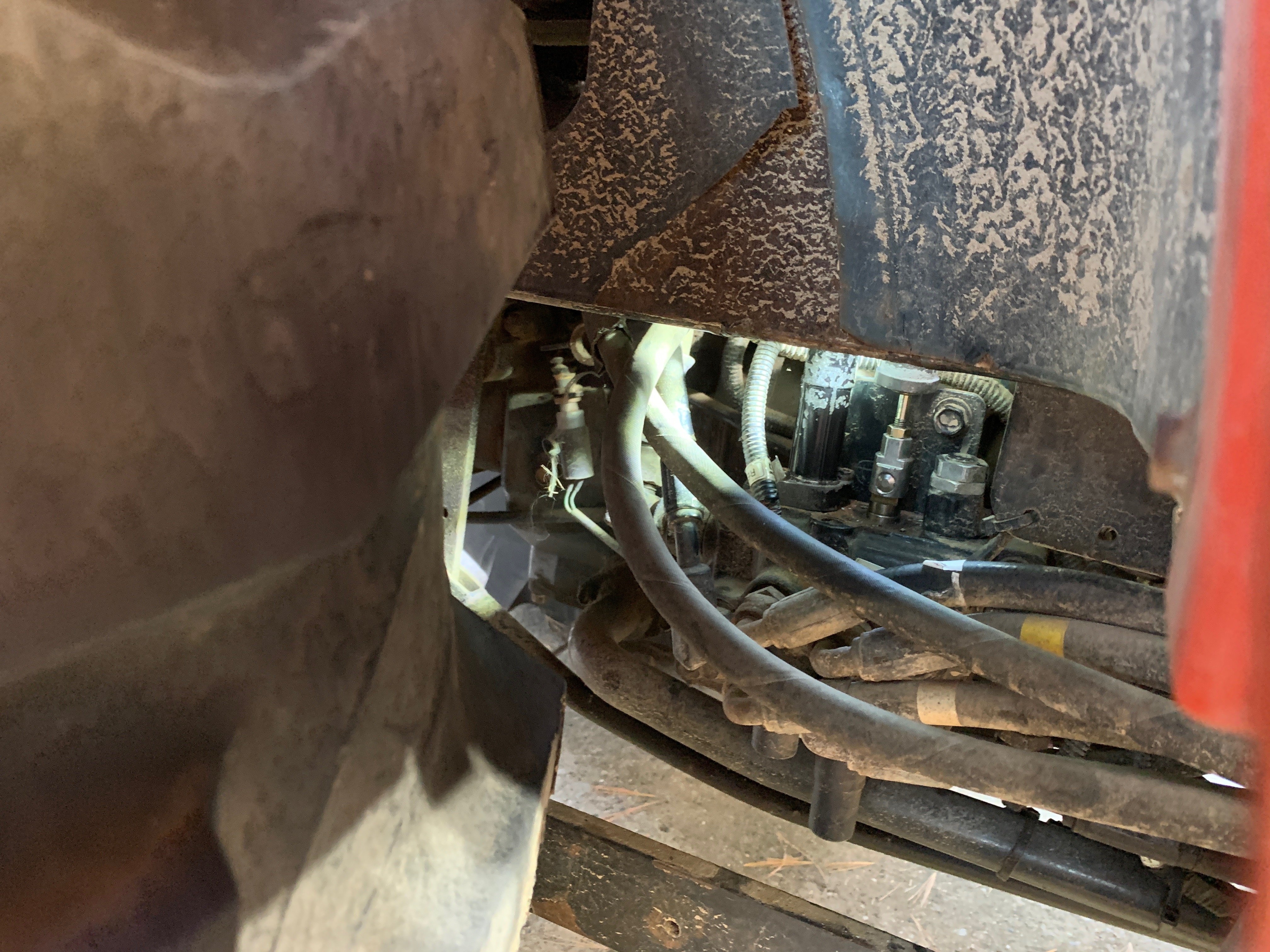

A what? Are you talking about valves in the joystick valve body, the remotes SCV (select control valve) in the back of the tractor, a third or fourth function on the loader, or something else?
   / Kioti Long Spool Kit were to get one?
there is a short spring and cover for the left/right loader stick and a long spring and cover for the Up/down and float. its under the left hand side of the deck.
my cover for the long spool decided to leave the tractor. LOL
   / Kioti Long Spool Kit were to get one? #9

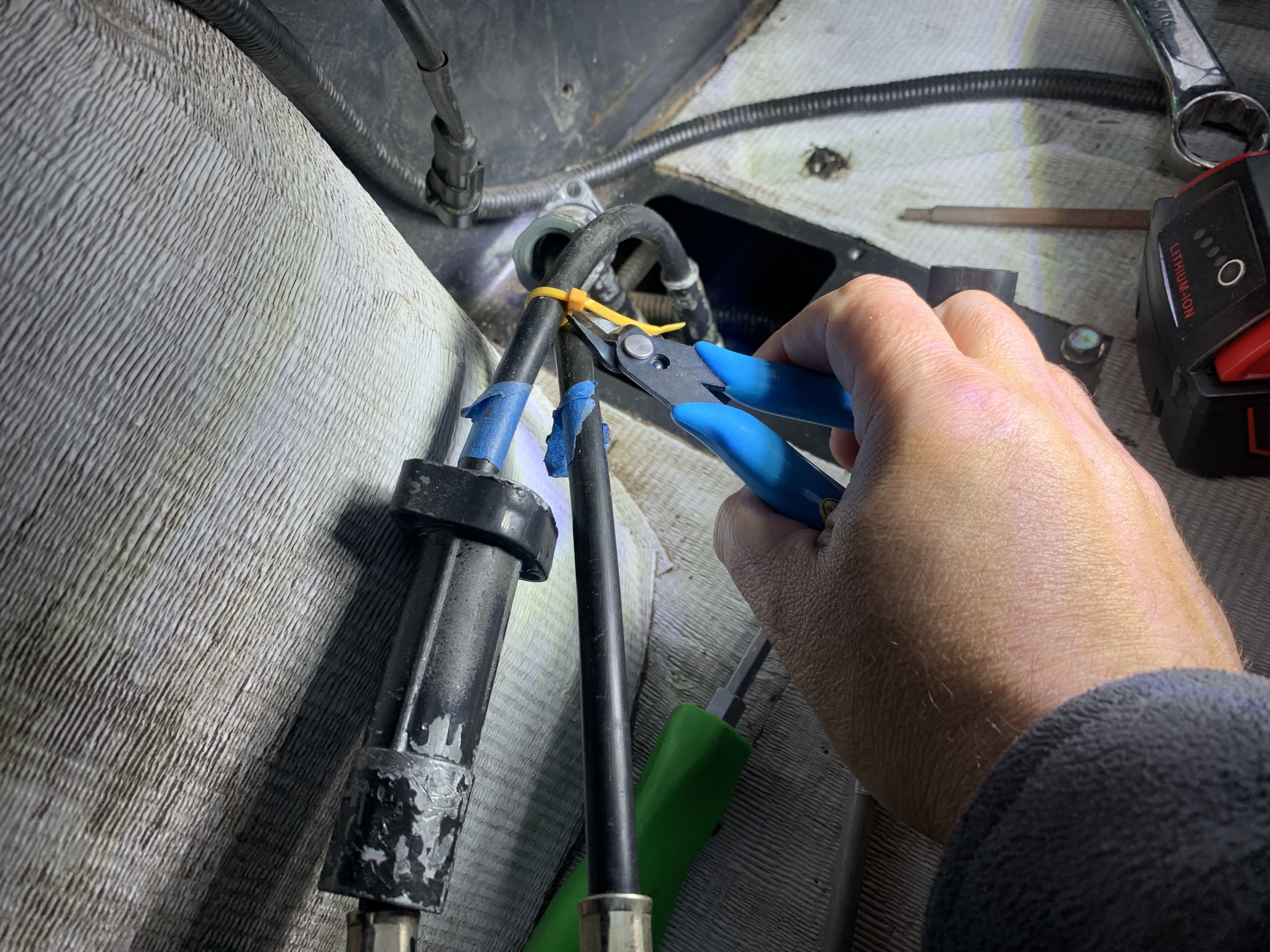

You're talking about the covers that are on the two cables that cannot fall off until the pins on the spool valves are removed?
FWIW, while it will not help you get a replacement cover, here is my tip for keeping those two-piece covers on the cable and up and out of the way.
