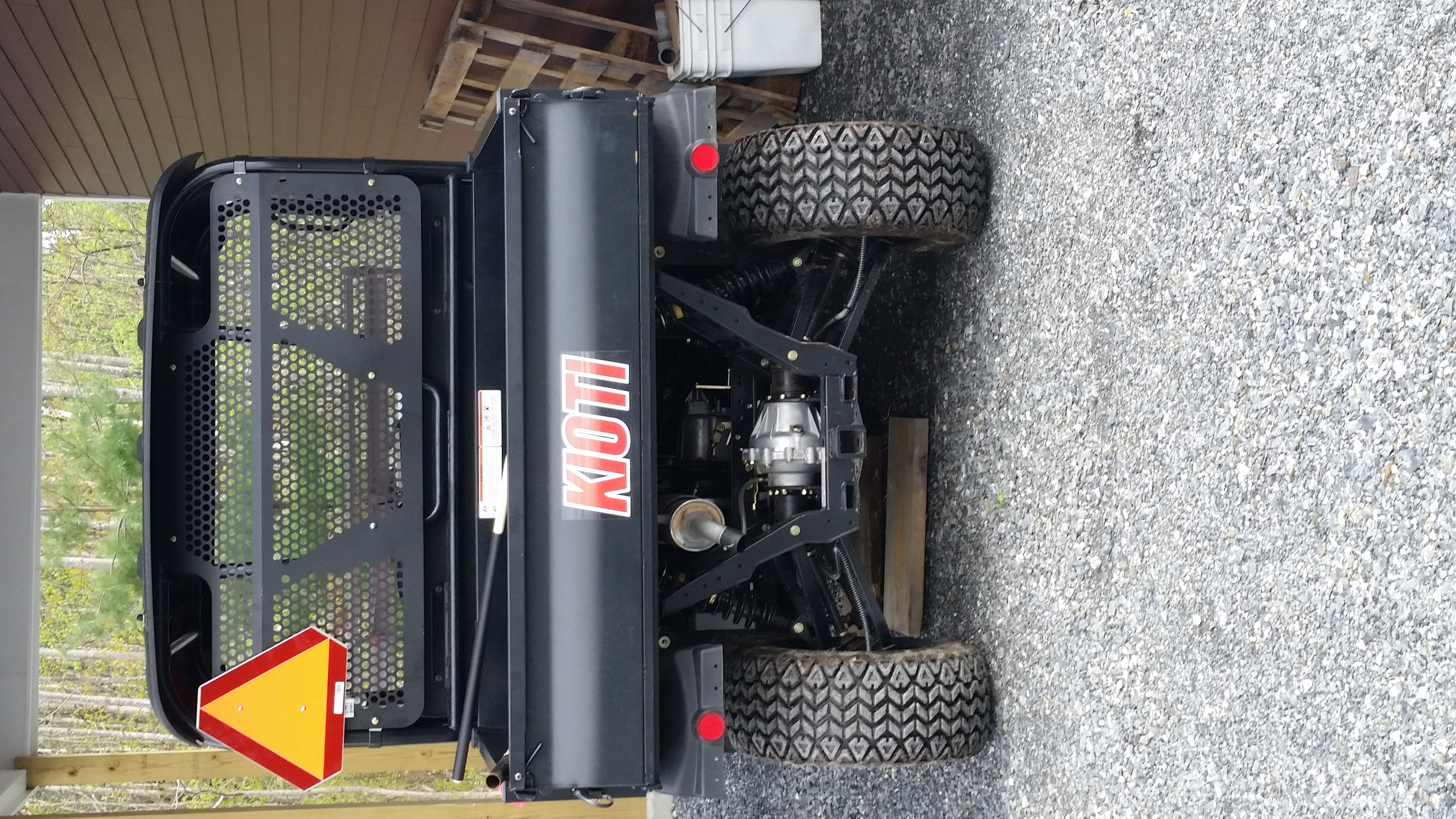

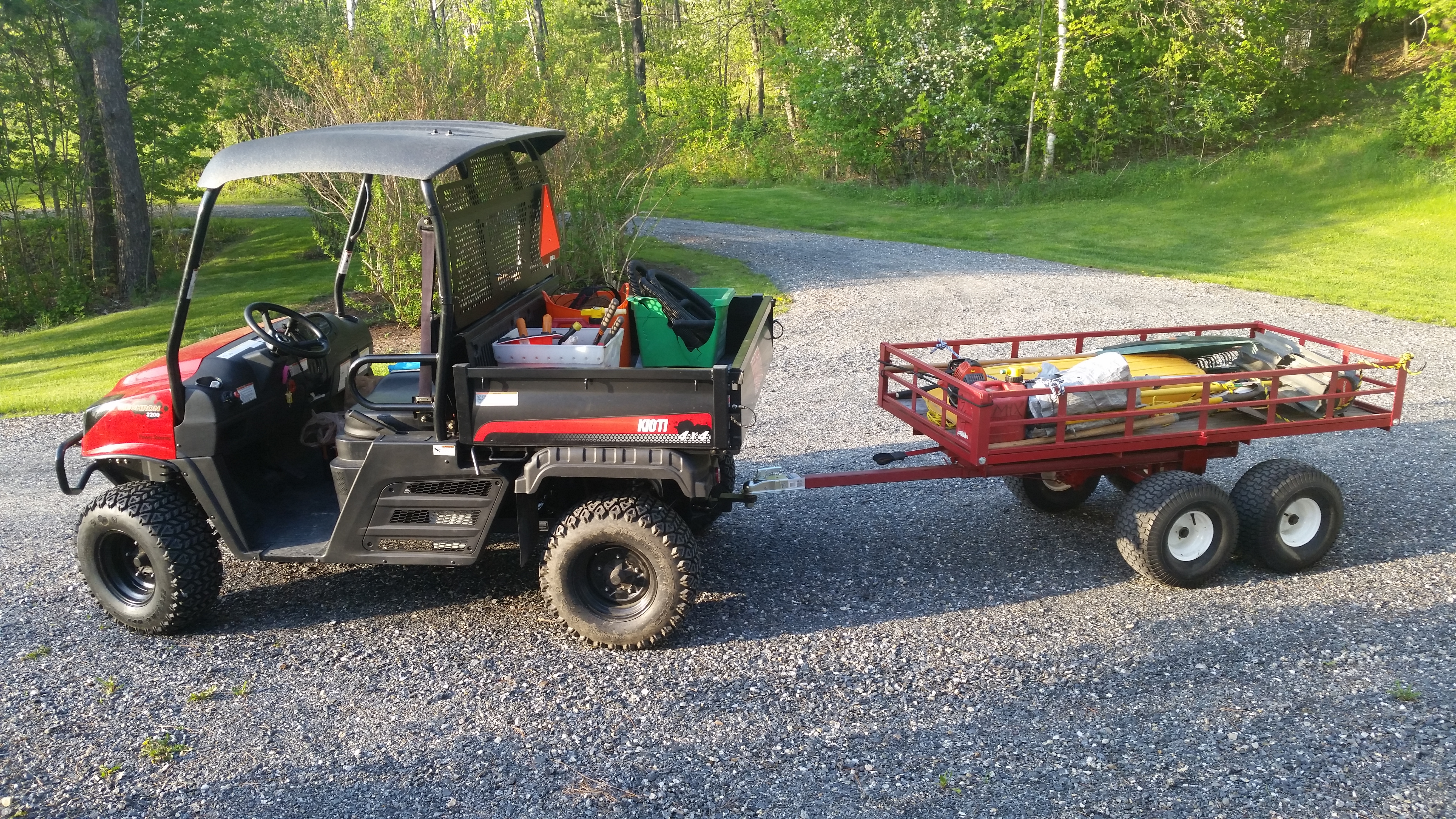

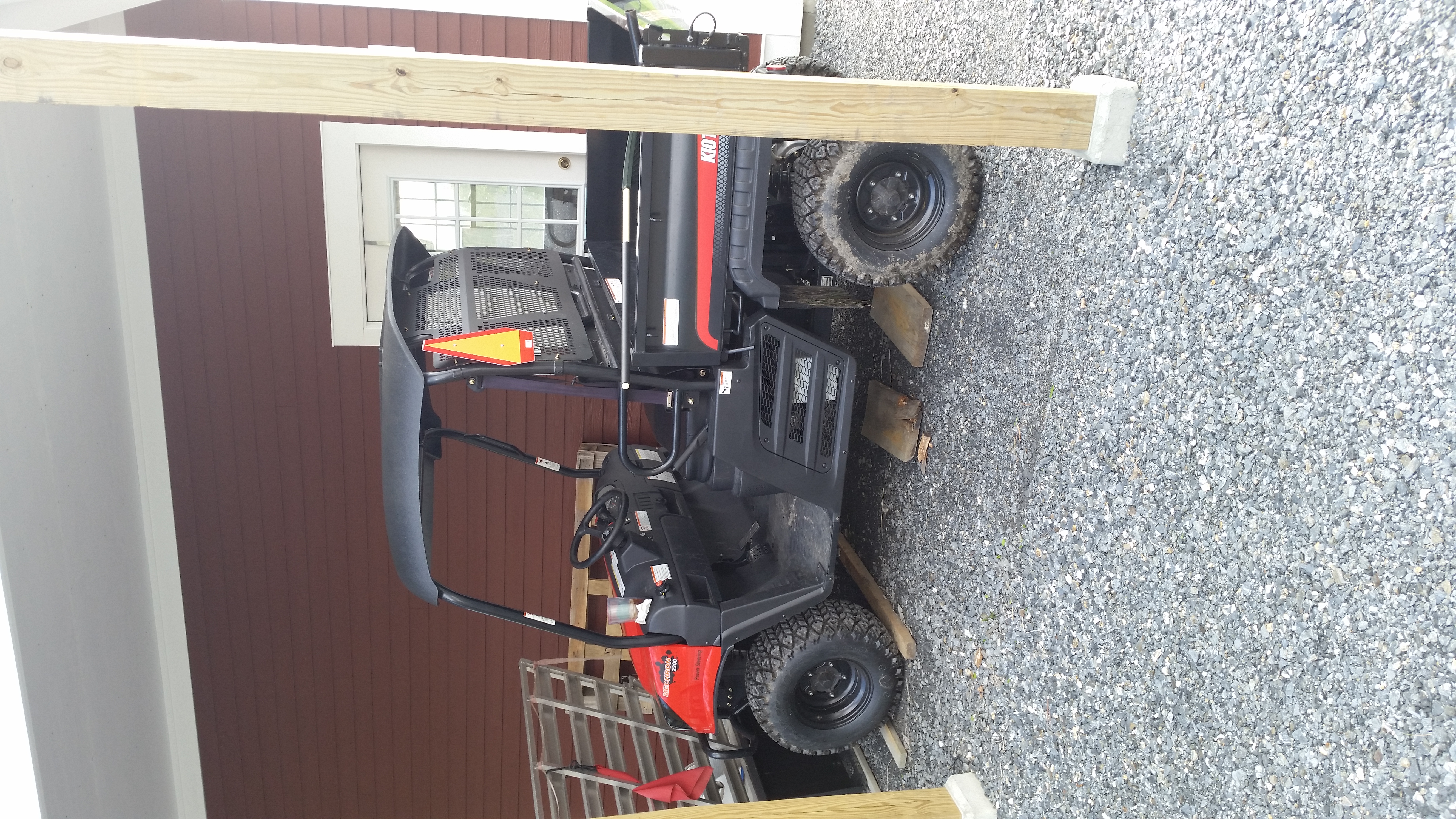

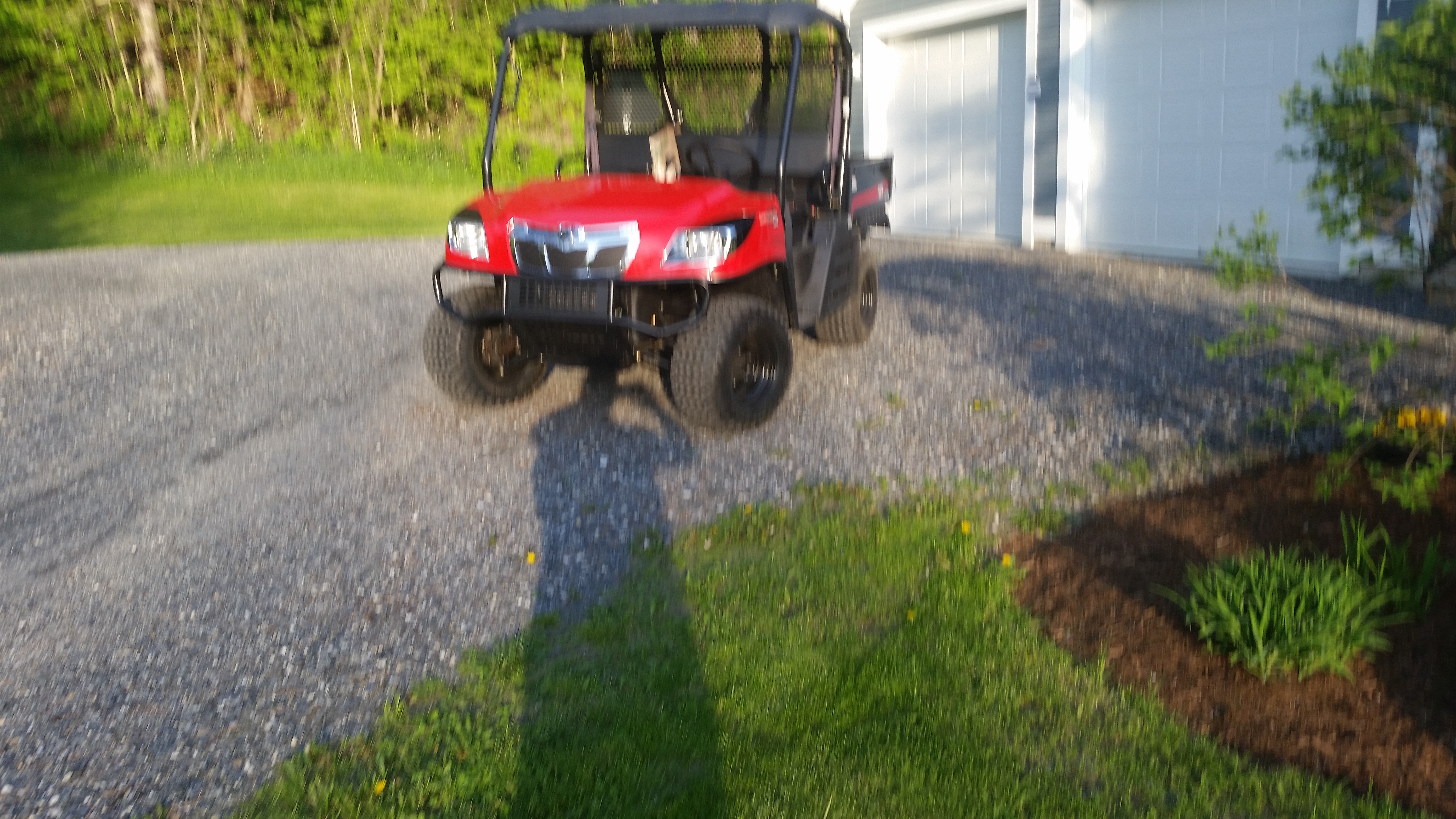

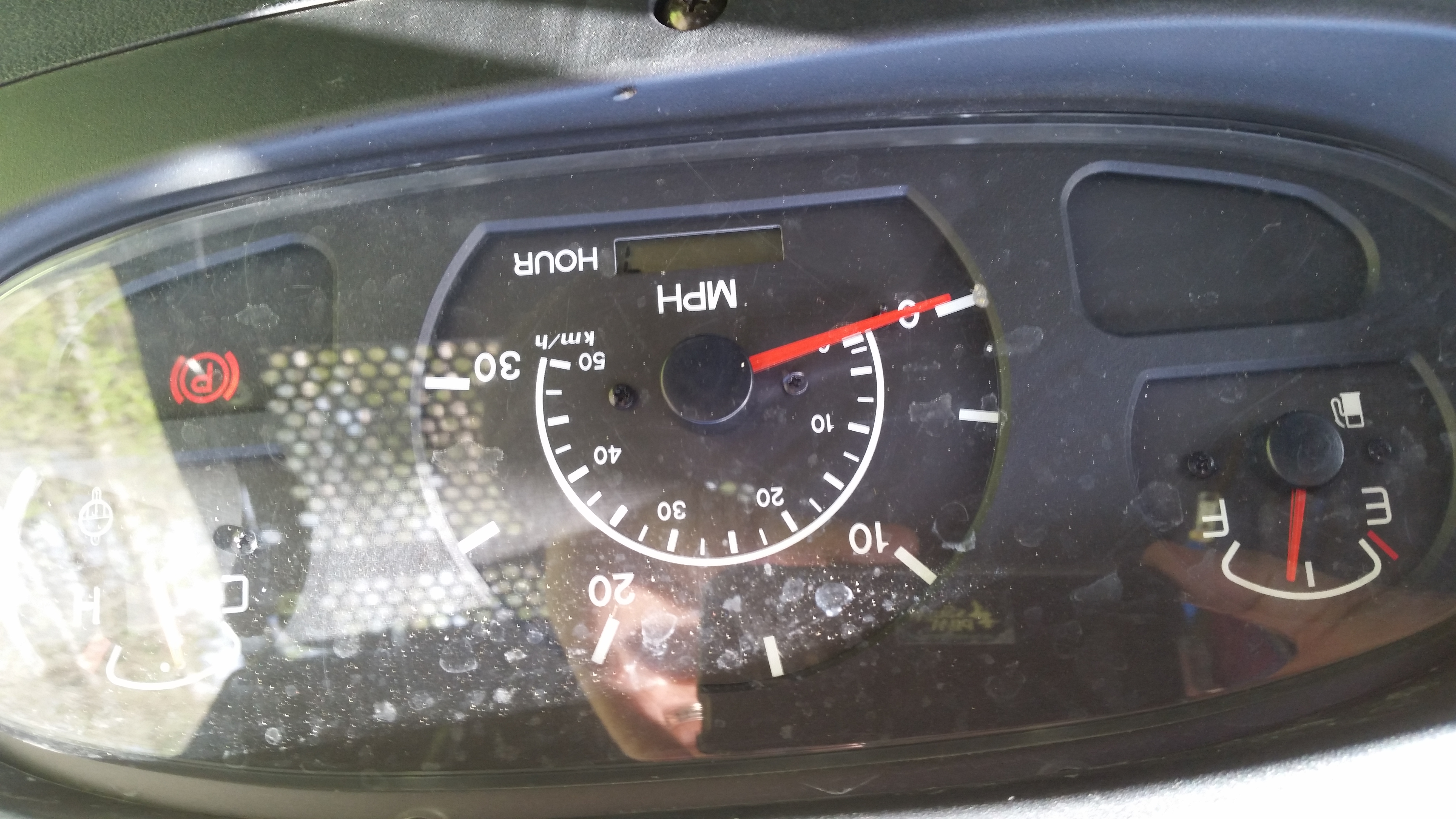

Here are some random pics of my Mechron 2200PS. Enjoy!
