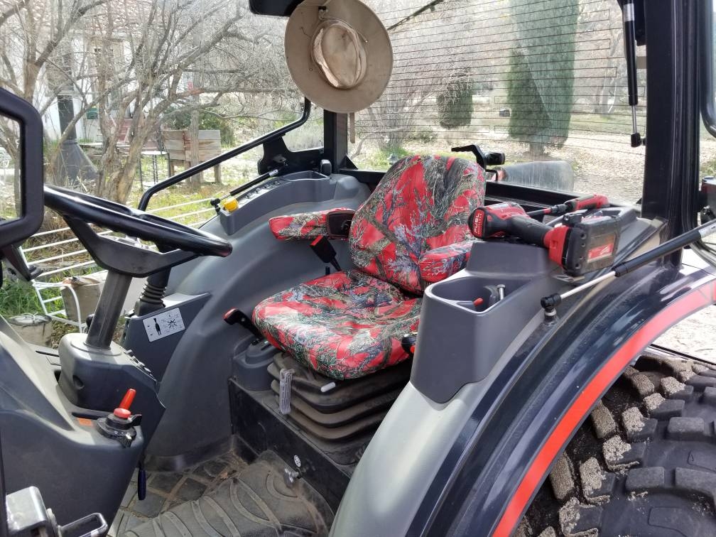

Done. The delicate wires are still not protected though. I should make a better guard for them.
Also received a seat cover for xmas. View attachment 840752View attachment 840751View attachment 840753
