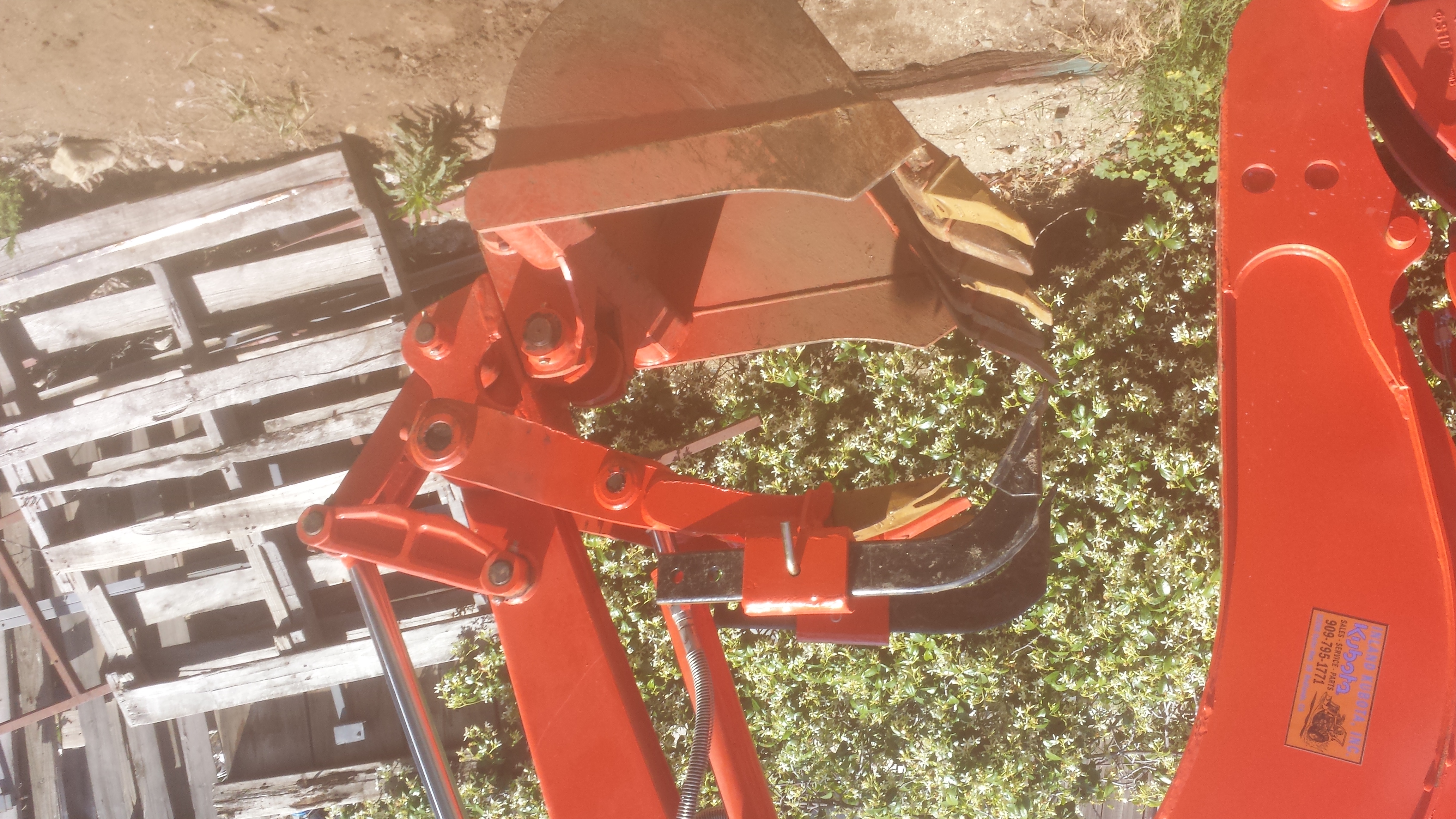

I had the Backhoe and front Bucket added to the order at the time of purchase.
This Tractor Max's my Trailer out but I can transport it just fine.
The Backhoe has surpassed my Expectations on what it has done for me. and the Front Loader has been a Life Saver as well
I have since Purchased an 72" Box Blade and Front Forks from EA and Built a front Boom and modified the Hydro. Thumb on the Backhoe and Added adjustable rippers from the Box Blade to make the Thumb Deeper (it now is like having a small grapple on the tractor 20190525_112740.jpg
