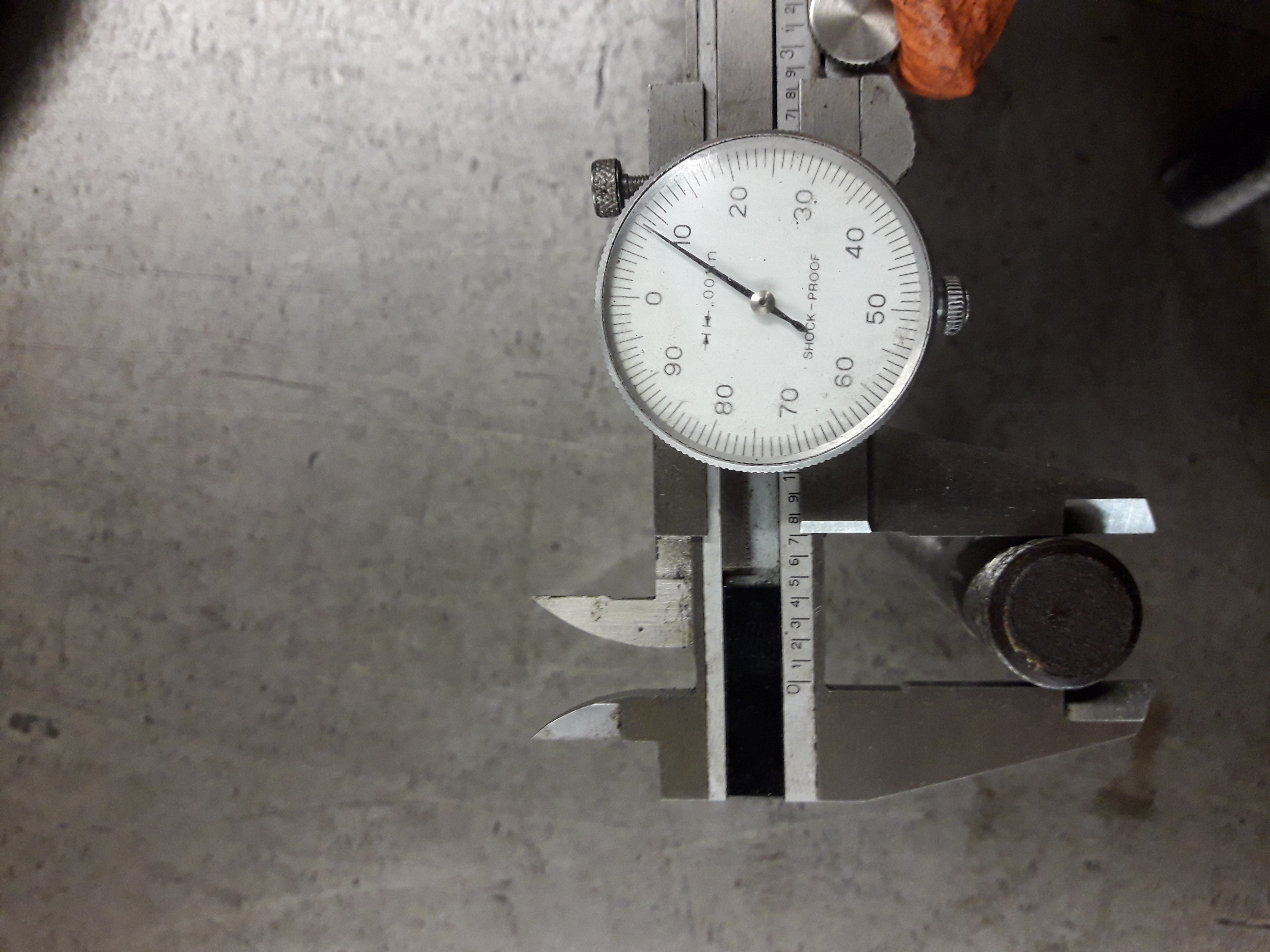

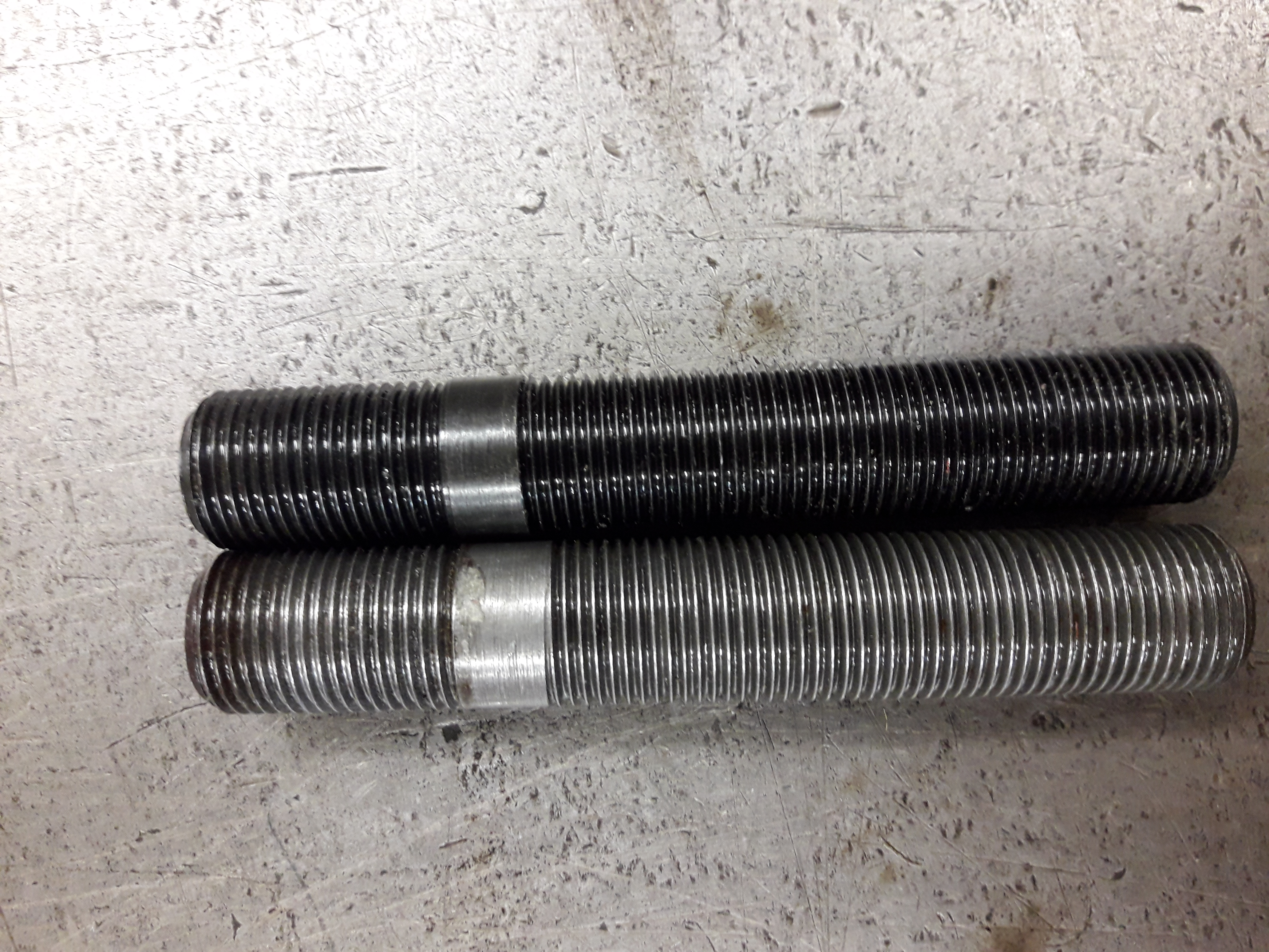

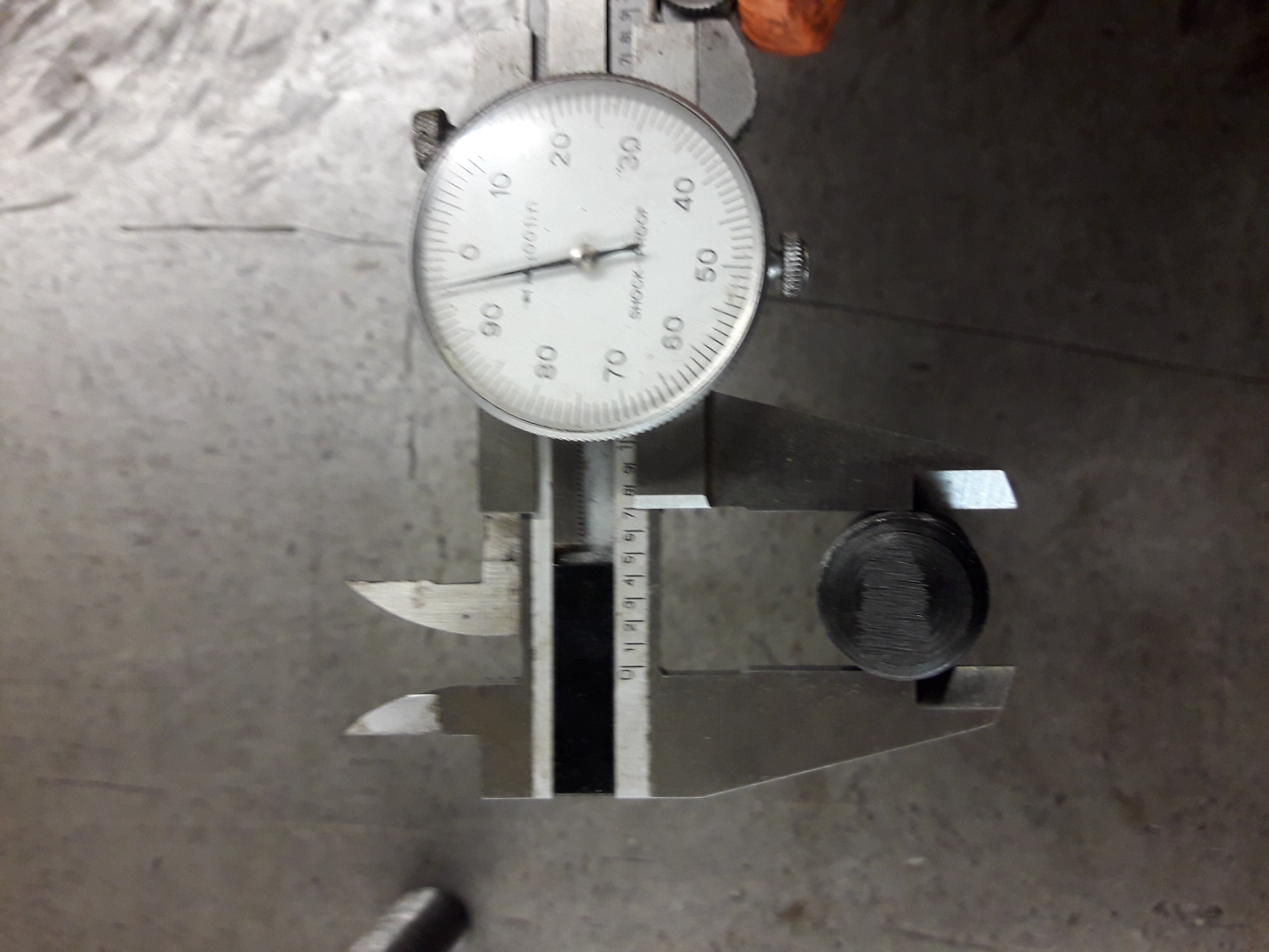

I just wanted to up date this thread. Kioti definitely changed this part along the way. Here is a couple pictures. The picture with studs shows the new stud on the top next to the old stud on the bottom. There is actually a slight difference in measurement between the two as measured with my calipers. The new stud is smaller than the old stud. While threading the new stud in it felt looser than the original stud until it was threaded almost all the way in. These were all factory Kioti studs (T4851-50300) $22 a piece. I replaced all the studs on both wheels then torqued them down in a multiple criss cross pattern increasing torque each time until I reached 210lb /ft as stated in the owners manual. All seems to be good so far.
