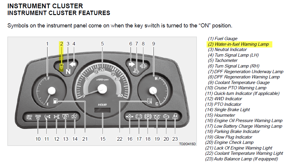

There should be a warning light for water in fuel. My DK4510 has one:
/ Kioti RX6620 check engine light on
Yes my dash has a warning lamp for water in fuel. My dash looks different than above. No warning light for water in fuel was ever on or any other lights on during this process except the CEL. No water found in fuel filter or tank with water detecting paste.
