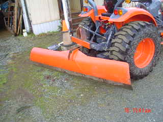

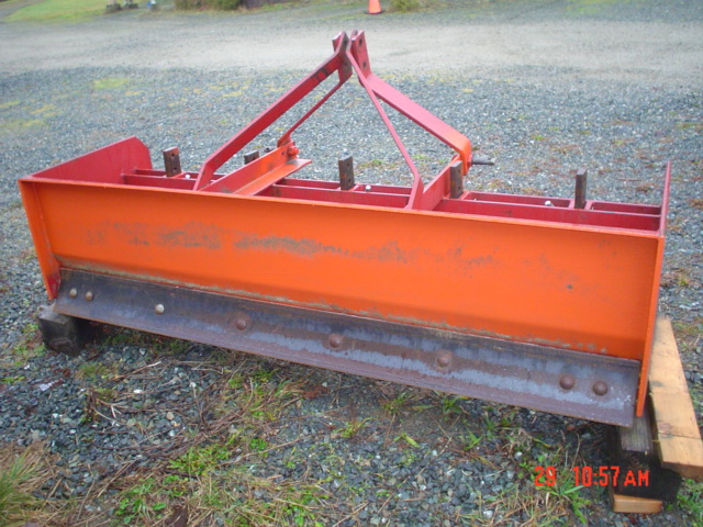

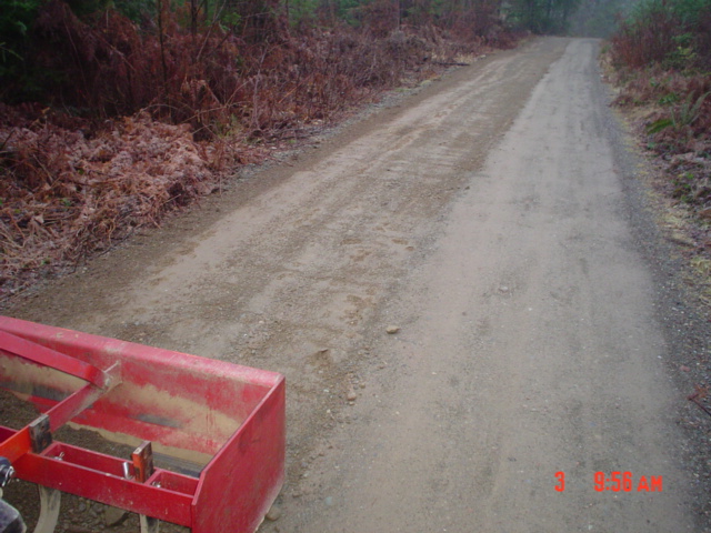

I bought a used 6 ft boxblade that was also red. Was almost new and had been stored inside. Paint looked in good but a bit faded condition. I didn't bother to sand it. Just made sure it was clean and painted it with a rust paint from Home Hardware Building Center. They custom made up the colour and it sure is close to the Kioti colour. I just painted the back mostly to make it more visible if a car came up behind me while grading our narrow windy road which is shared by a couple of neighbors. Also got a used home made 7 ft back blade that looked like it had been painted black but was mostly down to bare metal. This I did give a light sanding to before painting it. I think the trick is to make sure there is no loose paint or flaky rust areas, better to spend a few minutes to sand down questionable areas to make sure your paint will stick.
