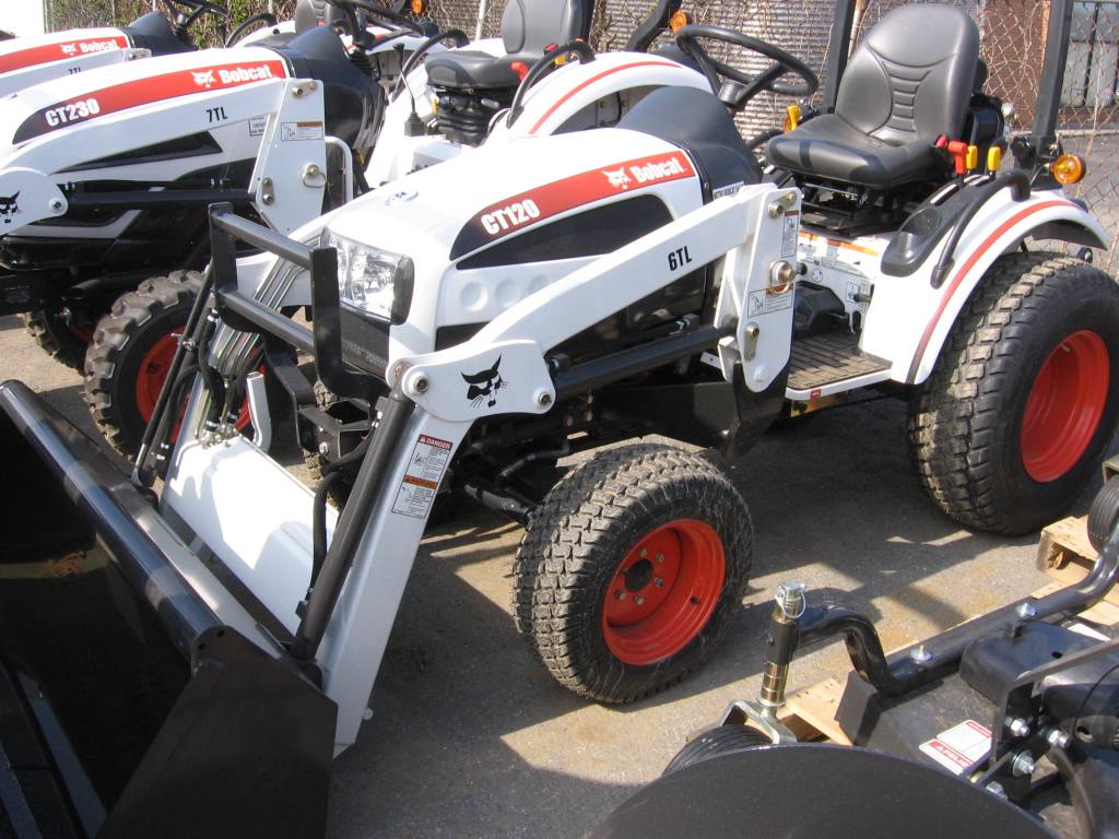

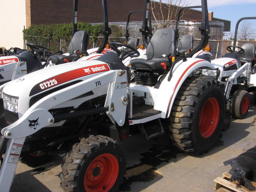

Looking at the pics the bobcat CT120 has a 6TL loader and the CT230 has a 7TL loader
Rhino 6TL = 600lb lift capacity at full height
Rhino 7TL = 1035lb " " "
The kioti loaders:
KL120 (CK20) = 1074lb at max height (at pins)
KL130 (CK30) = 1155lb " " " "
A little difference on the 30HP rigs, but the 20 hp machines have a major differance.

The difference may be due to specs at pivot pin vs mid bucket so both numbers could be correct.

Ed,
Wouldn't 500mm put it about the mid bucket?
Then again.. I'm thinking 600lbs on Rhino's site might not be tractor specific.

Yes, 500mm is essentially the same as mid bucket. I wasn't looking closely enough to see that.
