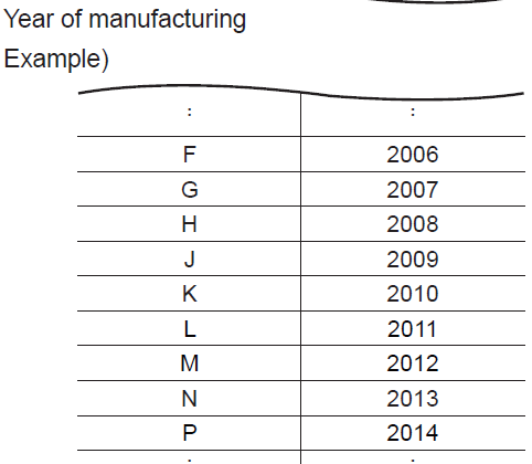

Edit, looked in WM and found this chart:
SO now I am wondering why my serial number starts with X... unless they skipped 'Q' for the same reason as 'I' and 'O'...
That would appear to make sense. Does anyone know if it was Q that was skipped?

"N" is 2013. Just a confirmation of that table.
