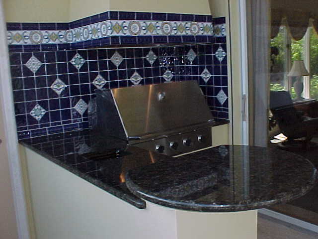

Attached is one of the granite-topped jobs we did, squeezed into a small area.
