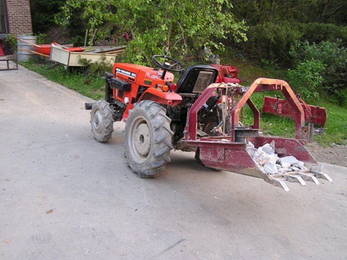

Thats great news! The same problem happened to me and i just decided to weld some extensions and now no scrub...no problem. Heres a pic of my dirtscoop. Sorry for the terrible picture...but hey its a picture....i know i love seeing pictures! /forums/images/graemlins/laugh.gif
