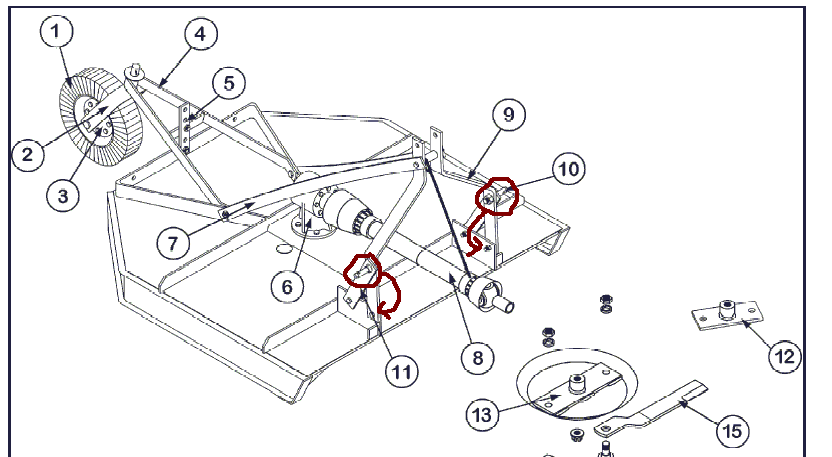

I have a KK 5' blade for my BX and it fits pretty nice but I had to lower the bottom 2 pins in order for the 3pt to lift it high enough. My feeling is the 6' may be a little to big for the BX2200.
   / KK back blade for BX2200
"but I had to lower the bottom 2 pins in order for the 3pt to lift it high enough" <font color="blue"> </font>
How did you do it?
   / KK back blade for BX2200 #6
I relocated the lift pins to the lower bolts holes on the lift arms. I bought two new bolts where the pins went 7/8th inch. You need to drill the holes bigger so that the pins will fit. It is a 7/8th inch drill bit. I also had to put the pins facing in to get it to fit as the mower bracket is kind of wide for a BX2200.
I mentioned I had a 5' cutter but I really have a 4' cutter /forums/images/graemlins/confused.gif. The 4' cutter is pretty much as big as I would buy for a BX2200.
see attached picture.

I do have a 5' KK back blade with no mods and I have a 4' KK rotary cutter with the mods I explained in a prior post. Both implements work great on the BX2200.
