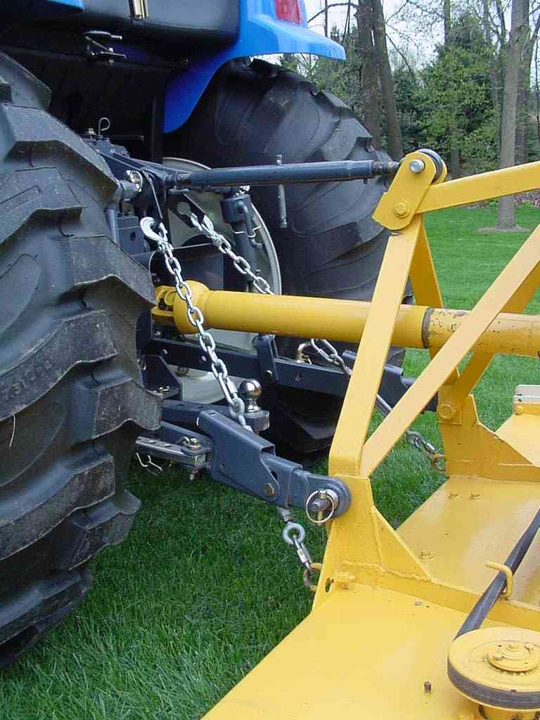

Foggy, go with "check chains". See attached photo. No chain on top, but these support the front so that no matter how low you drop the 3-pt, you limit it to a point you can live with. Although I've shown the picture of my RFM with the chains, my brush hog has the same setup except without the turnbuckles as the required adjustment is less precise. The idea actually came from Woods documentation back many years ago, but I think is still greatly appropriate today unless whatever you are connecting has front caster wheels. Note that the chains go loose when you lift the implement and do not interfere in any way with the operation, except to limit how far the front falls based on how long you make the chains. Give it a try - I think you'll be very impressed and wonder why all rotary cutters are not provided with the same as standard equipment.
