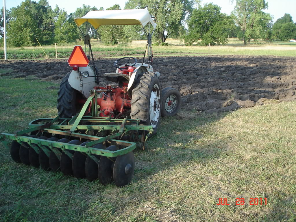

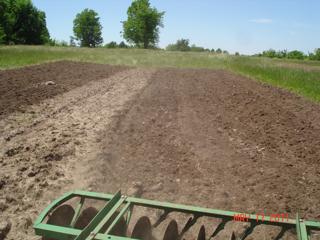

Roger...Roger! :D If you look close at the first picture, you can see the ridge left by the right side rear gangs. I think you're on the right track adjusting the top link. On mine, I adjust it level when down, maybe a crank or so down on the front. Mostly level though. It's half of a JD KBA. Mark
Yours is a offset disc and the KK of the OP is a tandem disc. The oddities of each type are a bit different.
Good eye GW :thumbsup: I still finish up with a drag, a pair of 8' treated landscape timbers, attached with chain one behind the other. Mark
