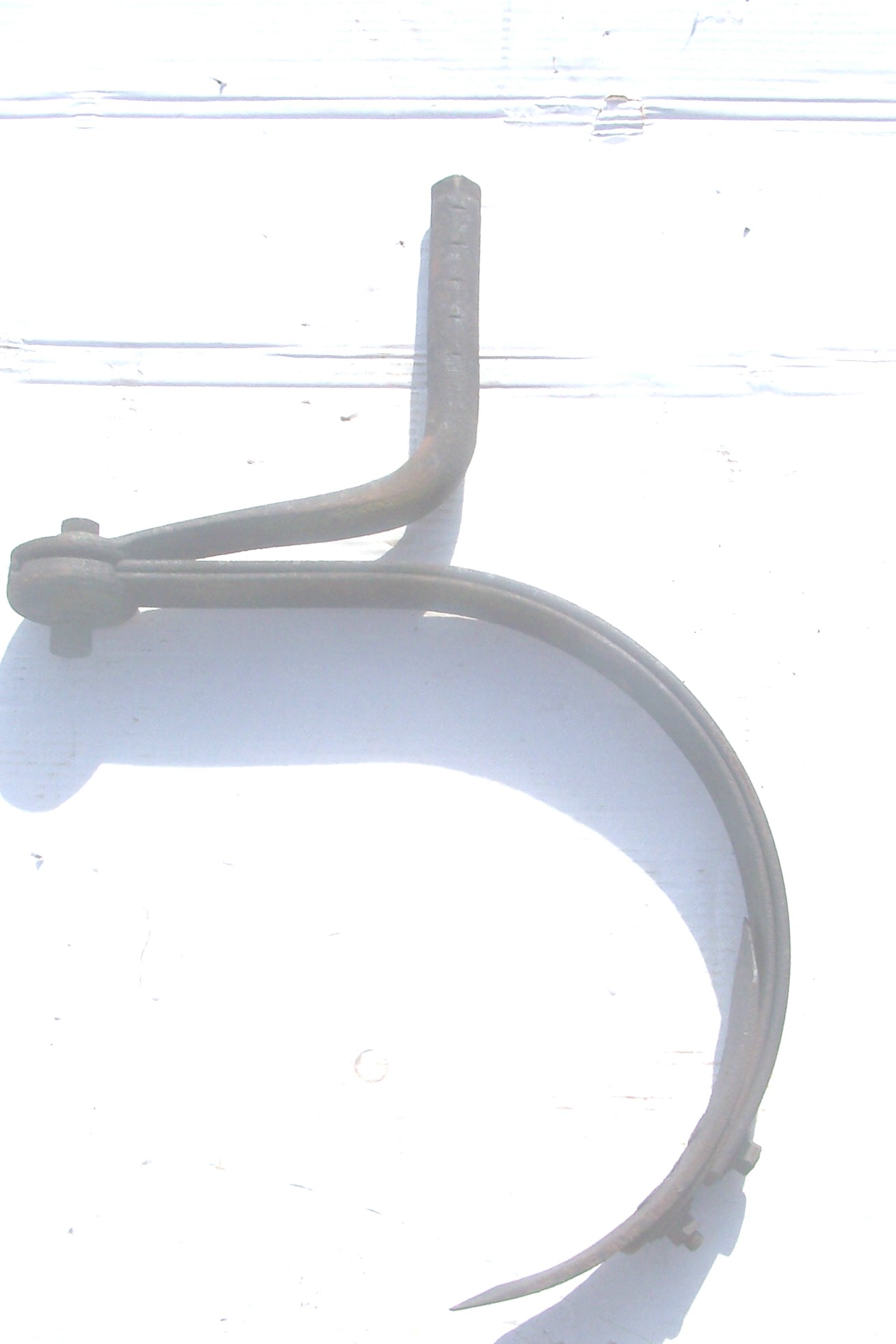

It isn't uncommon for a tandem disc to have a 10" sweep mounted on a cultivator shank located in the center of the frame to take care of the ridge.
   / KK disc leaves hiil in the middle #17
If it was mounted on a spring loaded shank, it would also work in the rock and roots fine. Ken Sweet
