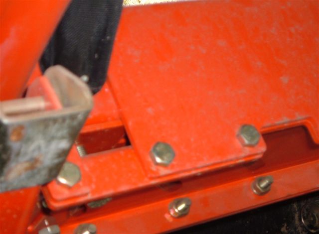

How would I know if a tractors loader has the new re-enforcement?
Photos of what to look for?
KC
/ KL120 loader question #2
My loader has the torque tube re-enforcement kit on it.
In the following picture, you'll see about 6 shiny bolt heads at the bottom of the loader torque tube. These are holding on the "cover" that completely covers the torque tube to stiffen it.
If you don't have all of these bolts holding the cover on there, you don't have the kit installed. Some of the other guys might have more pictures of close-ups and such they can post or point you to. This was all I had handy.

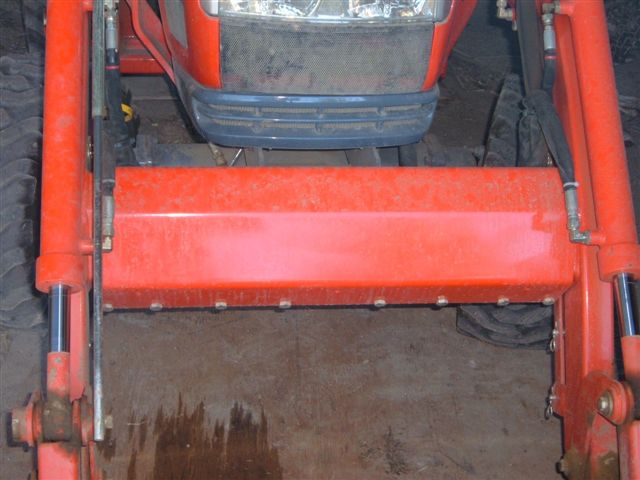

may be these pics will give you some help

Thanks for the photos, are these retro fit and/or they also on new units?
KC
/ KL120 loader question #5
Those are retro fit and could also be found on a newer tractor that had been sitting on a dealers lot, but the new loader KL120B (I believe) which should be found a brand new tractor 2007 models has the torque tube extend through the loader arms. If you do a search you should be able to find some posts with pics.

My KL130B, 2007 model year, is the newly designed loader with the torque tube penetrating both sides of both loader arms and reinforced with 5/16" plates welded on both sides of both arms. I've picked up one side of large rocks (~4'x4'x3' size), est about 4000lbs and beyond the advertised specs for it, with no surface cracking.
