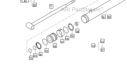

CK08-0100-P Seal Kit, head(No 6~11) $46.83
CK08-0200-P Seal Kit, Piston(No 13~17) $59.10
Yes...I bought both kits. You need 2 seal kits for each bucket cylinder. Yes.....you can buy the seals individual if you want.

I am guessing, based on his other thread and prices.....that the seals come installed on a new Piston. And all you have to do is install the new Piston on the rod.
Personally, for $20 worth of seals in a cylinder....I won't spend extra for a new Piston and to have someone else install the seals on it.

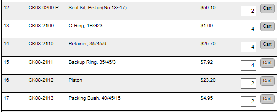

The seals only for each cylinder are $56. You are correct....I could have changed out just the seals only and saved some money but elected to put new piston heads on as well. I didn't have the special tool for installing the seals on the inside of each.
   / Kl130 lift cylinder #19
Note that you do not need that special tool to install the inside seal in the cylinder cap. It is sort of a 3-fingered
pair of pliers. I use 3 steel rods to bend that seal into a heart shape before inserting it into the cap hole. I
would buy those pliers only if I did this often.
LD1 is right: $20 or less for all the seals for most cylinders, from a supplier like Hercules Hyd.

I was looking at just buying the seals. However, I'm confused because to just replace the seals it looks like it should be #13, 14, 15, 17, but if you total those it's far more expensive than the entire seal kit. Mostly due to "CK08-2110: Retainer, 35/45/6: $25.70". That part just looks like a seal, but it's $25 a pop and you need 4! Anyone know what that is or what is needed to just replace the seals?
