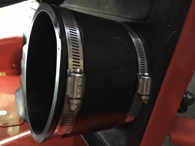

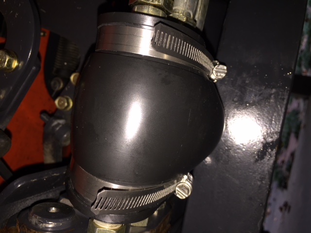

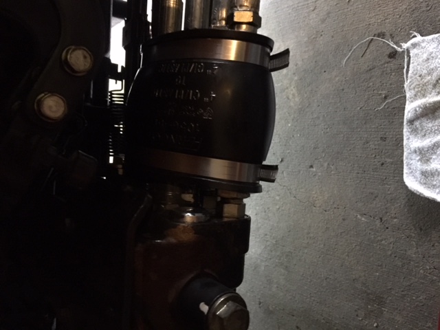

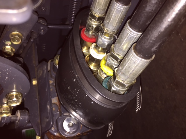

Okay folks - what I have used is a 4" plumbing connection. I have included pics as promised. I bought it at Home Depot. I had to get one big enough to fit over the entire cluster because there is not enough room between the QCs to do them individually as I originally planned. We'll see how this works. image1.jpegimage2.jpegimage3.jpegimage4.jpegimage5.jpeg
I have learned to be more careful when backing up (especially after I stripped all the blades off the cooling fan) but sometimes you are pinched and have no choice so hopefully this will help!
