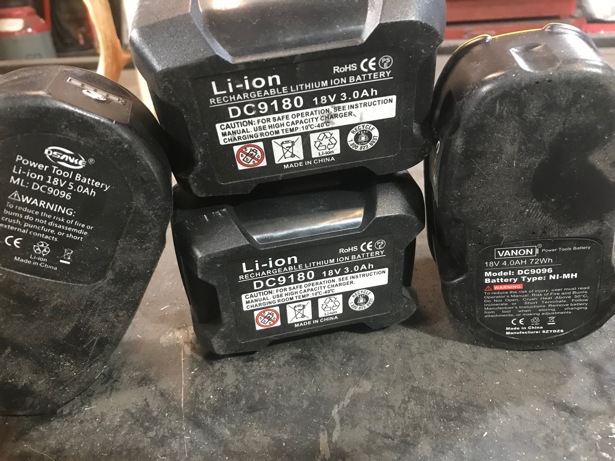

Hello,
I have a bunch of older dewalt 18v tools and was hoping to keep them going for a long time but am struggling to find batteries that will take a charge.
I have purchased 4 different batteries lately as my old 10+ year old original dewalt batteries fail. But these are knockoff batteries since dewalt no longer makes the old style or I would just purchase more of those.
I have 3 of the Dewalt 9310 chargers which are good for all types of batteries. All have the same result with these batteries.
After putting the new battery on the charger after a few seconds I get the fast flashing light which indicates "replace pack". I tested voltages as seen in the pics, all are showing 15-20v.
I am not sure what to do at this point and figured you all might have an idea since many folks still have these older tools. Thanks for your help.

I have done quite a bit of that. Most were about getting the voltage up to a certain point so they would take a charge, but these all seem to test high enough. Most I saw were for batteries that had dropped below 5v and needed a boost just to take a charge.
I'm thinking I should just try a knockoff charger, maybe the dewalt chargers are the issue.

Update,
I went ahead and purchased one of the knockoff chargers from e-bay and it works! I don't know why but the factory dewalt chargers will not charge these new knockoff batteries.
I did see the adapters. That's not really an option IMO as by the time you buy new 20v batteries, chargers, and adapters you might as well just upgrade the tools and forget about 18v. That just does not pencil out for me.
I also checked and Batteries plus was about $50 per battery by the time it was all said and done. That may be an option to consider but you can buy these knockoffs for $20 or less so that's also significantly more expensive unless they last twice as long.
In the end you can keep your 18V dewalt tools running on the knockoff batteries and chargers for the least amount of $. You just need to replace the factory chargers.
