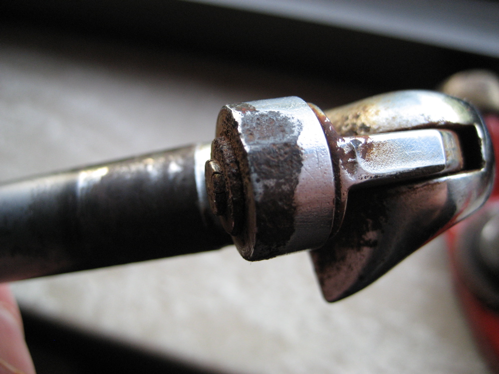

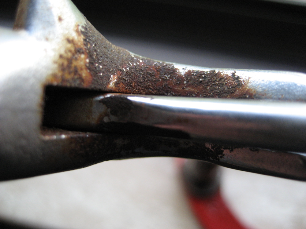

#1 is rusty/rough area in bill hook crook and #2 is wheel on back w/ lots of flats & rusty spots. I hooked the baler up Sat morning and threaded it.

Looks like the billhook and finger were ok. Heel cam wheel may have to be filed to round out the flat spots. BUT:
My guess is that the adjustment tension was lost due to a rusted spring or the nut just walked off. Check to see if there are now double nuts or a cotter pin and a castle nut at the adjustment location.
See attached image. You can still stick a rod down there to see what the finger opening tension on both billhooks is.
Save those parts, they will live to see action again someday !!!

I know mine won't tie if there is much rust, the twine will hang on the rough patch. Replacing solved that for you I guess!

Yes, changing the billhook solved the problem and Im sure it was the rust which caused the hangup.
