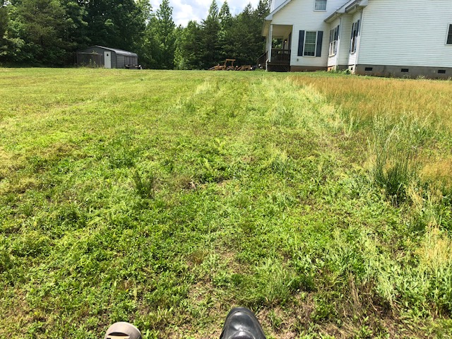

Hi guys. I am looking at getting a new zero turn. I have a TimeCutter 5000 for the last 8 years. Still does ok, but the cut sucks in my opinion and I am getting ready to be mowing an additional 2 acres so we are talking up to about 5 acres of mowing. If you look at the picture below, take note of the lawn on the right and then take note of the grass looking forward. With lawn like you see on the right, the cut looks like what you see looking forward, I practically need to mow twice. This is with a brand new set of blades. In fact those are gator blades after several failed attempts using factory blades. My only other recourse is to mow so slow I cannot stand it. My time is valuable like everyone else and I dont always have time to mow at 2 MPH or mow twice. I want a mower that could breeze through anything you see in that picture (or worse) and do it at speed and practically never miss a blade. And I am willing to pay for it.
That said, and for you guys that cut grass for a living, knowing what you know now based on experience, what mower would you buy based on what I listed above?
Here is a pic I took last year
If you want to cut fast heres my recommendation:
1. Get a good quality commercial ZTR like a Kubota ZD series.
2. Dont cut wet grass
3. Keep your deck clean. If you are getting stripes its because your deck underside is clogged with clippings. Scrape it off regularly to keep the flow going.
4. keep your blades sharp.
5. Cut your grass more often, especially when its growing fast. You are going to cut at 18kmh and save time so more often is less an issue.
6. Always blow the swarf of grass clippings onto the cut area. Dont keep recutting clippings.
7. If its still a problem then cut a second time at right angles to your previous cut.
8. Every other cut alternate your cut path at right angles to the previous cut.

Hmmm...so there痴 really nothing that would take say 6 grass and take it down to 3 or so in a single pass at speed? I admit, sometimes I stay too busy to be able to cut grass every week and that痴 how it gets to that 6+ inch height. I guess sometimes it is 8 inches of grass. I was under the assumption that there are mowers that could do it you just gotta get something high end. I mean if I could do it every week, my TimeCutter would have no problem. I can cut grass at speed with not much of an issue if it is not too tall to start with.
Its actually not good to cut that much of the grass off...I heard it can kill your lawn by introducing fungus and diseases.
