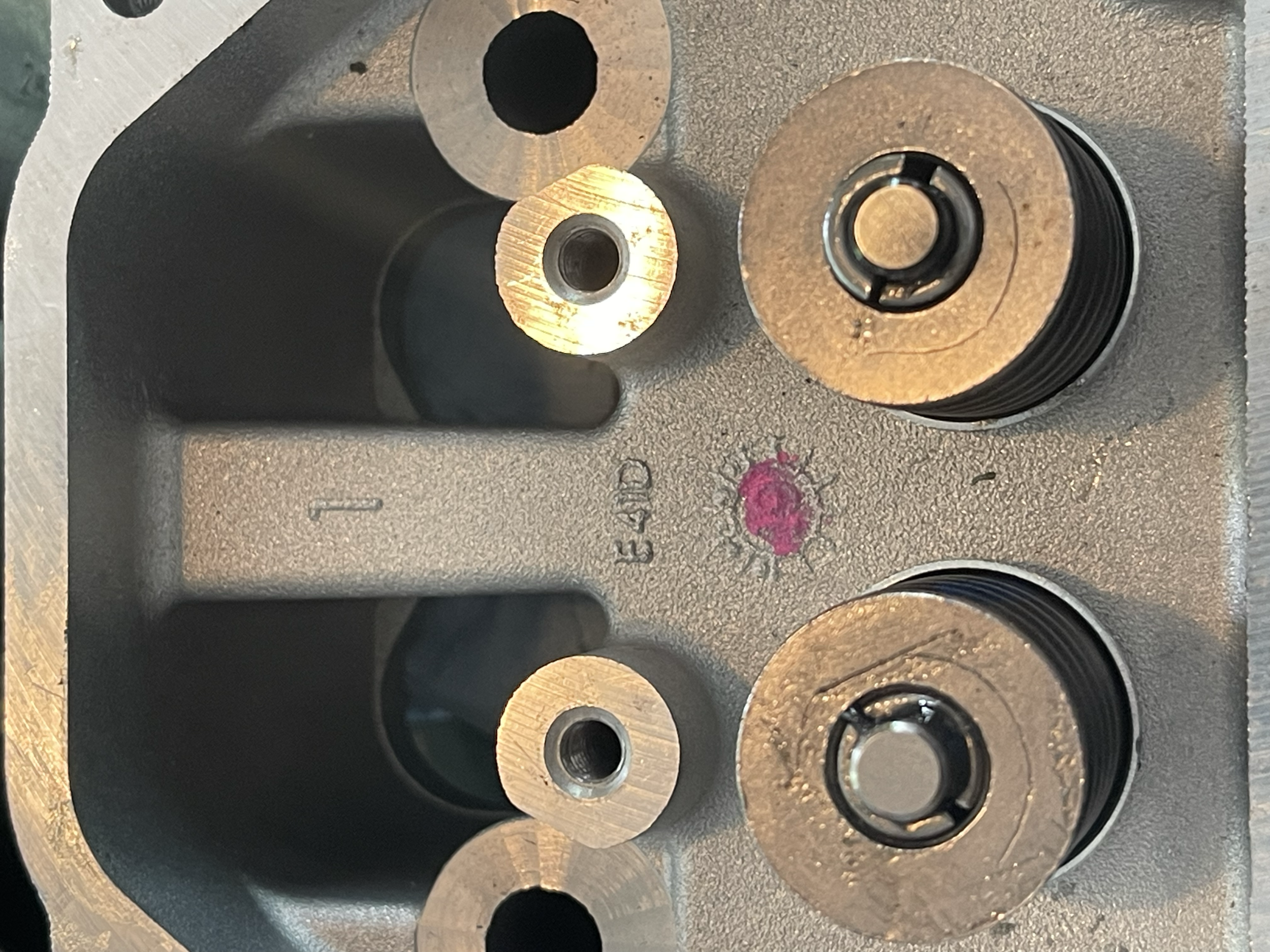

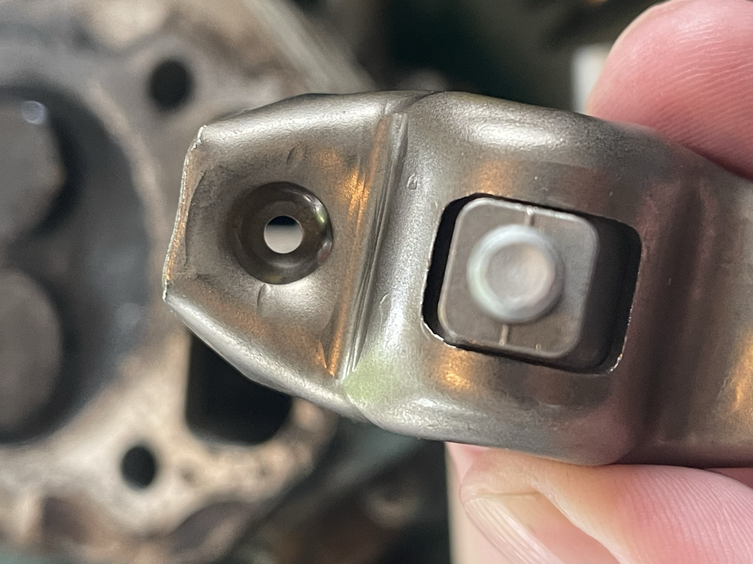

Hi all,
I was watching a YouTube video about this engine and they talked about how there's a little depression in the cylinder head where the bumps on the rocker pivots go, and showed using a wrench to twist the pivot while torquing the bolt so that it sits correctly in the head and stays aligned.
I am just building up a new cylinder head, and my pivots have the bumps (either side of the bolt):
However, the head is perfectly smooth, with nowhere for those bumps to sit:
How should the rocker arm pivots be installed so that they don't twist around? What is the method used to correctly align the rockers?
FWIW, I grabbed the old cylinder head and it didn't have the depressions in the head either. Given how it practically fell apart as soon as I took the head off, I'm wondering if a twisted rocker pivot is part of the reason my push rod bent.
Thanks!
Kent

I have always just eyeballed the alignment and torqued the rocker bolt to spec. the older Commands had a trough that the rocker sat in to keep it straight.

FWIW, here is what I'm talking about:
I don't have the slot, so looking for what I should be doing instead.
   / Kohler Command CH25S rocker installation #6
I saw what he did there in regards to locating the rocker and securing it. That looks fine to me. There's give there but I suppose one could get a thin straight edge across the square base of the pivots and they should be aligned. I looked down for a bit and then noticed he was using RTV, kinda lost me there. So I didn't really watch more. Bleeding the lifters I hope?
Ah, that's a good idea. So the two rocker pivots should be parallel? Or is there a slight V to them? Looked like the latter to me, but I'd also prefer something more precise than "well, that seems about right".
As far as the lifters, I got new ones. Nothing to bleed. Local dealer's head mechanic said *not* to soak and bleed, but just to install them dry.

Just popped the other valve cover off again for a look and the rocker pivots on that side are circular. There’s also a slight V between the rocker arms.
