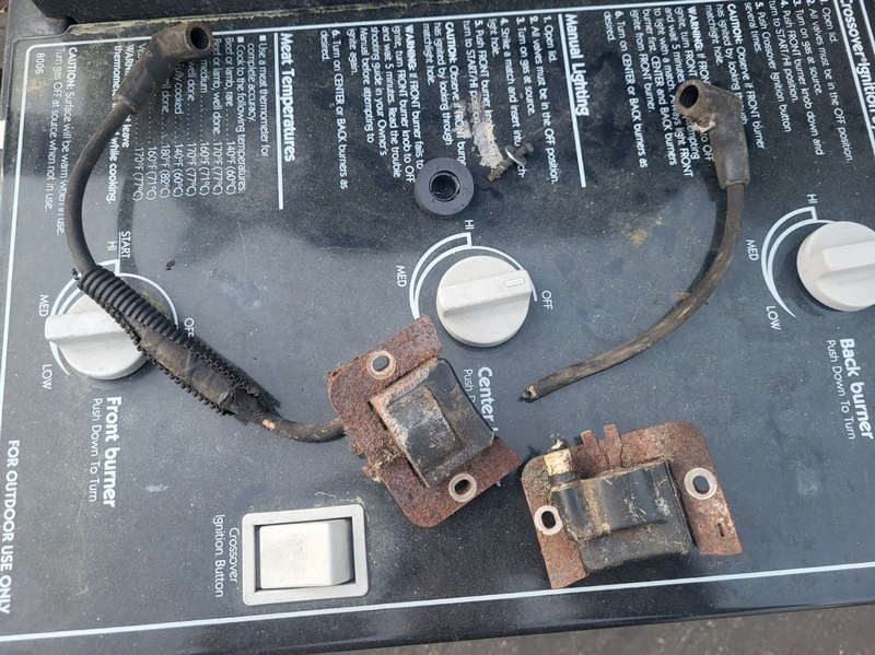

So, the other day someone lists a curb alert CC LT1046. It has the Command 23HP V-Twin. I jump on it and bring it home. It ran and I thought pretty well, but it didn't seem to have as much power as I expected. Anyway, the next day, I take the shroud off and find it jam packed full of leaves, grass and dead mice. I spend an hour pulling poking and vacuuming the junk out of it. I iImmediately notice the left spark plug wire is completely severed, in fact the damn mice ate a good inch out of it since it was too short to even touch the ends. Other wires were stripped or exposed. I ordered two new coils and installed them. Now, it runs so nice and smooth compared to my single cylinder. I now am seriously considering to keep it and sell my LT1045. The LT1045 has 125 hours on it and the LT1046 has 183 hours so neither motor has been well used and should have many years left of life. I just love the smoothness and power of the 2 cylinder. The LT1045 has a 42" deck and the LT1046 has a 46" deck. Seems like benefit, but my yard is not that big with probably a little over 1/2 acre of mowable area and there are trees and other obstacles which makes the smaller deck a bit more desirable.

wow, that is about the worst case of mice nests I've ever seen.

I've seen engines ran like that. It overheats the engines, eventually destroying them. I bet I pulled over a hundred mice nests out of engines and under dash areas, its really important to keep the head fins clean especially on air cooled engines. Great pic there!
