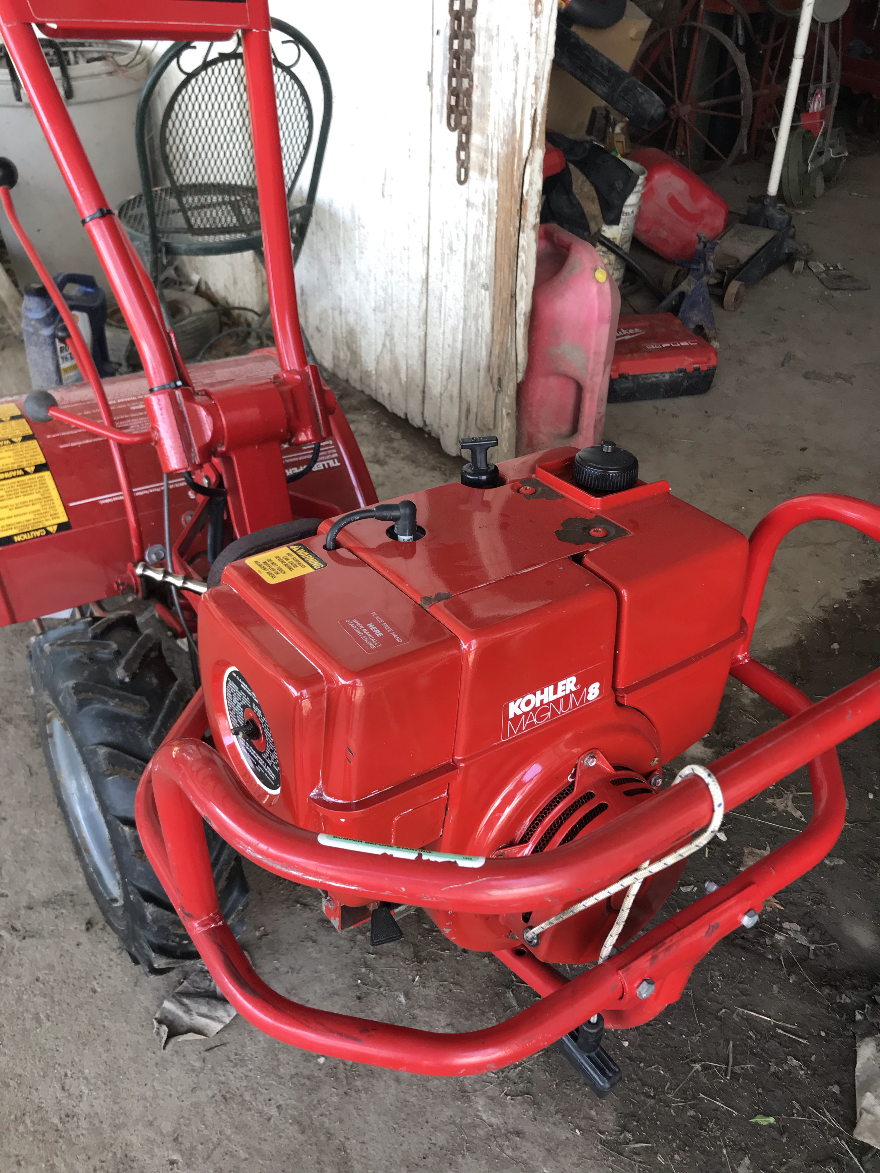

I have a mint Troy Bilt 8HP horse tiller that I bought new in 1992.
Last year it started to kick back when I used the recoil to start. It would pull the handle out of your hand. It finally broke the recoil so now I wrap the rope and start the old fashioned way. I have installed a new plug. Checked the valve clearances which were ok. I also pulled the flywheel to inspect crank key. All was OK. Of course a recoil for the magnum series are no longer available. Give me some ideas guys. I’m using it but no recoil is available for the M series.
Thanks for any help
   / Kohler M8T engine kickback when starting
#2
Here she is.

I don’t want to fix the recoil until the problem is fixed or it would ruin another recoil. This recoil is in bad shape. The plastic spool is broke. I think the spring is ok
   / Kohler M8T engine kickback when starting #6
The cam has a decompressor that reduces engine compression until the engine is at operating speed.
(it actually opens one of the valves enough to reduce compression)
There is a VERY good chance that the mechanism (located on the camshaft) has failed.
I pulled the pan and it appears ok. I do get some compression relief when cranking.

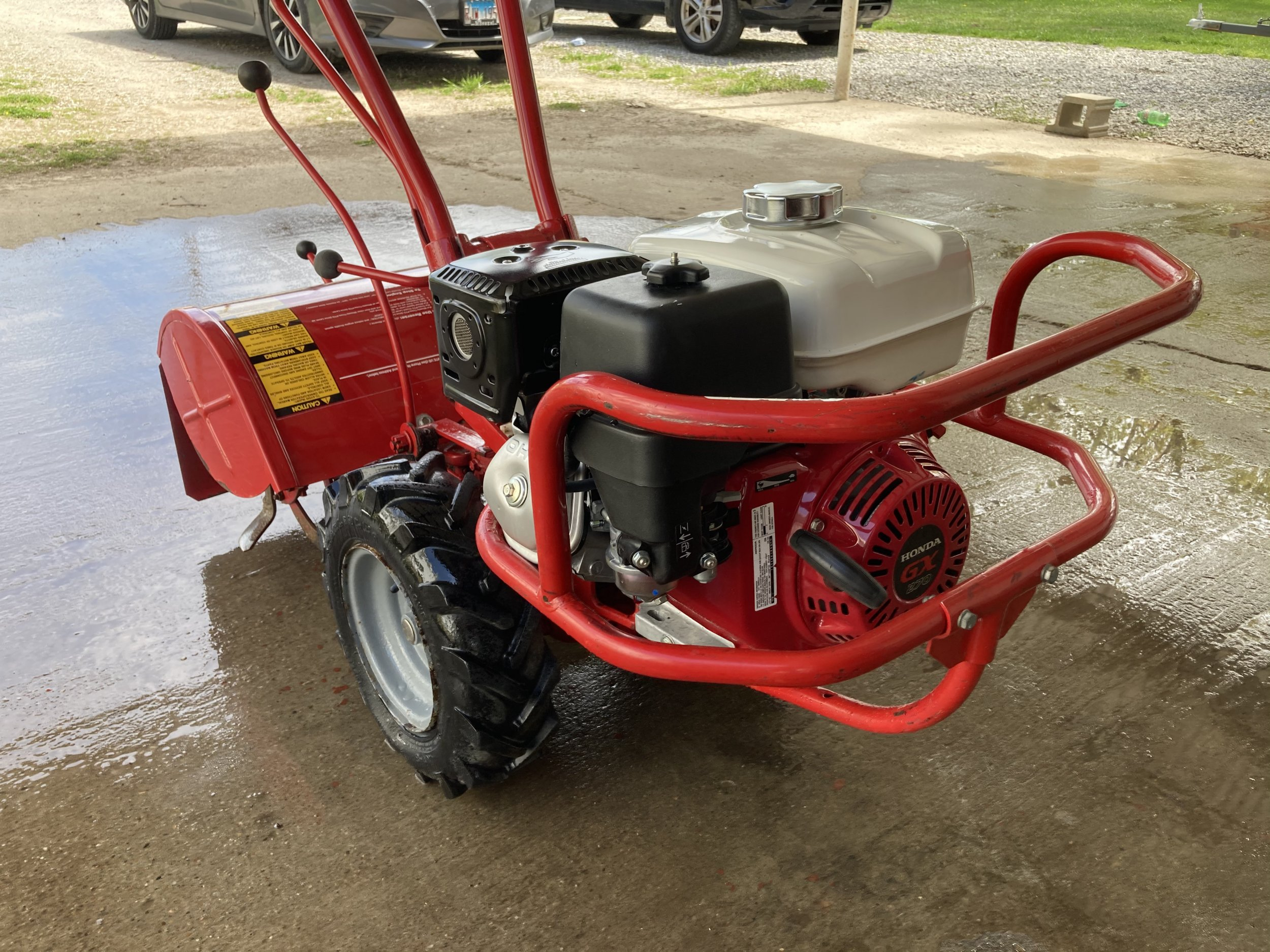

Well guys I solved my problem today. Having no luck finding recoil parts for my M8T Kohler I repowerd it today! Honda GX270! So smooth and quiet. Works perfect. It’s good for another 29 years!
