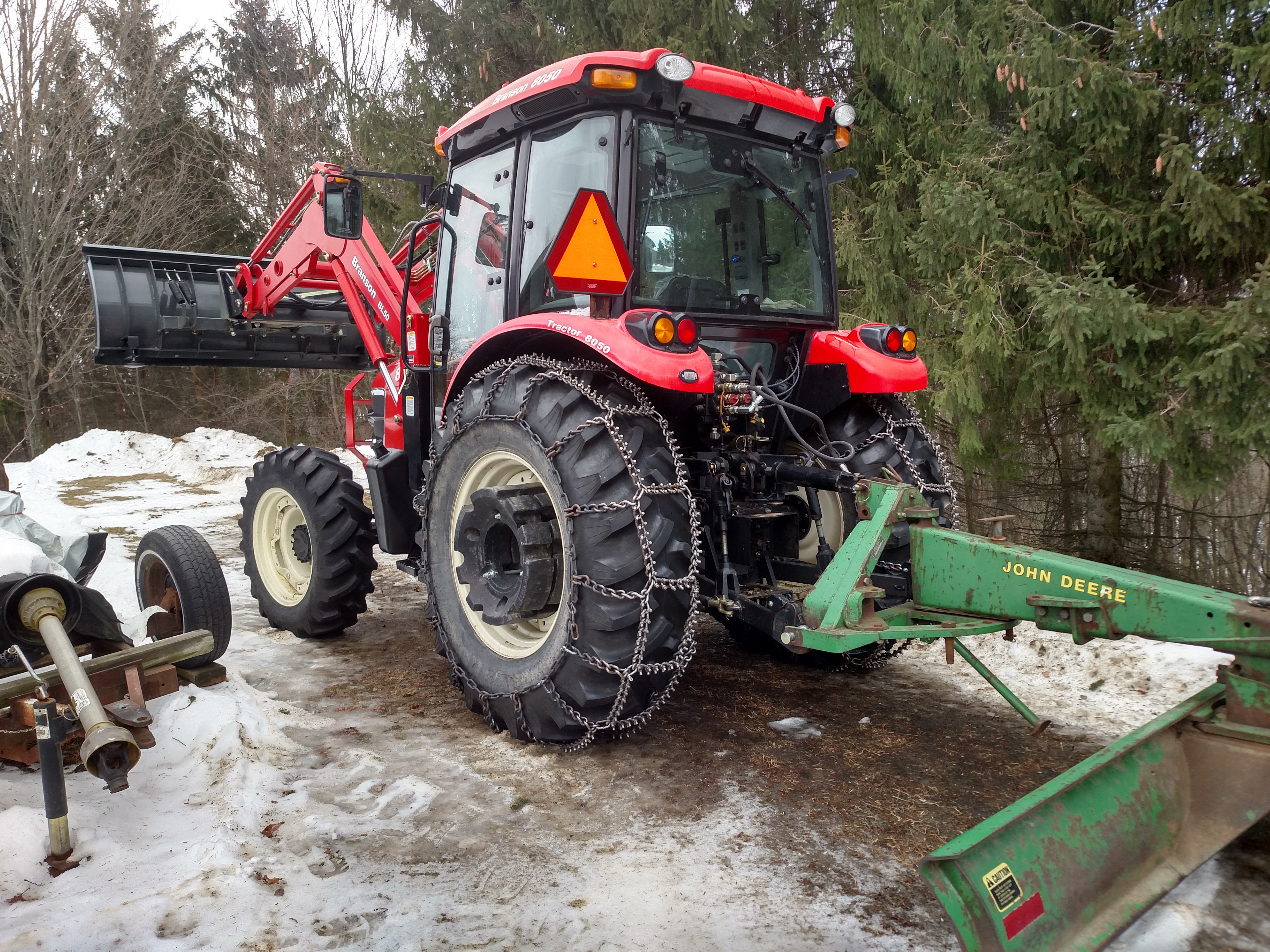

I'm sure your studs help, but I really doubt they come even close to pulling like my chains do;
   / Kold Kutter screw in studs for R4 tires
#13
Just came in from 5 hours of plowing. Just started raining so I got done just in time.
I like those chains! Are they very bouncy on the back?
   / Kold Kutter screw in studs for R4 tires #14
No they have an excellent ride, doesn't matter if it is slow going or if I get on the road at 15-18 mph they ride good,
and the traction is unbelievably good on frozen ground it is better then rubber on gravel in the summer,
on hard pack snow it will bog the tractor down as it's almost as good as summer traction.
They are the Aguiline Talons on the rears of the 574, OFA has very similar ones as does TRYGG.
I think the 8050 has TRYGG's it has been several years since I bought them.
I know the fronts for the 8050 are OFA's and they are almost too much, but I seldom use them

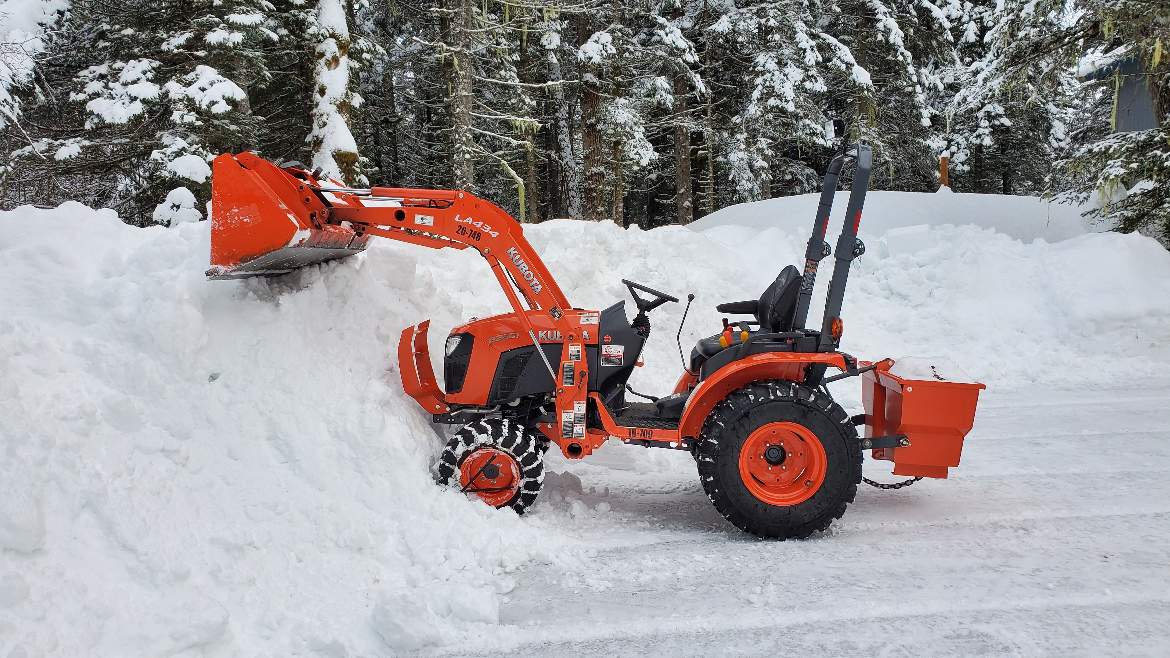

The snow is piling up a bit. The blade can actually push it higher than the bucket.
