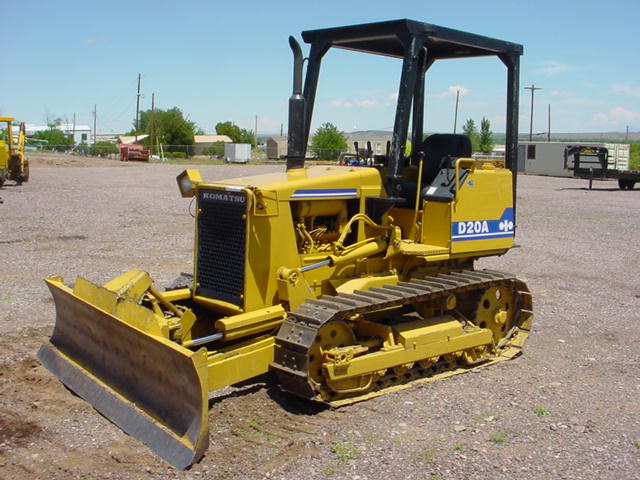

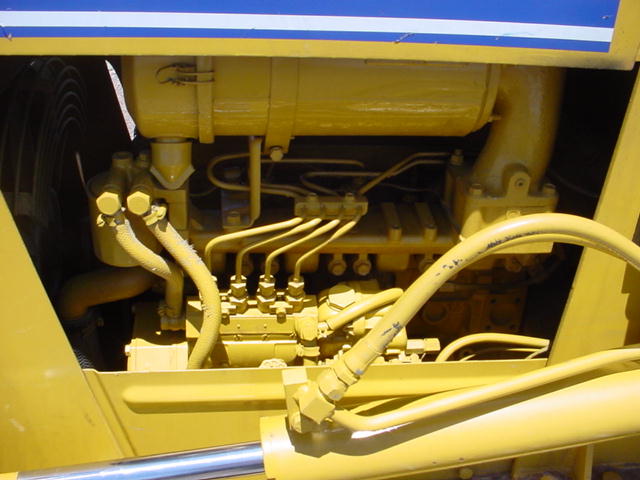

I am looking to purchase a used Dozer for road construction on my property. The road will be diagonally cross cut up into the side of a hill that has Lots of rocks & loose dirt. I have looked as several dozer's over the years, mostly Komatsu's D20's & D30's none of which were in very good condition. Well today I visited my favorite used Equipment lot and saw this Komatsu D20A-6 S/N 68449. Of all the Dozer's I have looked at, this one seems to be in the best condition. Price is 12,500. I was hoping to get your opinions of what you think of it's condition and if the price is right. I am not going to rent as I want a dozer to do the road project myself and at my leisure. I may sell it when done or just keep it for future clearing, leveling, & maintenance projects. I do not know all the Dozer terminology so please don't laugh at me to hard.
Here is what I know is in need of some work:
Visual:
The hour meter says 1477, no telling how many times the hour meter has been replaced over the years. I know it's a fairly new hour meter as it's not faded like the Oil pressure gage.

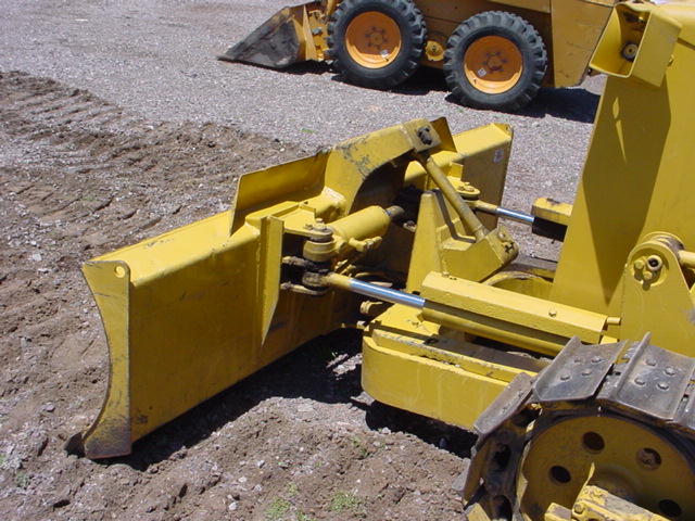

Six Way Blade, works all six ways with little to no slop in the joints. Cutting edge appears in good condition.

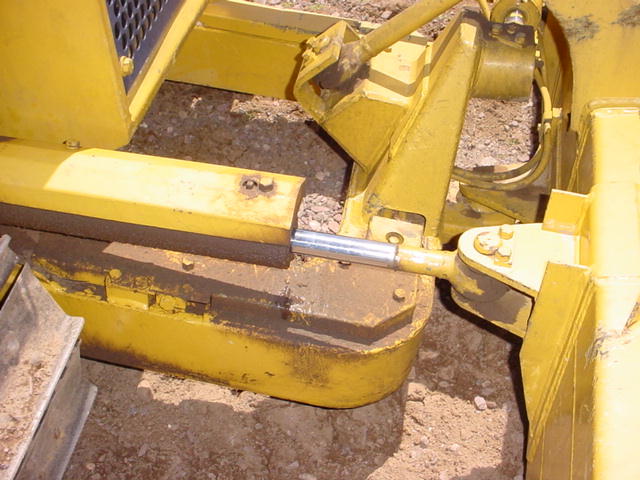

Two of the left hydraulic cylinders rods for the blade are pitted, so there are some small hydraulic leaks. The cylinder rods & seals will eventually need to be replaced. Cost? for parts. I can do most, if not all work needed.
The right side cylinders are excellent.

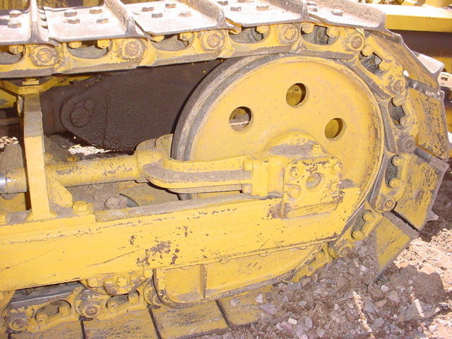

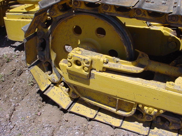

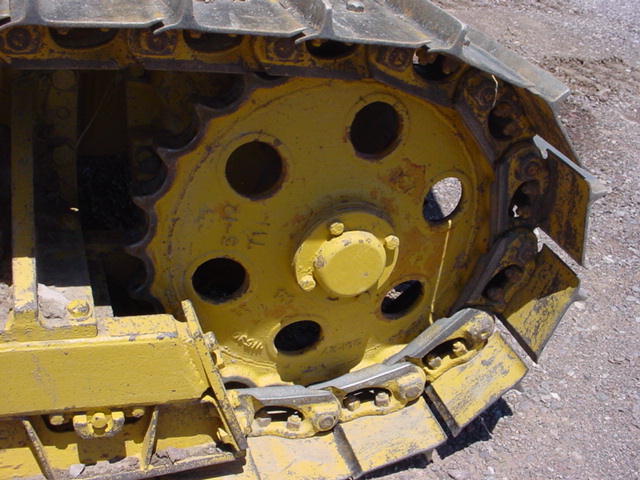

Tracks are nice and tight and seem to be in good condition.
I test drove it:
Engine starts with just a few cranks, it runs smooth, no white or black smoke, Clutch seems fine, breaks work. Turns Left no Problem.
Right turns are another story, when pulling back on the steering lever ALL THE WAY most of the time nothing happens, if you wiggle the lever a little - then it turns to the right no problem. There are several linkages that move and may just be out of adjustment? Sometimes it turns to the right sometimes not, when it does turn, the right track is held tight so I don't think the steering break / clutch needs replacement? not sure.
Anyway here are some pictures for all you experts to take a look at and let me know what you think of it's condition and if the price seems in line with it's age and condition.
Thank you for your input -
Larry

/ Komatsu D20A-6 ? #2
I have looked at a lot of crawlers over the years, but lacked the courage to buy one. It looks as if it has had reasonable to good care, and no signs of visible abuse or leaks? The sprockets maybe an issue however; the teeth on them look pointed and worn, and you may want to check on the replacement costs? It is also my understanding if the sprockets are at the end of their life cycle; so are the pins and bushings involving the tracks? The tracks show no sign of sagging? I would spend the money and pay a "crawler guru" to check it out for piece of mind after the purchase; it will be money well spent. They can hide a lot of their deficiencies that our pricey! Have that both turning clutches checked also. If one is going bad, the other may soon be a problem also.
/ Komatsu D20A-6 ? #3
Hi Larry,

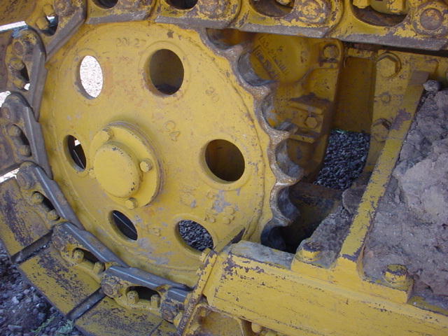

It looks like a recent paint job. That always scares me because I worry that they are hiding something. Same thing with the hour meter.
The sprocket looks really good. No points and it even looks flat at the end. I don't know what machmeter sees that I'm missing, but you're good to go there. The rails look like you have plenty of wear left on them too.
The bushings are your biggest concern with the tracks. You have to feel those with your hand. Are they round, or wore out on the sides? Have they been turned and is there a good side and a bad side?
That can be expensive if you need to replace them. Having them turned is a few grand, replacing them can be twice that.
One test to see how the clutches and final drives are is to bury the blade and keep pushing. If you can spin both tracks evenly, that's a good sign. If one track spins and the other doesn't, or they spin at a diferent speed, that's bad.

I have a 40 horse JD dozer for several years now. Eddies points are right on. The Komatsu may be grey market but parts are available anyway, might take a little looking.
Taking out trees w/a small dozer is a hassle. A backhoe of some sort is much faster. Although a BH on a hill has exciting moments as well BTDT.
The steering clutch may be an adjustment - since it sometimes works. dry/wet/steer clutches? Cylinder is a simple fix just takes some work, hydraulic shop can manufacture a new ram if necessary.

Eddie: Thanx for correcting me; I thought the points on the sprocket were completely worn down and just the "nubs" left, making the sprockets ratchet under heavy loads? I know you have a lot of hours and experience, and your "da' man" with things to look for, and good advice also.

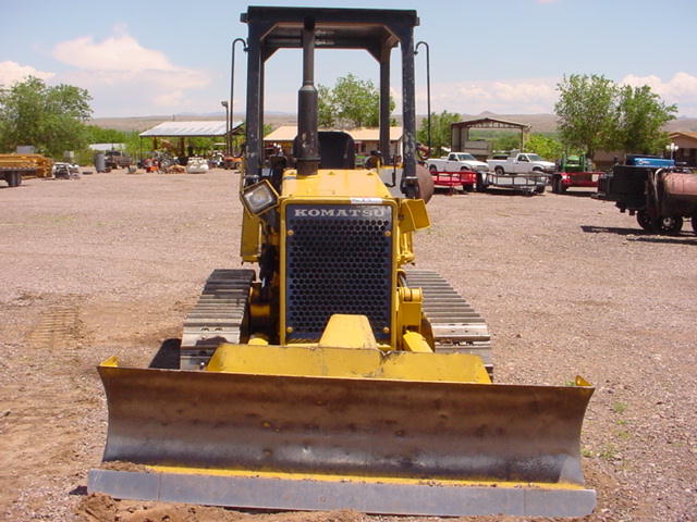

Looks like a decent machine. Only thing I noticed that you didn't mention, the light mounts on the front. One appears to be bent to the side. Nothing there that you couldn't fix. Do you plan on keeping unit after you finish your road project? If not, might be cheaper to hire it done (no fun in that), but if you are going to keep it, might offer $10,000 and see how it goes. Good luck.
