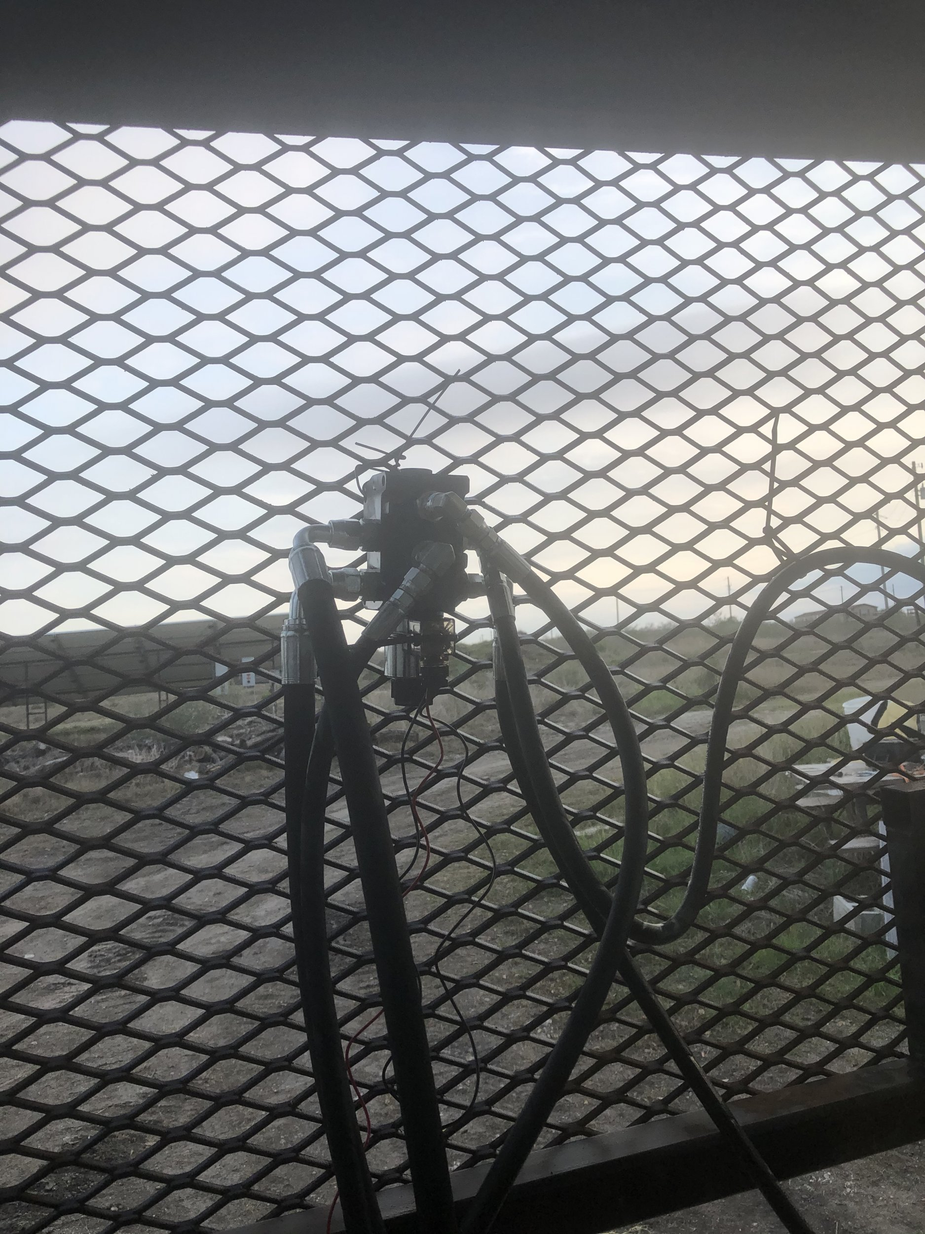

Can you provide pictures of what hydraulic lines you tapped into for your remote on the back of the dozer, I got a ripper all set up and for over a month I cant figure out how to make it work, I just dont understand or im using the wrong parts im at a total loss, if you can help I really appreiciated George krackerjack9@sbcglobal.net

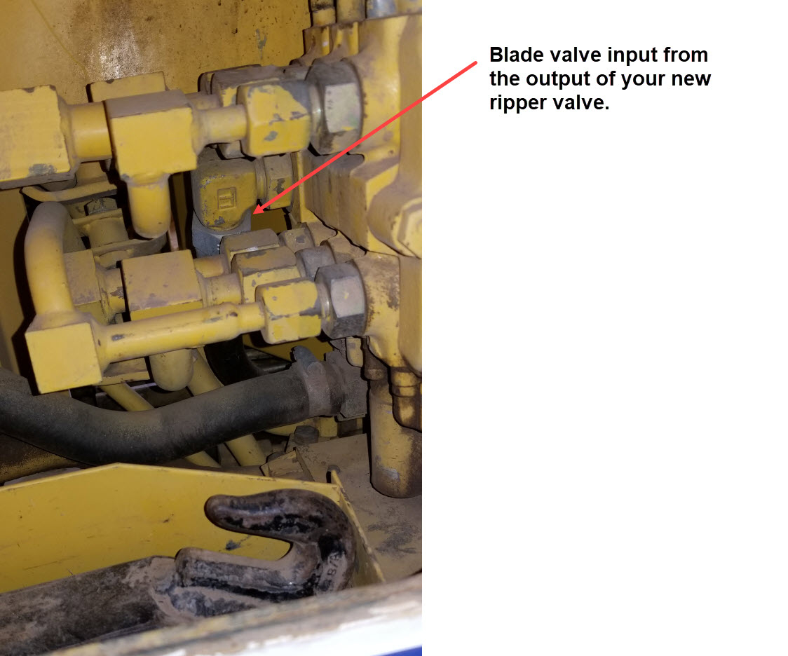

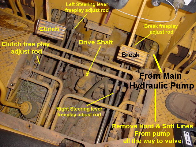

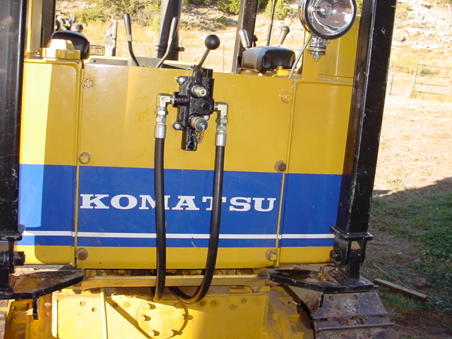

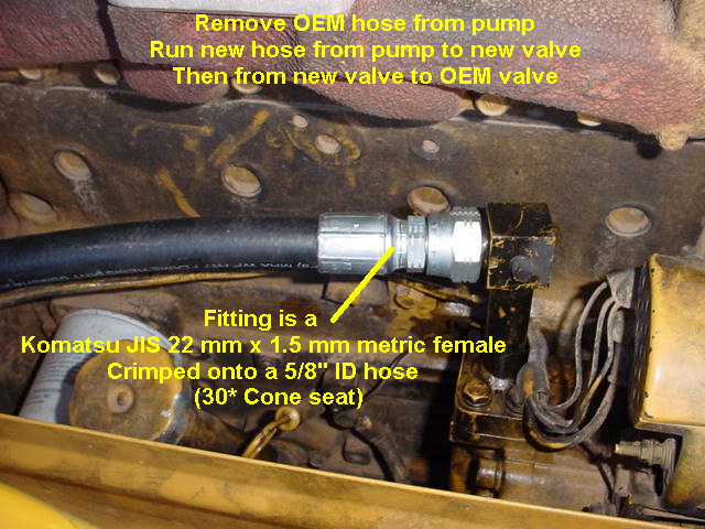

George,
Need to install a new double action valve between the pump and OEM blade valve. Remove the hose and hard line from the pump output all the way to the input of the blade valve. Install a new double action valve. Get a new hose made to connect from the pump output then into the input of the new valve. Then get a new hose made from the new valve back to the input of the blade valve. Basically all you need to do is put the new valve in series with the blade valve. In other words - Output of pump to new valve, output of new valve to input of blade valve. It's a simple in series hydraulic circuit. You will have to remove the floor plate, seat plate and seat riser plate to access to the blade valve hydraulic input fitting , and to remove the hard tube access to remove the valve input fitting really tight, but doable.
Why are there 6 hoses connected to what looks like an electric solenoid operated valve? normally 4 hoses, in, out and the two cylinder ports.
BTW the ripper construction looks really great. Nice work! Is it all home made? if not please share the source for the parts you used.

the 6 lines, are one in and out for up and down for each side so thats 4 then other two are to the ripper up and down thats 6
