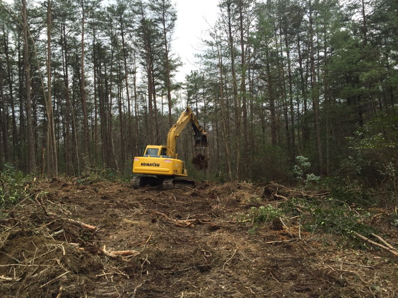

Knocking the dirt off the stump, smooth in over the hole with the excavator bucket and moving on to the next one. When we finish with the stumps I'll use the tractor and box blade to tear out surface roots and make things more uniform. image-811207747.jpg

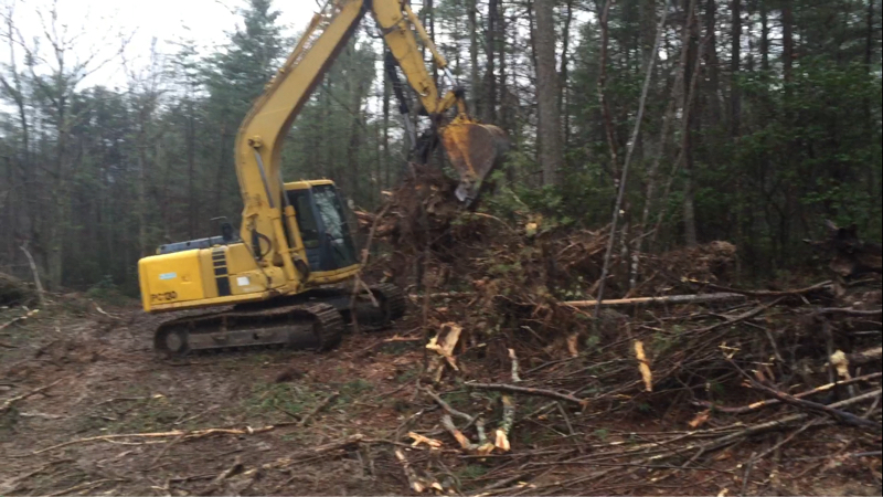

Man, that looks like fun!!!!! :thumbsup:
It is fun, but that is my 16 year old at the controls. I am grateful for the help, and was hoping he would pitch in, but he doesn't want to get out of the seat. Worked all day Saturday and most of Sunday....I had to bribe him out of the seat by reminding him that we just got a canoe for the pond.
